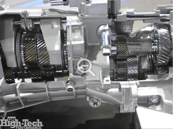

Tech can't blame Tremic! They can blame the massive gears and cluster required to handle the torque requirement! The M7 with a Z06 first gear can handle 650 ft-lbs of torque! Much more than the old Muncie etc! They are very big cluster gears that must change speeds when shifting. Changing that much rotational mass, fast is not an easy task. Suggest watching the video in post #8 for perspective.
Insides of an M7. The gears and gear clusters in an M7 are massive to handle the torque. Not like shifting a 2 Liter Honda!.
