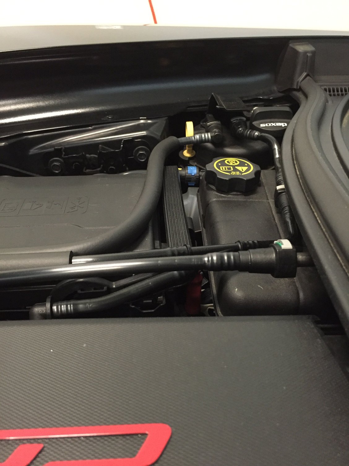

If there are open-hood photos, you should be able to spot the location of the dry sump and dipstick (yellow dipstick and "Dexos" oil cap near passenger-side firewall in engine bay). Non-Z51 cars don't have the dry sump oil system.

The Slotted rotors from the outside...
and as shown, with the hood open, the external oil reservoir for the dry sump.

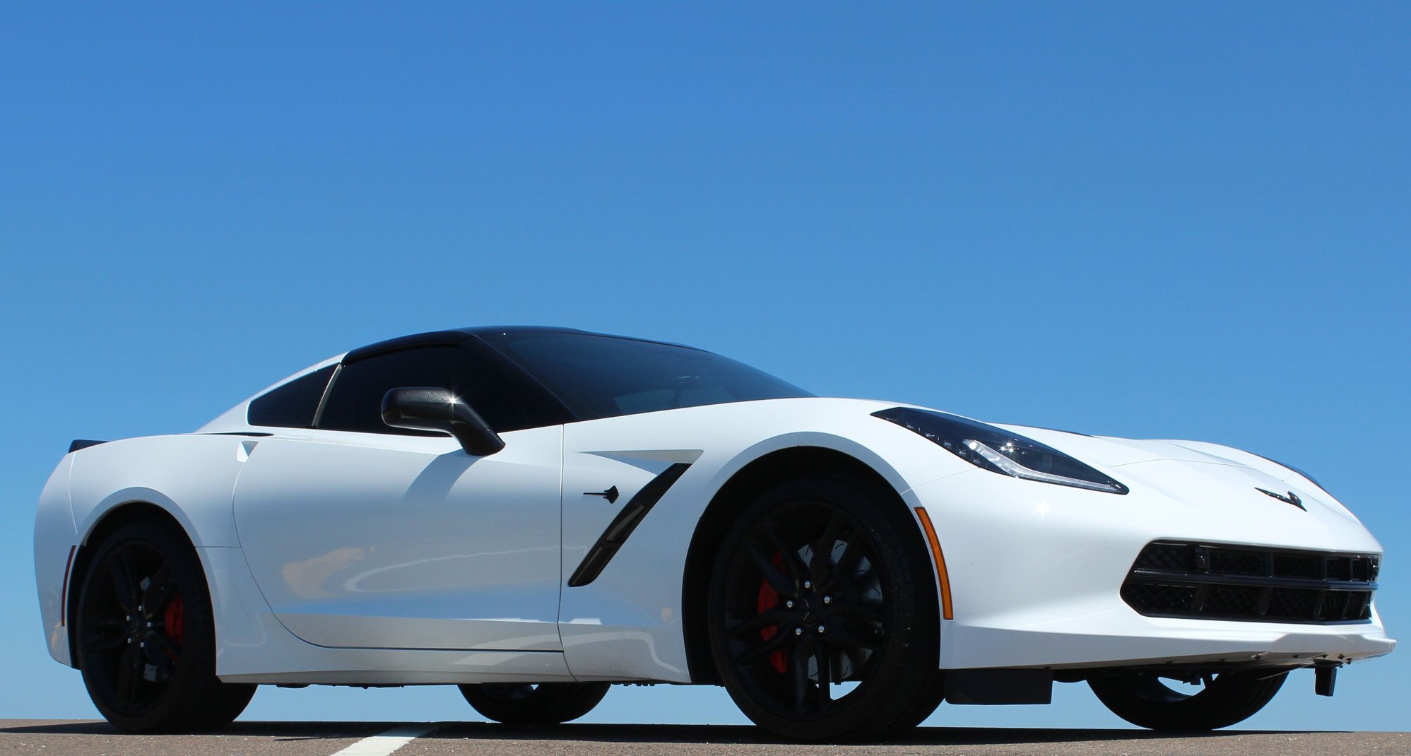

Although I'm not new to Corvettes, I am new to C7s, and I've been away from this forum since 2008 when I sold my C6 Z06. I just returned a couple of weeks ago when I picked up a CPO '14 Z51 2LT after selling a Jaguar F-Type.
Old Jun 17, 2016 | 04:04 PM
AdventurePoser's Avatar
AdventurePoser
Joined: Jan 2012
Posts: 1,332
Likes: 557
From: Newport OR
Originally Posted by Foosh
Z51 has a larger and different wheel design.
Beautiful car, Foosh. If I didn't buy the best color, white, this is the color I would have wanted.

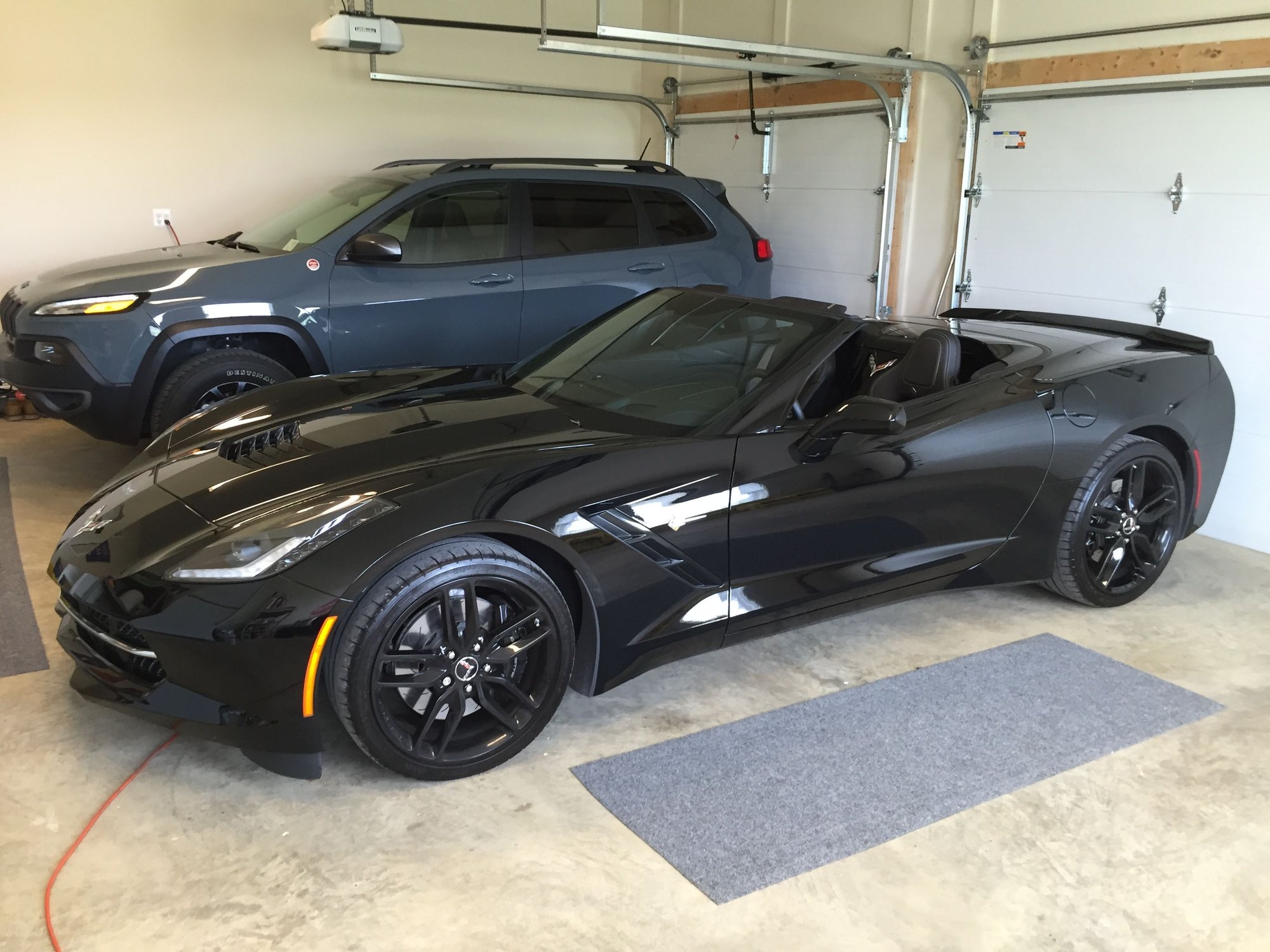

Here is one...
Check out front air dam
