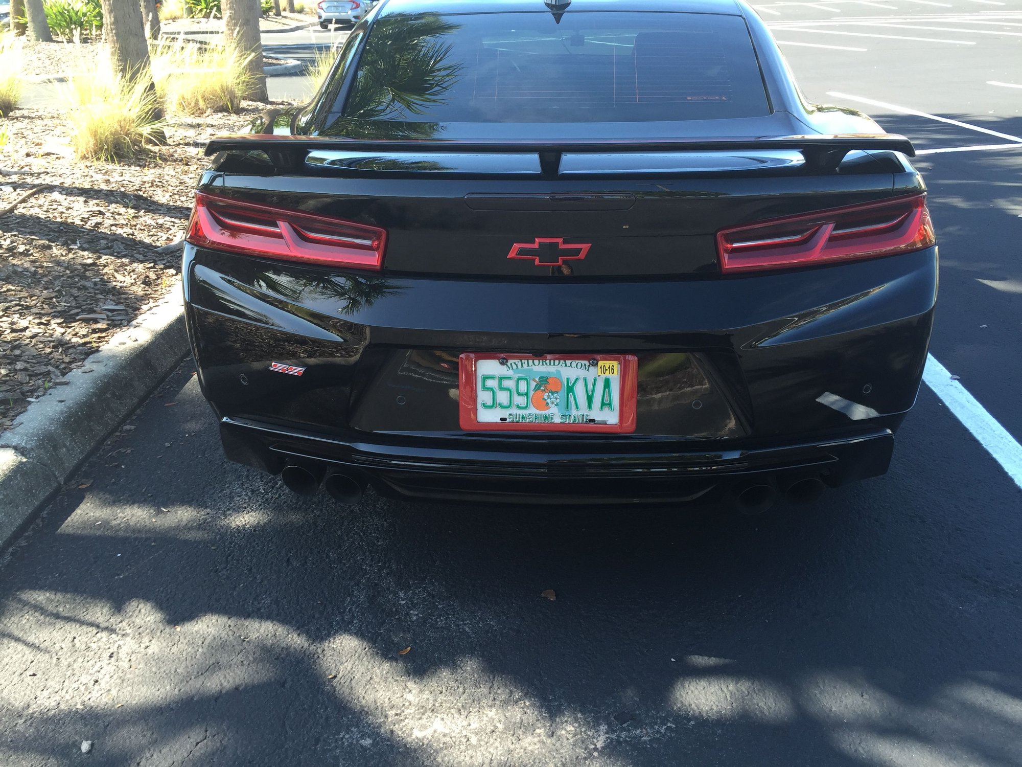

I have done searches and am aware of various vendors, Corsa etc, that offer black tips and exhaust upgrade systems. I am not interested in exhaust upgrades, I am fine with the NPP exhaust system I have; sound etc is great. I just want black tips.
Are there options for that only?
Has anyone painted theirs? Not keen on this but maybe. If you did, what did you use and how has it worked out? Longevity issues? Issues cleaning them?

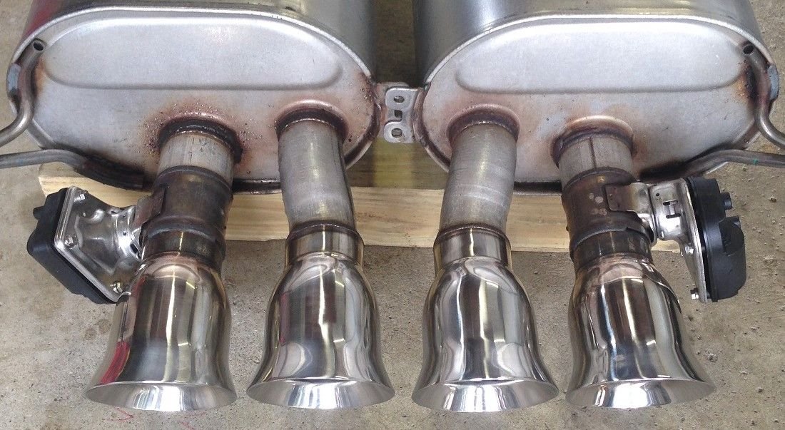

I thought I read somewhee you could not use the tips without the mufflers? Or did I misunderstand?
Also, if you can use just Corsa tips doesnt that require cutting and welding? I dont think the OEM exhaust tips are bolted or clamped on?
cut and weld are cut org tips off then clamp the others on they do come with clamps with them.

Corsa site says their tips will only fit their mufflers, not OEM mufflers.

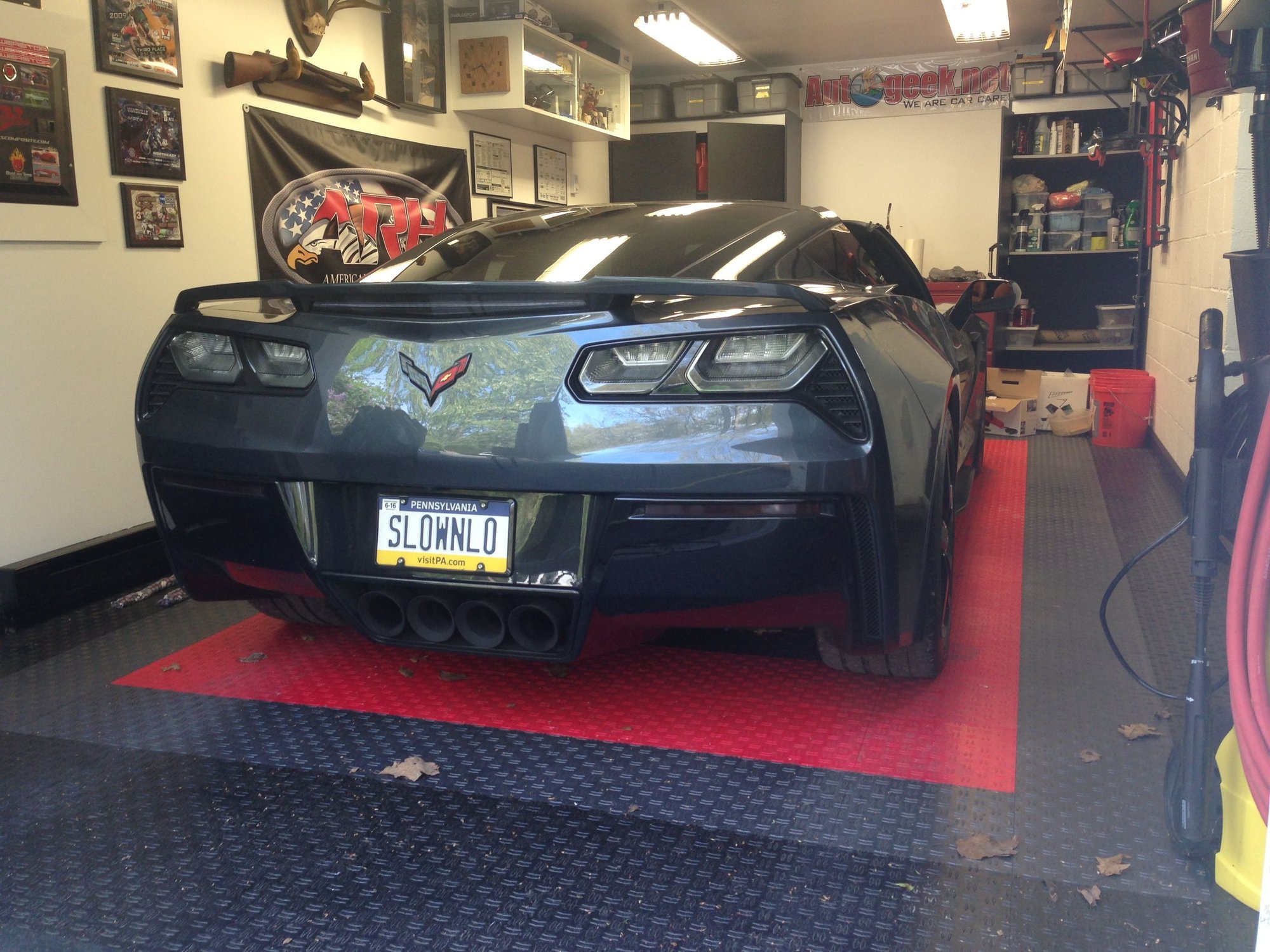

Painted mine
Havent washed them since and love it
I used vht high temp satin black
Wetsand with 1500 and primed with vht high temp primer and the 3 or 4 coats of vht high temp satin black

Did you remove the diffuser to do it? Difficult removal?

Removed the entire rear bumper
Painted tips
Dropped in the Z tails and reassembled
Worth every bit of effort
But was a bit of a pita
