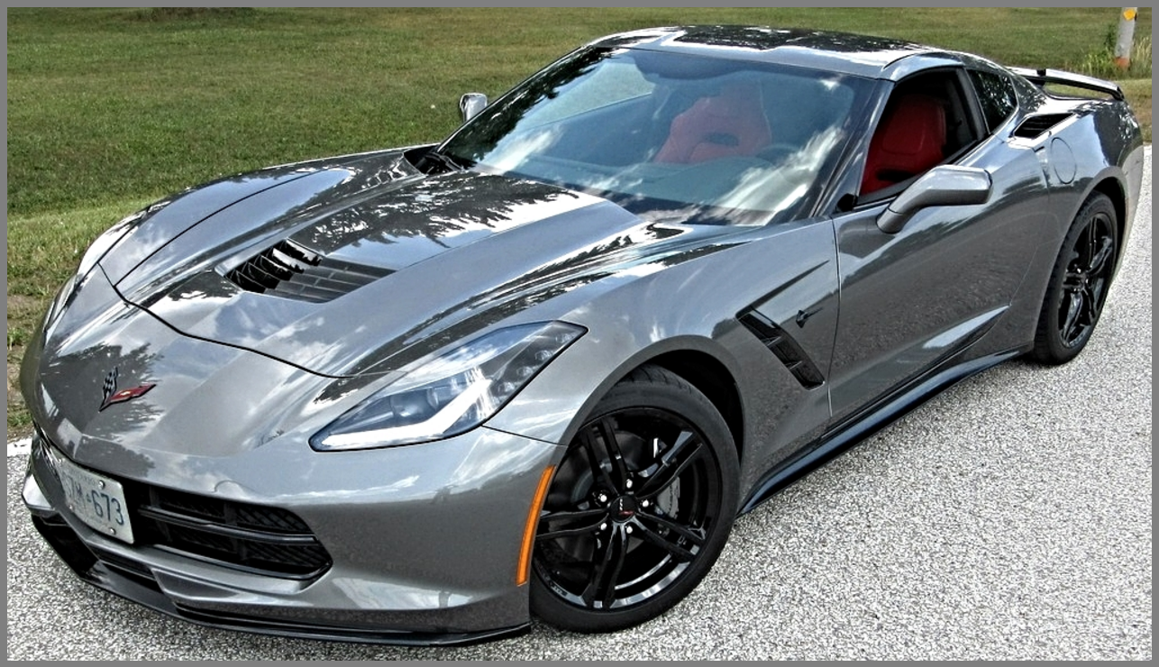

I have been looking at buying a new corvette but after looking at many of them I'm disappointed with the quality of the paint/fiberglass work. It especially evident between the windshield pillar and front wheel opening. I have none of this on my C6. Opinions?

They do look nice from 10 feet. Too much print through up close, especially on an eighty thousand dollar machine. Is the body made with different materials as compared to the c6?

Some are worse than others. Flaws are less noticeable on lighter colors. All car companies have their issues. Should be improved when the new paint facility opens. There are numerous threads on this topic. Search and enjoy.

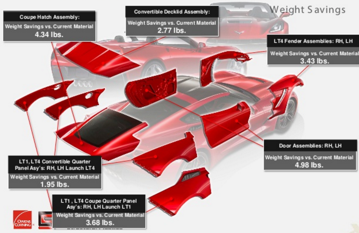

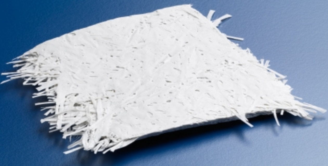

Not sure what you mean by "to much print?" Printing is what can happen with fiberglass over time as the resin shrinks and you can see the fiberglass weave or chopped fibers. Vette's have not been made from fiberglass for many years!
The Vette body is made from SMC, Sheet Molding Compound (or Composite, both terms are used.) There is no weave to print!
In fact there are differences: In 2013 the Specific Gravity of the SMC was 1.9 (almost twice that of water.) In 2014 it was changed to reduce weight to a SG of 1.6. In 2016 there was a further reduction and the specific gravity is down to 1.2. That was achieved by adding hollow microglass beads (the next step will probably achieve under 1 and the car will float! ) It was reported to provide an even "better surface finish." Have not heard any complaints about the material being an issue in 2016s.
However there have been issues with the C6 and C7 (and prior Vettes) regarding "Orange Peel" in the paint. It does vary and color makes a difference. That is why GM is spending $440,000,000 on a new paint facility in Bowling Green!

Originally Posted by JerryU
C7's aren't made with fiberglass > made from SMC
SMC > Sheet Molding Compound = glass fiber reinforced plastic used in compression molding.
Pattern is visible if ya look real close @ doors/fenders

Originally Posted by C7Jake
You sure Jerry?
Pattern is visible if ya look real close @ doors/fenders = Fiber Reinforced Plastic
Didn't say it did not contain some fiberglass, 50% as I recall, but unlike fiberglass cloth or chopped glass spayed into a gel coated mold it does not "print." Except apparently in gray cars where it's very cold, eh?!
Here's some info:
"General Motors Lightens the Corvette with Continental Structural Plastics’ TCA® Ultra Lite™
Published: July 21, 2015 2:00 p.m.
Space-age material offers significant weight- and cost-savings over aluminum
AUBURN HILLS, Mich., Jul 21, 2015 (BUSINESS WIRE) -- Continental Structural Plastics (CSP), the global leader in lightweight composite solutions, announced today that its TCA Ultra Lite material is now in production on the 2016 Chevrolet Corvette. The use of TCA Ultra Lite, a Class A body panel material, results in a 20 lb (9 kg) weight savings on the Stingray Coupe model. This is the first production use of CSP’s Ultra Lite advanced composite.
“Through a joint continuous improvement effort, Chevrolet and CSP have significantly reduced the density of the Corvette body panels – from 1.9 specific gravity for the 2013 model year, to 1.6 specific gravity for the 2014 model year to 1.2 for the 2016 model year,” said Christopher Basela, Lead Engineer for Corvette Body Composites.
The mass savings afforded by TCA Ultra Lite is accomplished through the use of a CSP-patented technology that uses treated glass bubbles to replace some of the Calcium Carbonate filler, resulting in a lighter density material. On the C7, a total of 21 body panel assemblies, including doors, decklids, quarter panels and fenders, are molded from TCA Ultra Lite.
“In materials engineering, shaving a single pound per car is a significant accomplishment, so saving 20 pounds per car is monumental,” said Tadge Juechter, Corvette Chief Engineer. “This is a great example of how Chevrolet is continually looking for innovations that improve performance on Corvette, and could benefit possible future applications.”
When combined with CSP’s patented vacuum and bonding manufacturing processes, TCA Ultra Lite offers a premium Class A finish with paint and gloss qualities comparable to metals, including aluminum.”
Didn't say it didn't contain some fiberglass.
Vette's haven't been made of fiberglass for many years!
SMC = compressed fiberglass sheets
