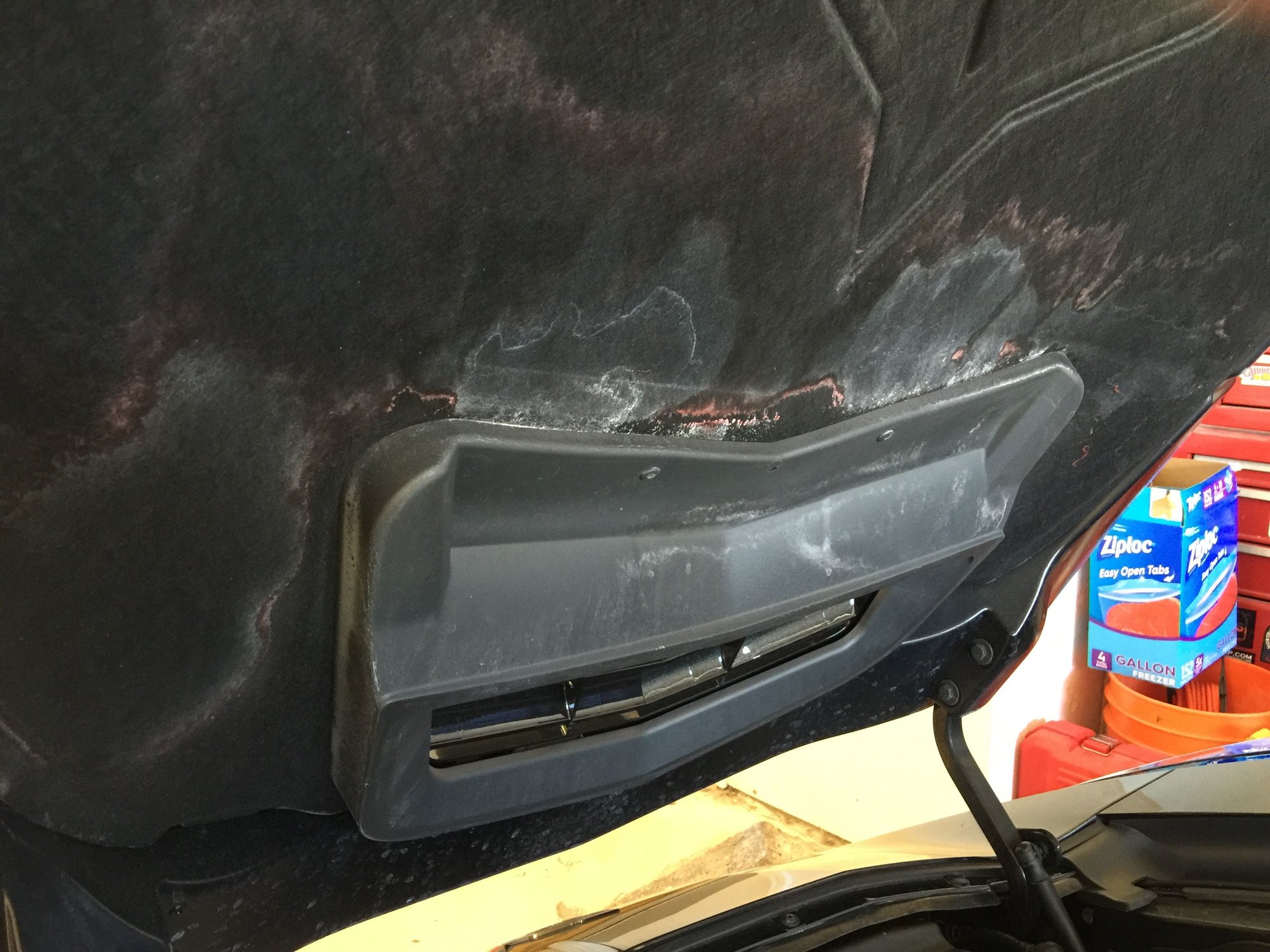

Is anyone aware of a PI* Bulletin documenting that you need to do cool down laps when you track your car, to keep the coolant from overflowing?
My car is in the shop for a coolant leak but they are unable to see any loss and the system maintains pressure. There is certainly coolant all over the engine compartment. I drag race my car not road track, so not sure a "cool down" lap is necessary. And I haven't been in 4 months.

Was this the first time it happened? I suspect that it was just overfilled and purged the overfill. If this was a one off, I wouldn't worry about it for now. Just make sure the system and levels are correct and keep an eye out. I've seen this on a few C7s. The situation did not repeat itself.

They ordered a new hood liner (I'll post a pic later)
Car is under a monitoring program now, similar to the oil consumption test. They put a dye in the coolant and I'll go back on a couple of weeks for a recheck and replacement of the hood liner.

Old Sep 3, 2016 | 03:41 PM

Dude. That's not a leak. That's a spray job or explosion.

Looks like car wash soap residue.
:O
I think you're right.
Yep. Went to the car wash and checked it immediately after. It's from the car wash. (No, I don't hand wash my car)
Anyone else experience this? Make me wonder how this is behaving in the rain?
Thats not from a car wash, mine did the same it antifreeze thats why its red. check lower right corner of radiator and bottom of the skid guard on right side
