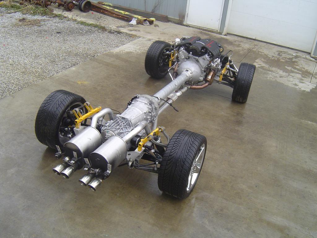

C7's have a Transaxle ... From what I understand the torque tube is actually consider part of the structure of the car with a drive shaft located in the center. A typical drive shaft in a rear wheel drive vehicles adds no structural integrity to the vehicle.
Not a C7 but a good pic ....

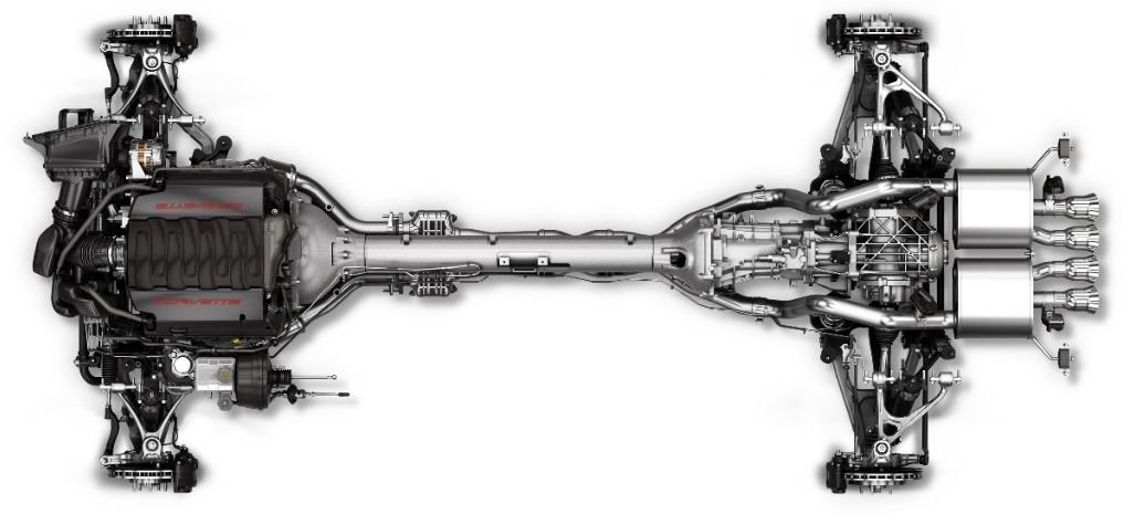

As shown in the kindly shared photo, the transmission connects directly to the differential.
This is the perfect explanation, and the picture is worth 1000 words. It is more than just a conventional driveshaft.

Old Sep 18, 2016 | 04:11 AM
