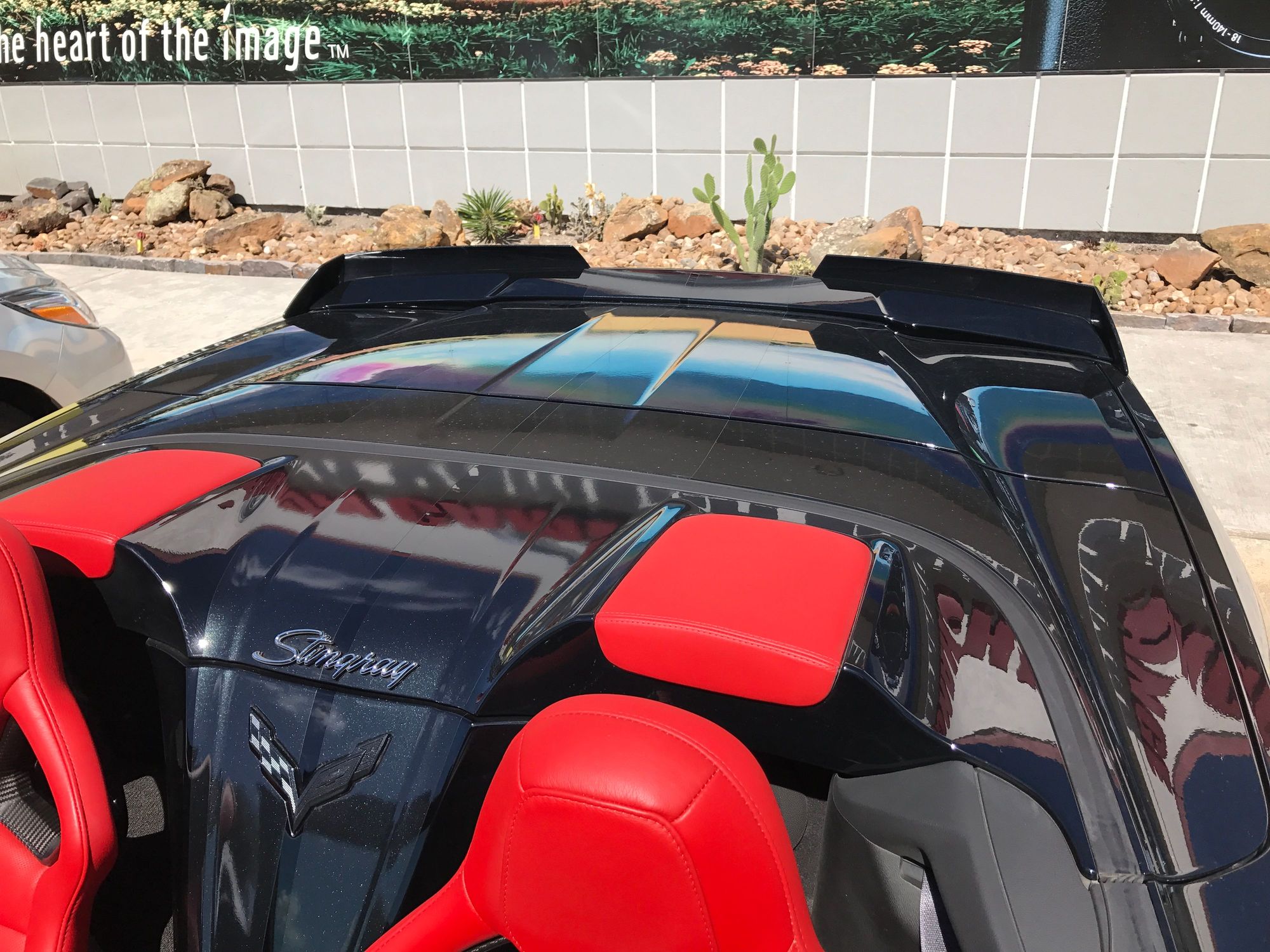

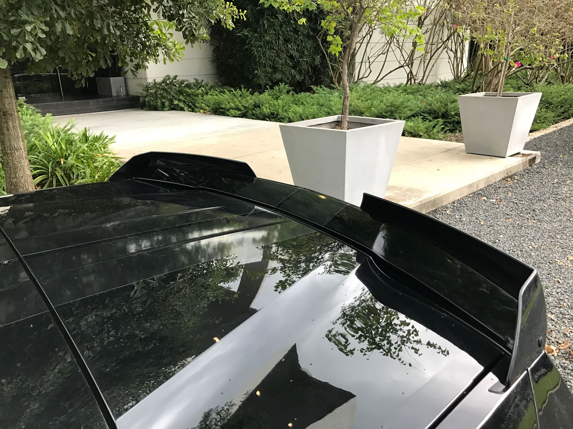

I just purchased this Corvette for my wife, and after looking at photos, I was wondering if I could add version/stage 2 or even 3 to my current spoiler? Would I have to drill holes? Sorry for the newbie question, I can't say for sure which spoiler I have, and I need veteran opinions.

That is called the Z51 style spoiler. It was an option on the base stingray and standard on the Z51. The stage 2/3 is the spoiler for the Z06. This rear spoiler will not fit a stingray because the rear bumper is 3 inches wider on a Z06.

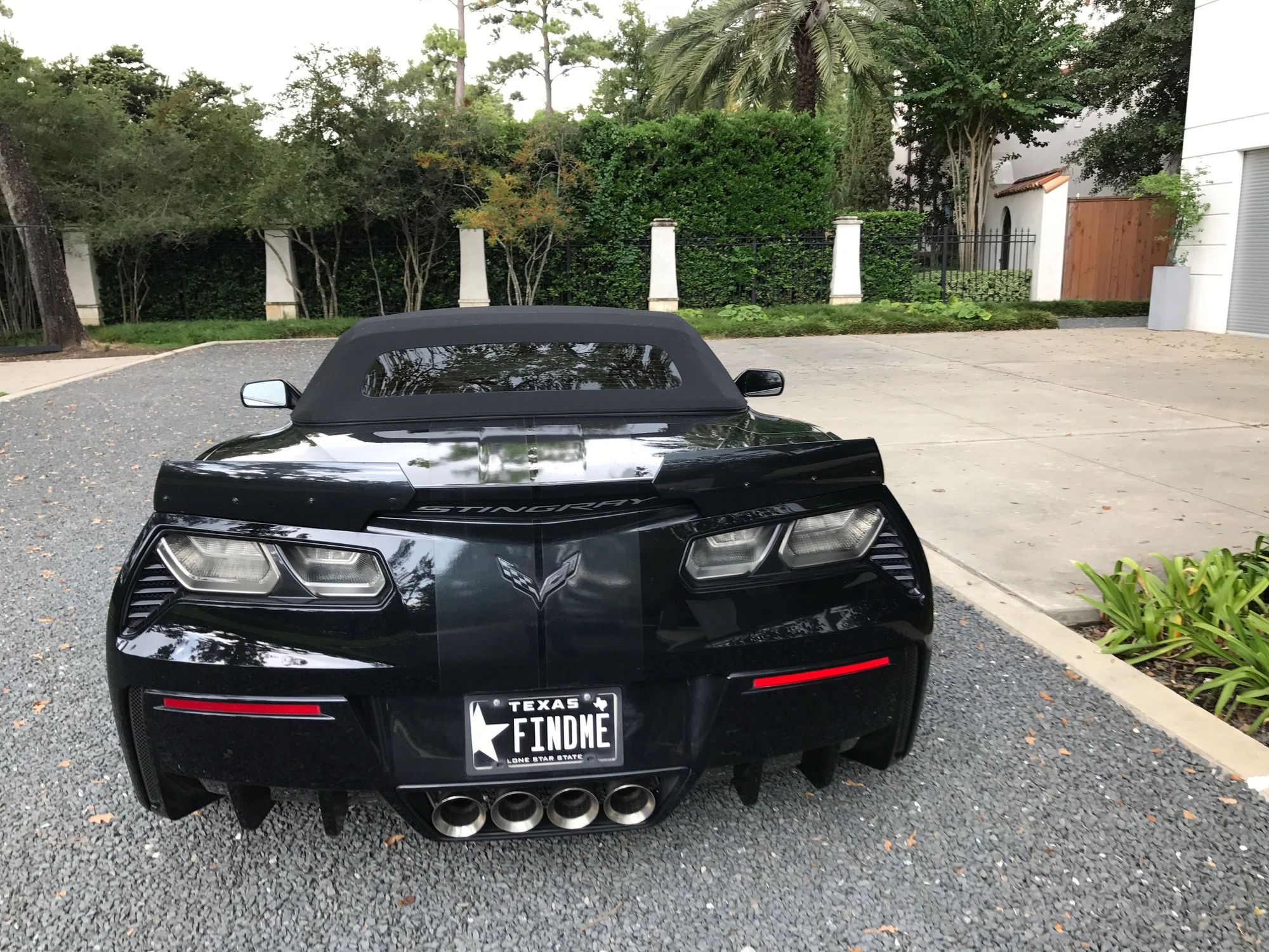

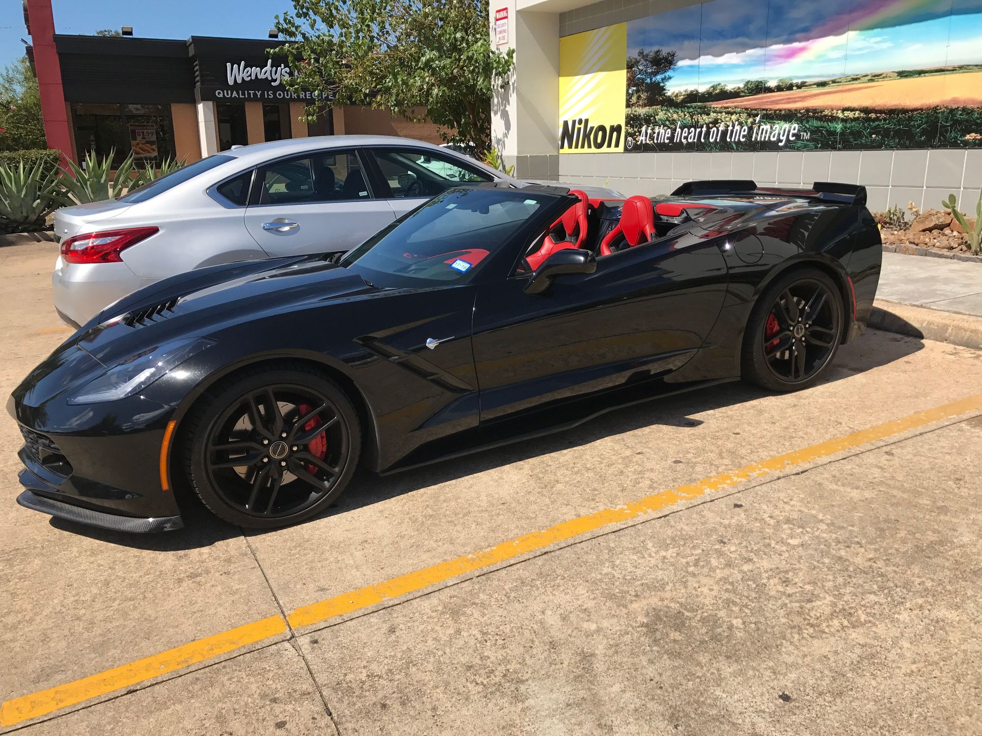

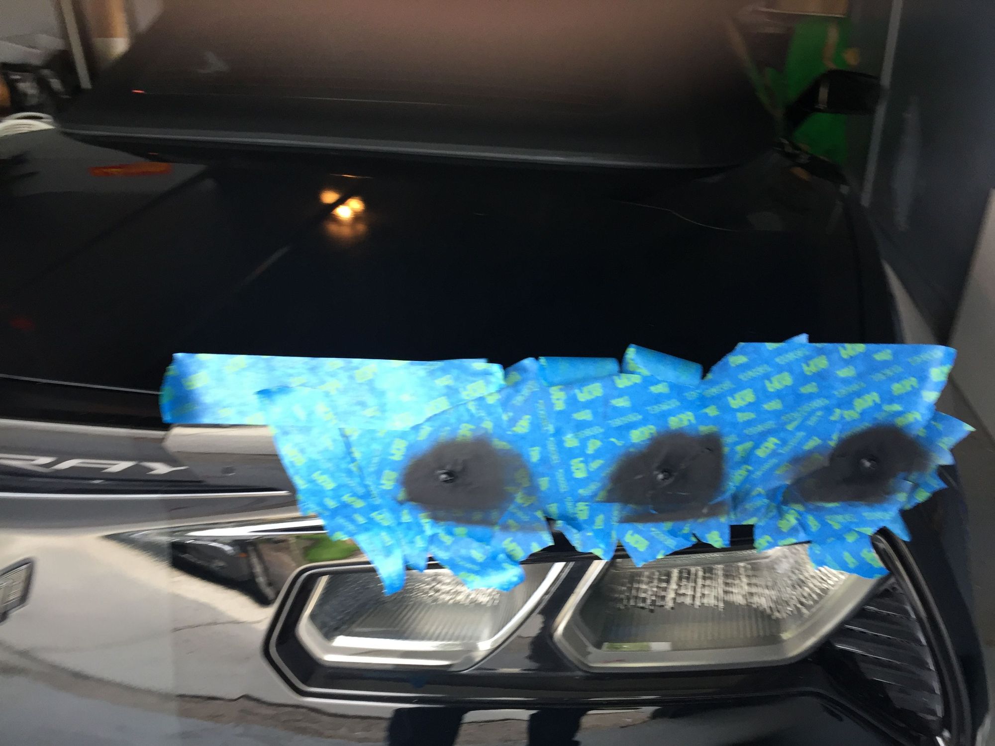

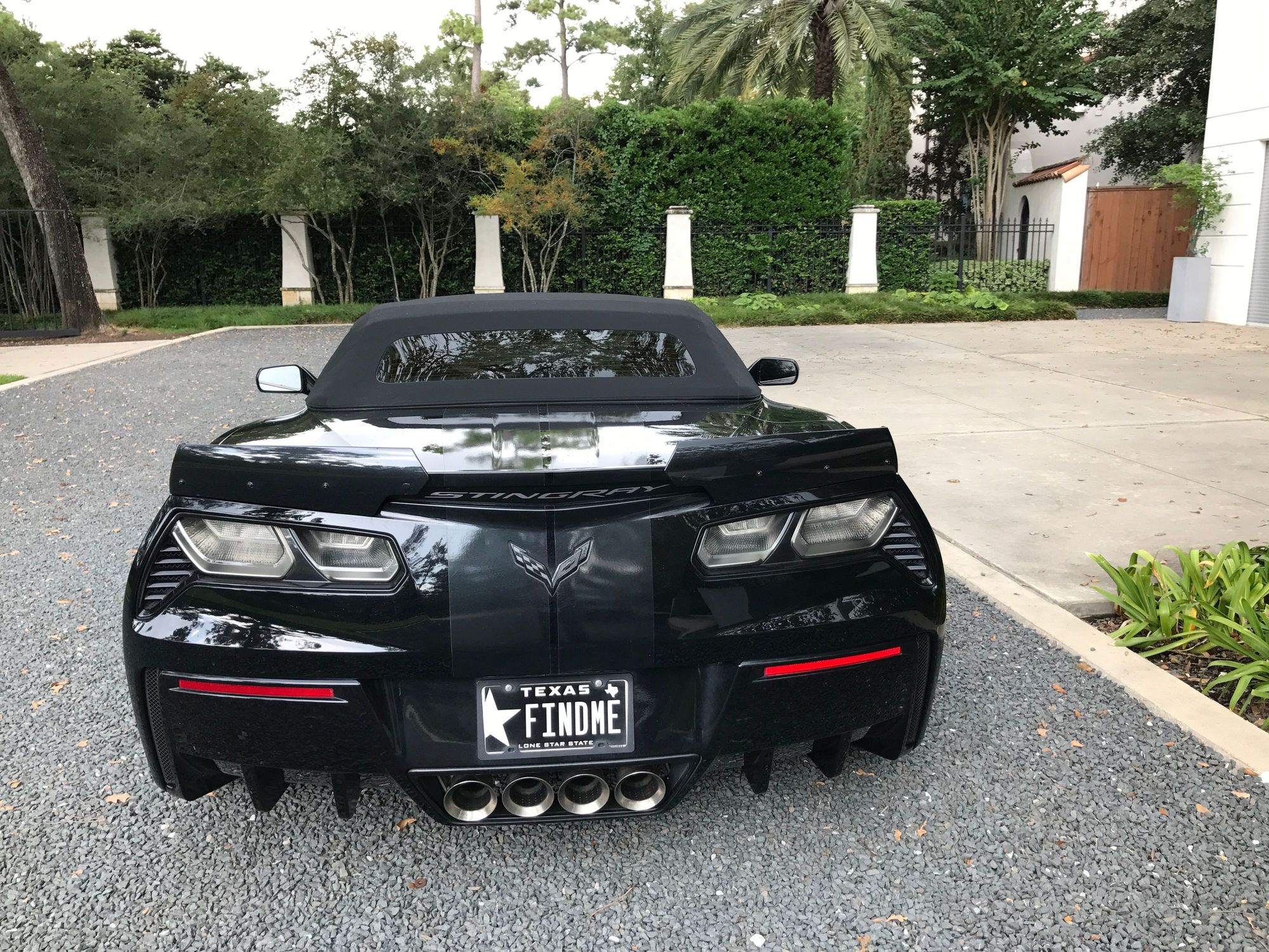

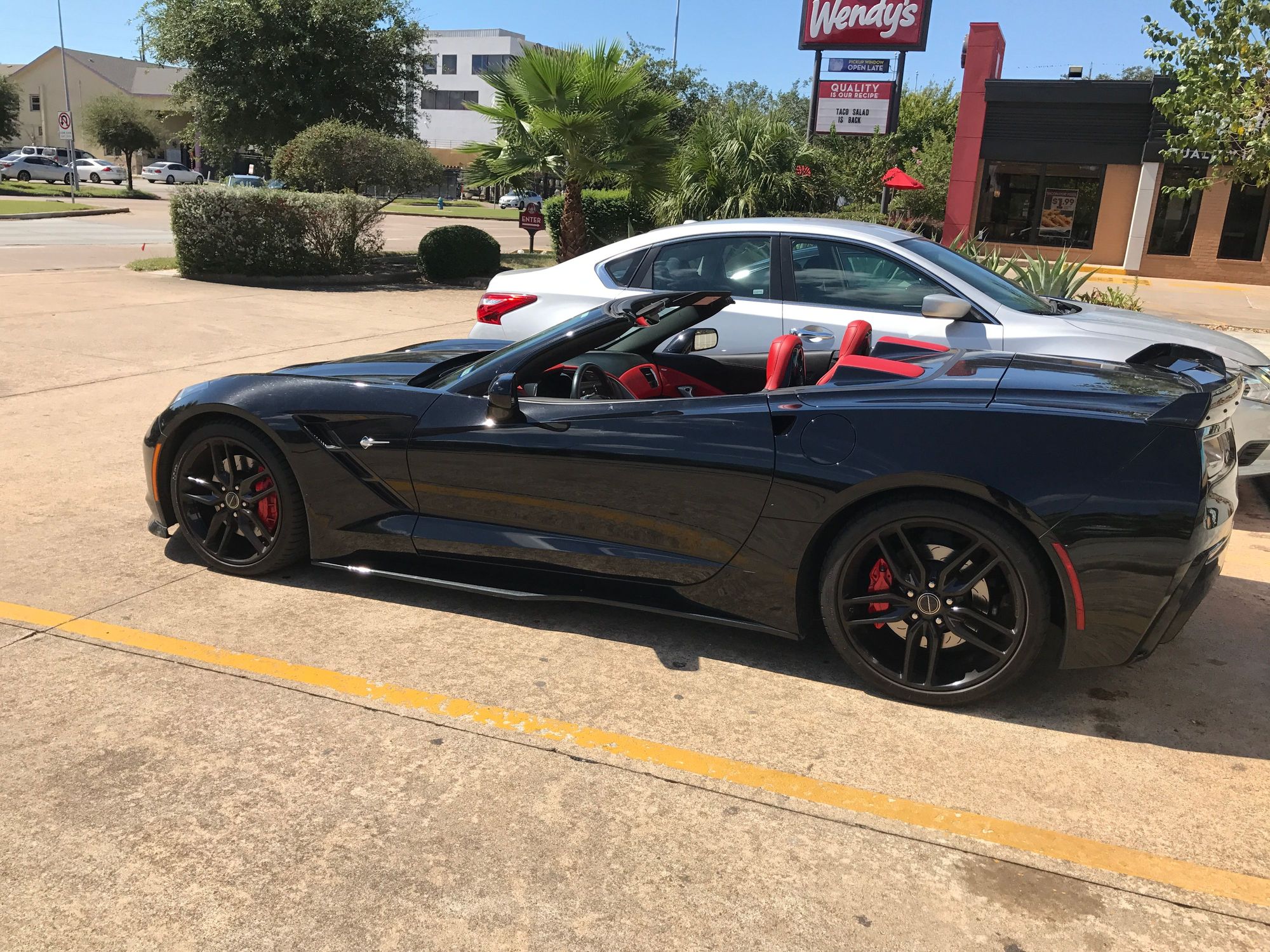

Default Stage 2 on z51

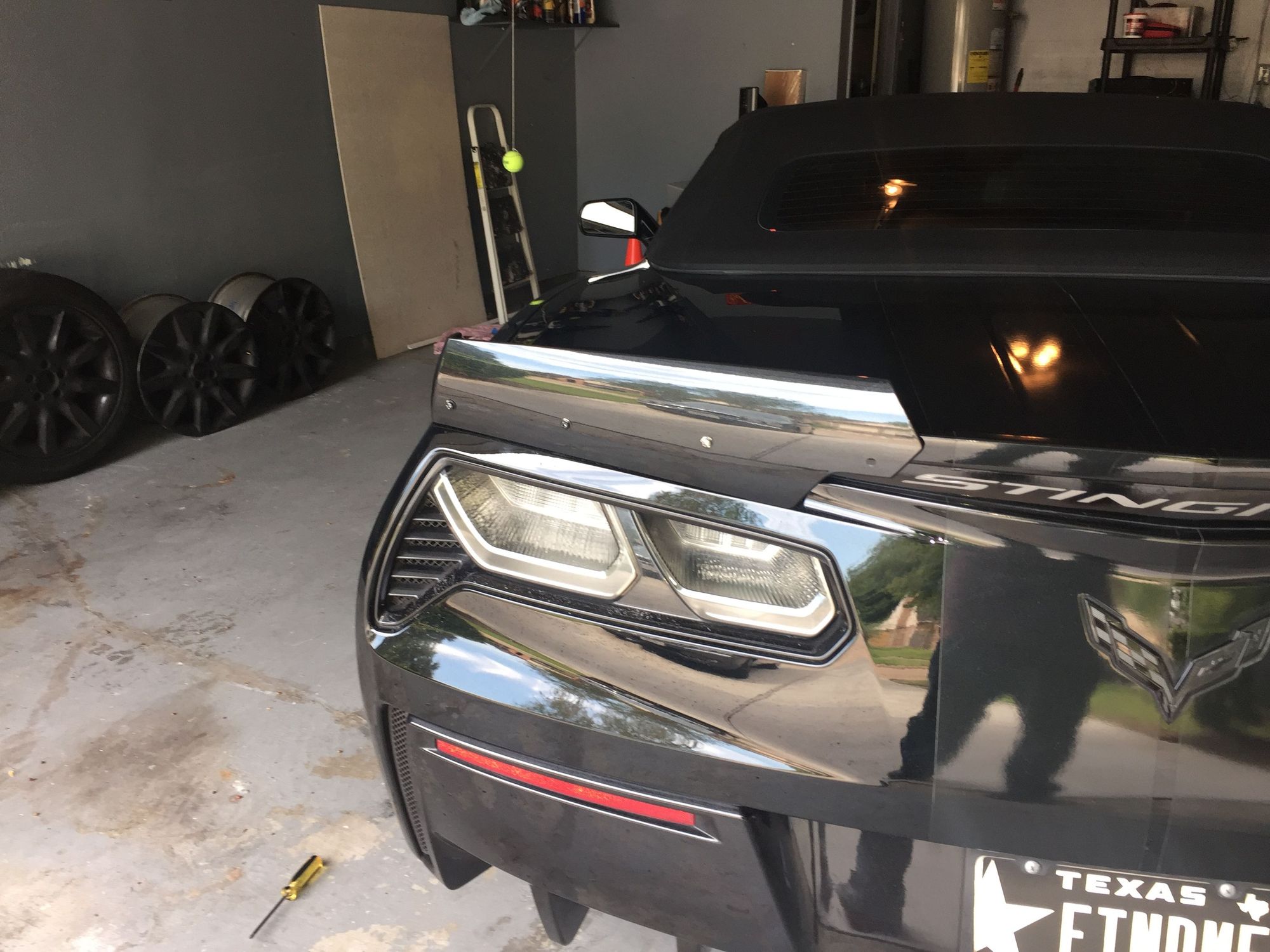

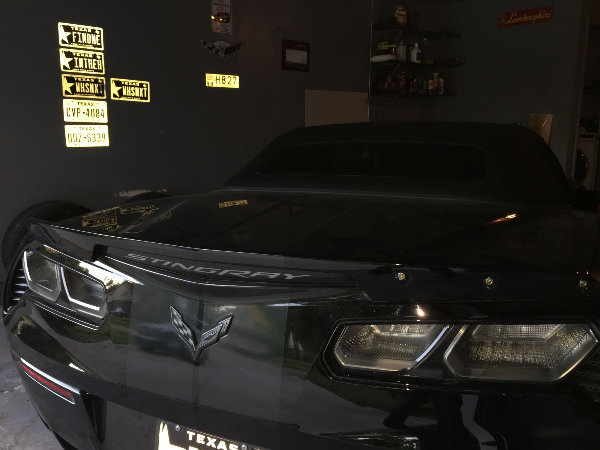

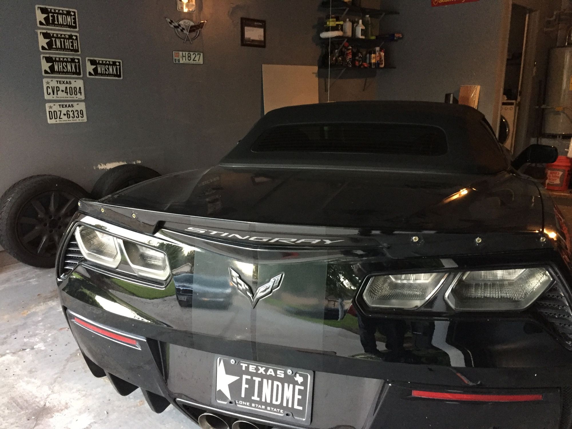

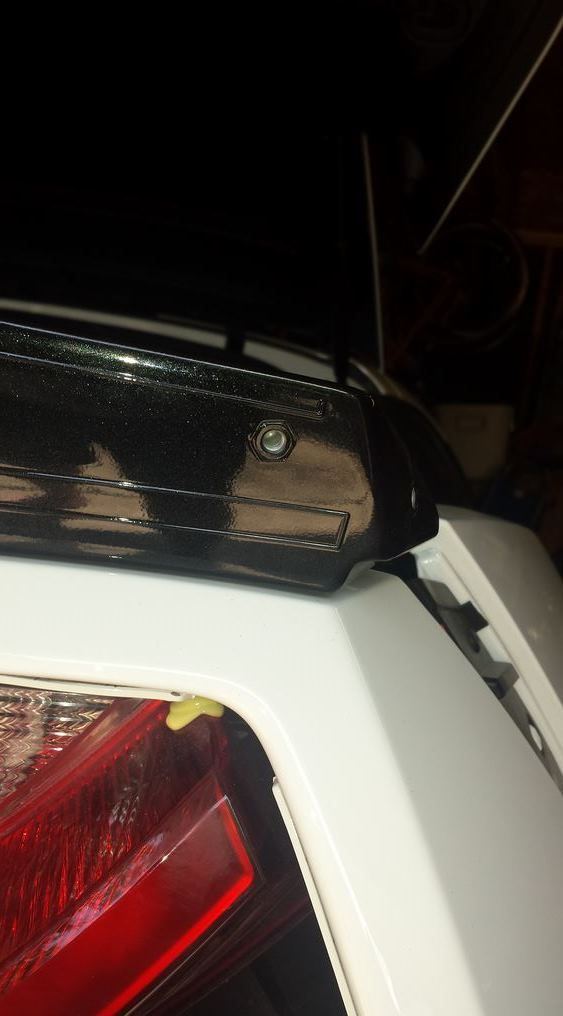

I purchased the STAGE 2" REAR SPOILER EXTENSION 153.42.part number GM#23256573 and a screw rivet gun from amazon. I lined the end caps up marked the spots to drill the holes for the screwed rivets.Then applied the rivets with the rivet gun, next I bolted the wing extensions to the stock z51 spoiler. I did have to purchase longer Stainless steel screws from Home Depot painted them carbon flash to match spoiler extensions. See pics below
ion to my stock z51 sploiler.
