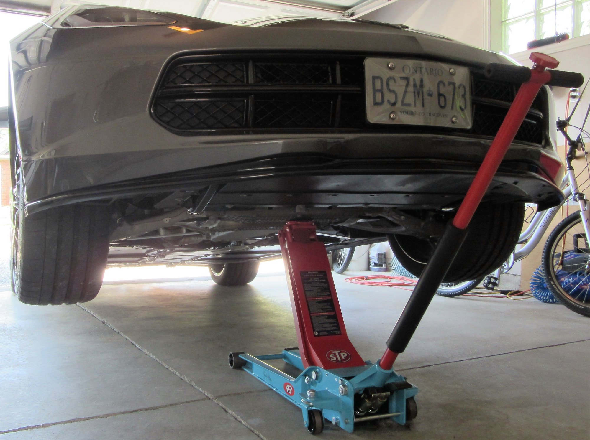

snap in plastic pucks
jack saddle w/rubber pad

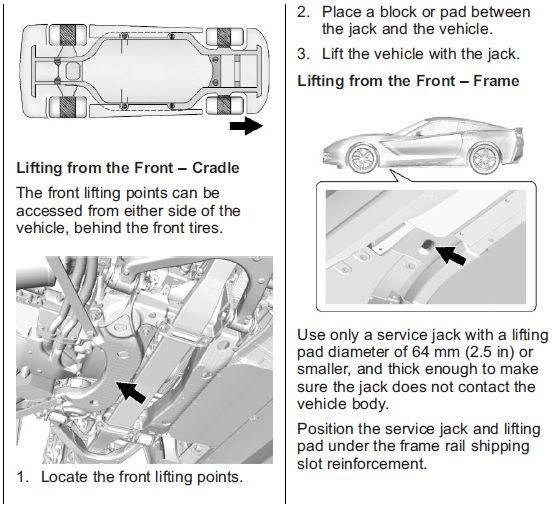

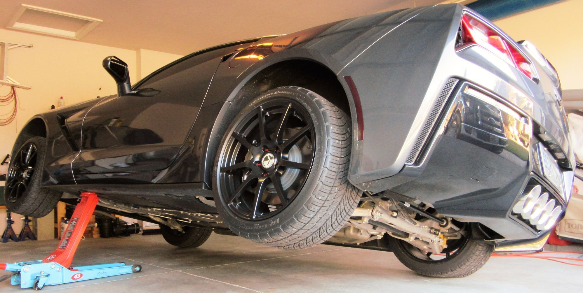

Exactly where is the lift point for lifting one end or another? The pic seems to show the transverse spring mount...is that correct? What about the front?
TIA
Doug
