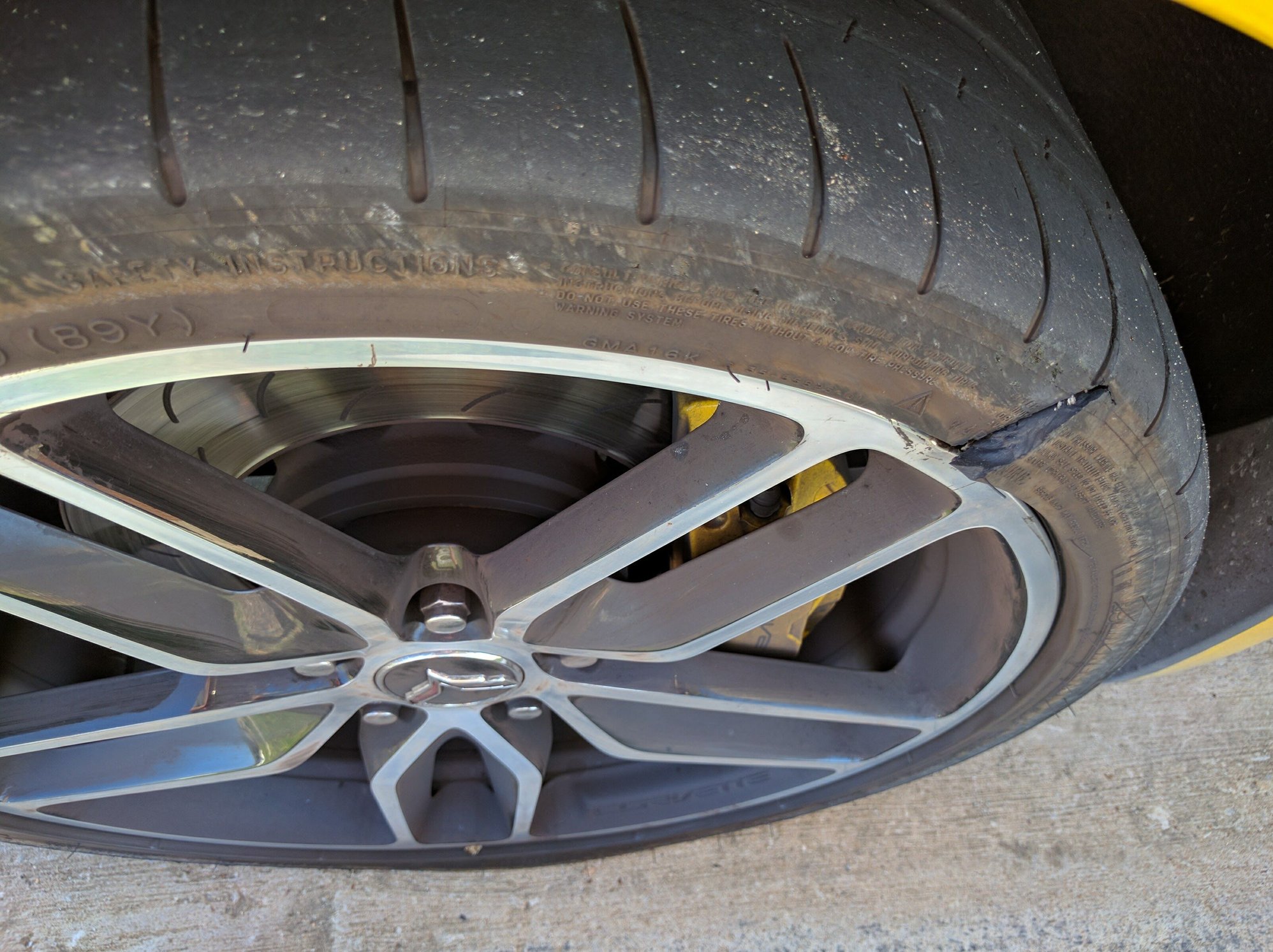

I hit a square bar of metal at 90+ mph and instantly got a TPMS error that said the tire had zero pressure so it definitely polls fast when an event happens.
The original message that showed up in the center was large and this was the picture I took while limping to the tire store.
