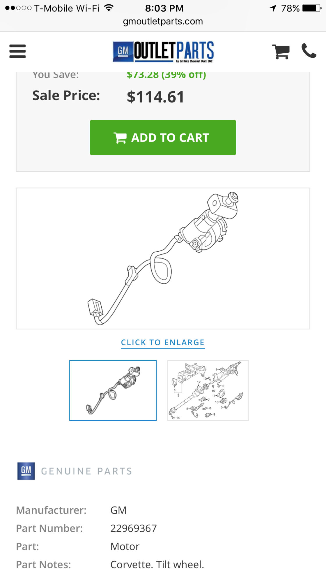

Update: Had to wait 2 weeks for the part to come in, but it's fixed now. I checked out a brand new C7 in the showroom floor and it had the same problem! The entire column moved up and down slightly. I'll try getting a picture of my service invoice up.

Here is the invoice:

thank you so much man! I'll show the thread and part number to the dealer. It's around $180 for the tilt motor. Well, the car is new and has wattanty!

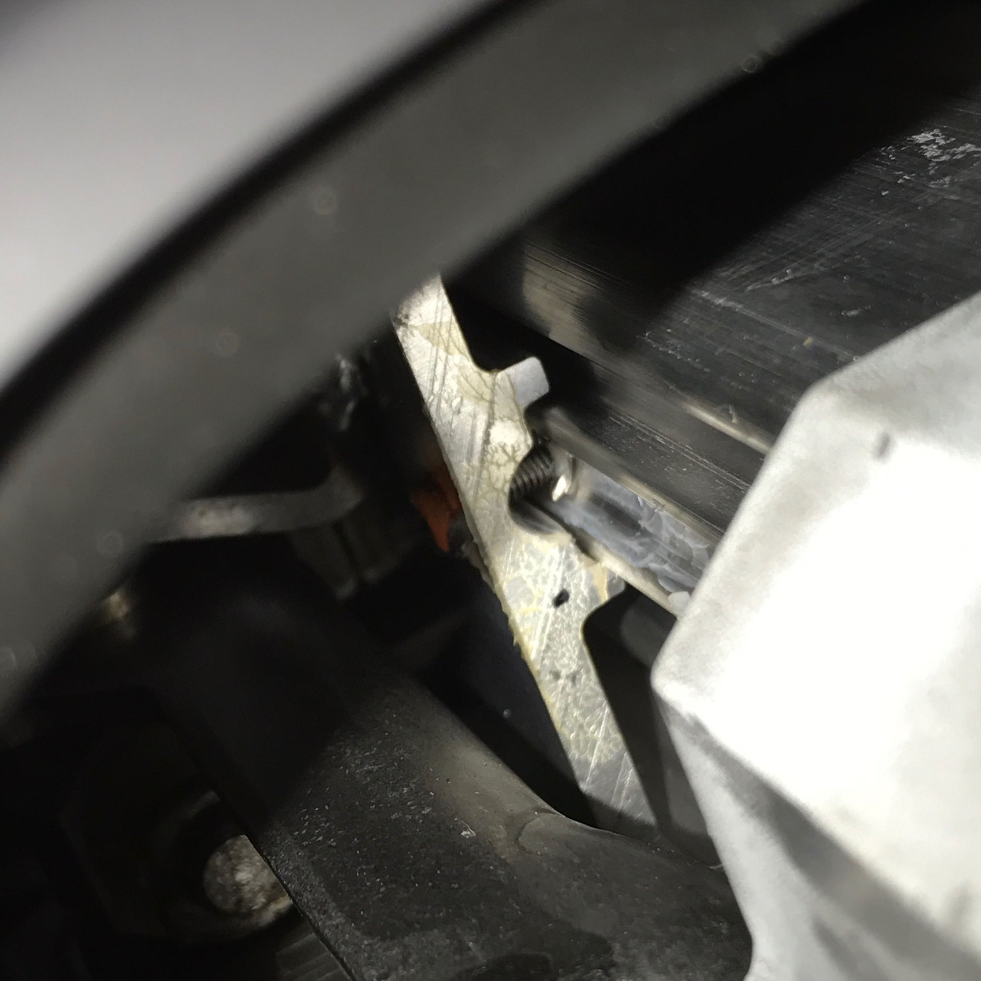

Hi guys, I took a look at the steering column myself today after total fail of my dealership Boardwalk Chevrolet. It's not the tilt motor in my case. The entire moving portion of the column has play. I posted two pictures where you can see the inner part of the column that slides back and forth for longitudinal adjustment. You can see a little screw, kept in place by red loctite. These screws (one per side) hold nothing in place at all!!!! They just sit there inside the track along which teh inner portion of the column travels back and forth for no apparent reason.
I have a guess, and maybe one of you can help me figuring out if I'm right or wrong: It appears to me that these two screws were supposed to hold a plastic piece in place that would keep the steering column play-free inside the track (hence the grease in the track that u can see in the pictures). I suspect these pieces have never been installed! could that be? I tried to search for steering column parts, but could only find the entire coulmn assembly online. Could any of you take a look at your columns? all it takes it lifting off the upper portion of the column plastic cover (one bolt on the underside needs to be removed prior). Thanks everyone in advance!!!! Best, Wolf.

Ever find out if a piece was missing?
