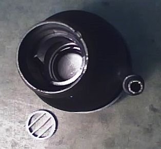

I had removed that crazy grid 6 mos before the recall on my 2014 sure helped the fueling up issue.

Here is the service bulletin for replacing the inlet nozzle.
If still in place, .7 hours.
I changed mine in less than an hour, even figuring out how to do it.
I should have just removed the grid and put the inlet back in.

Thats exactly what I did Much easier gassing up too without the flow restriction! It was very simple to do removed the wheel well liner and went for it, pretty simple.
