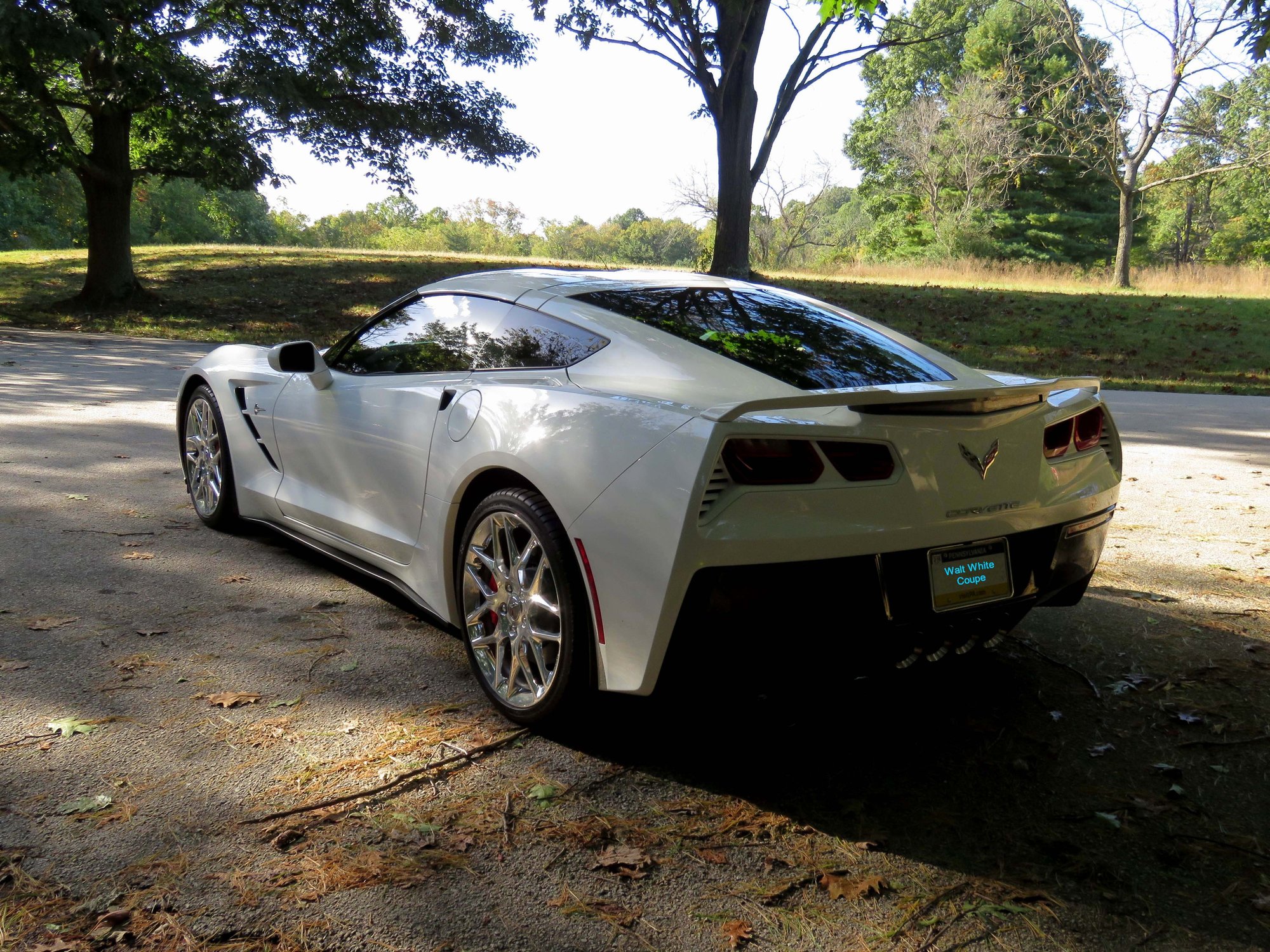

Thanks for the pic. That side skirt looks really nice. May have to go that route as well. Did you install them yourself?
Thanks and yes, I did it myself. These are screwed on with about 6 screws per side. I'll never take them off so drilling on the bottom of the rocker was no problem for me. Should have had some one help hold it on while I drilled but some duct tape worked well.
Here's a better shot of the car with them. I like the more "minimalist" look with the same protection.

Nice! I just ordered the splash guards. Gonna hold off for now on the side skirts. A bit freaked out about the screws.
