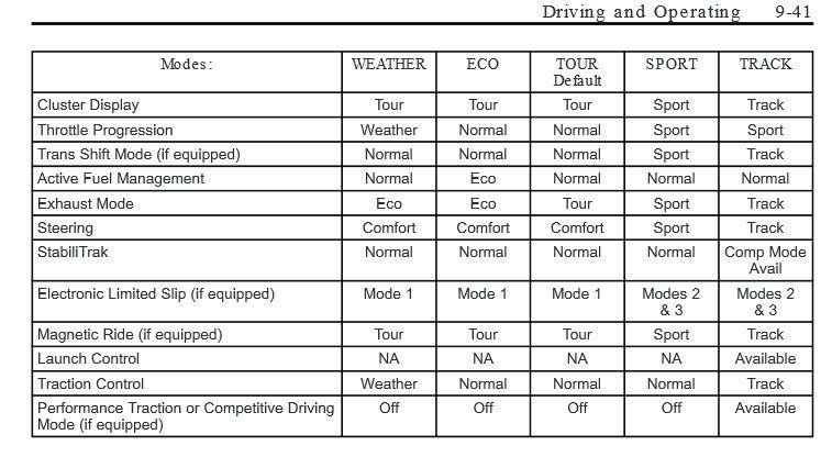

If one were to choose eco mode and compare it to sport mode in the same Z51 gearing over the same road using cruise control, how can eco produce the mpg improvement?
Does it go quicker into 4 cyl mode? Does cruise control acceleration and braking change? Does the exhaust really differ in cruise control? I can't find this in any thread so far. Which of the following variances would account for the claim?

Because you'd be in 4 cylinder mode more of the time in highway cruising. Sport mode has a more aggressive throttle mapping.

You're asking a good question, but I'd guess yes.
AFM being in Eco mode could also have something to do with it, but I've never understood whether that system does anything else other than open and close the valves before the mufflers. I suppose AFM may also have something to do w/ ECM programming, such that you're in 4 cylinder mode more often.
