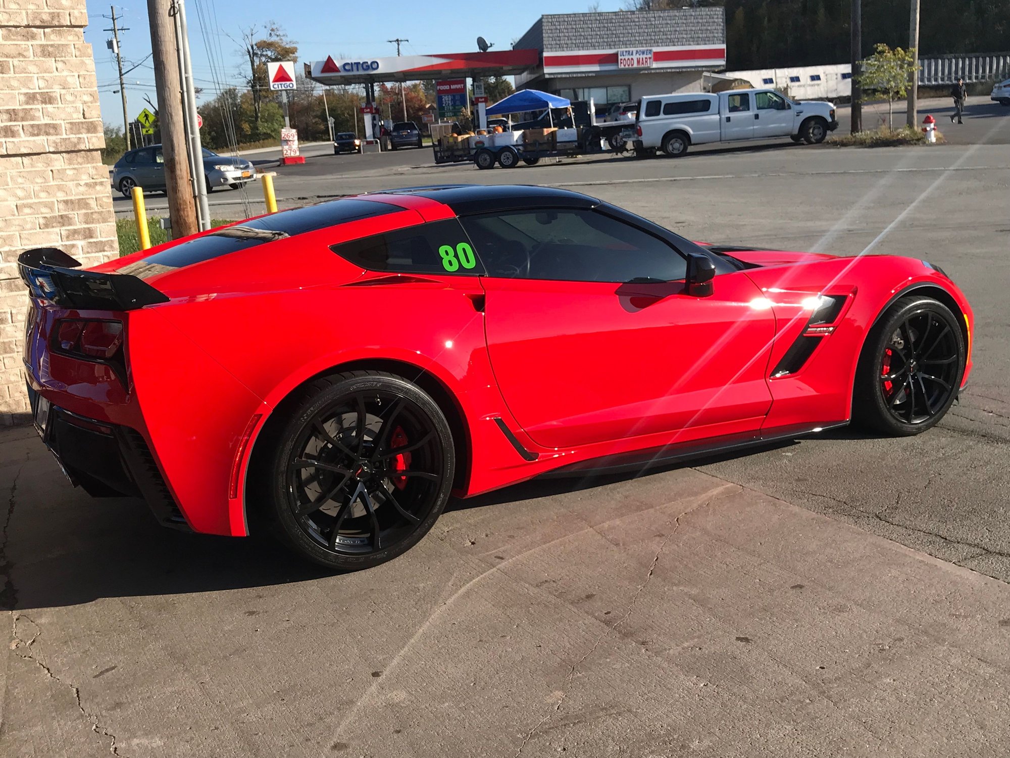

Save some money and DIY....buy the Adams Ceramic Paint Coating Kit.
Follow the instructions, and make sure you have washed the car, polished the car, prep surface the car then apply using the Adams kit.
All of my cars have been ceramic coated as a DIY Project.
