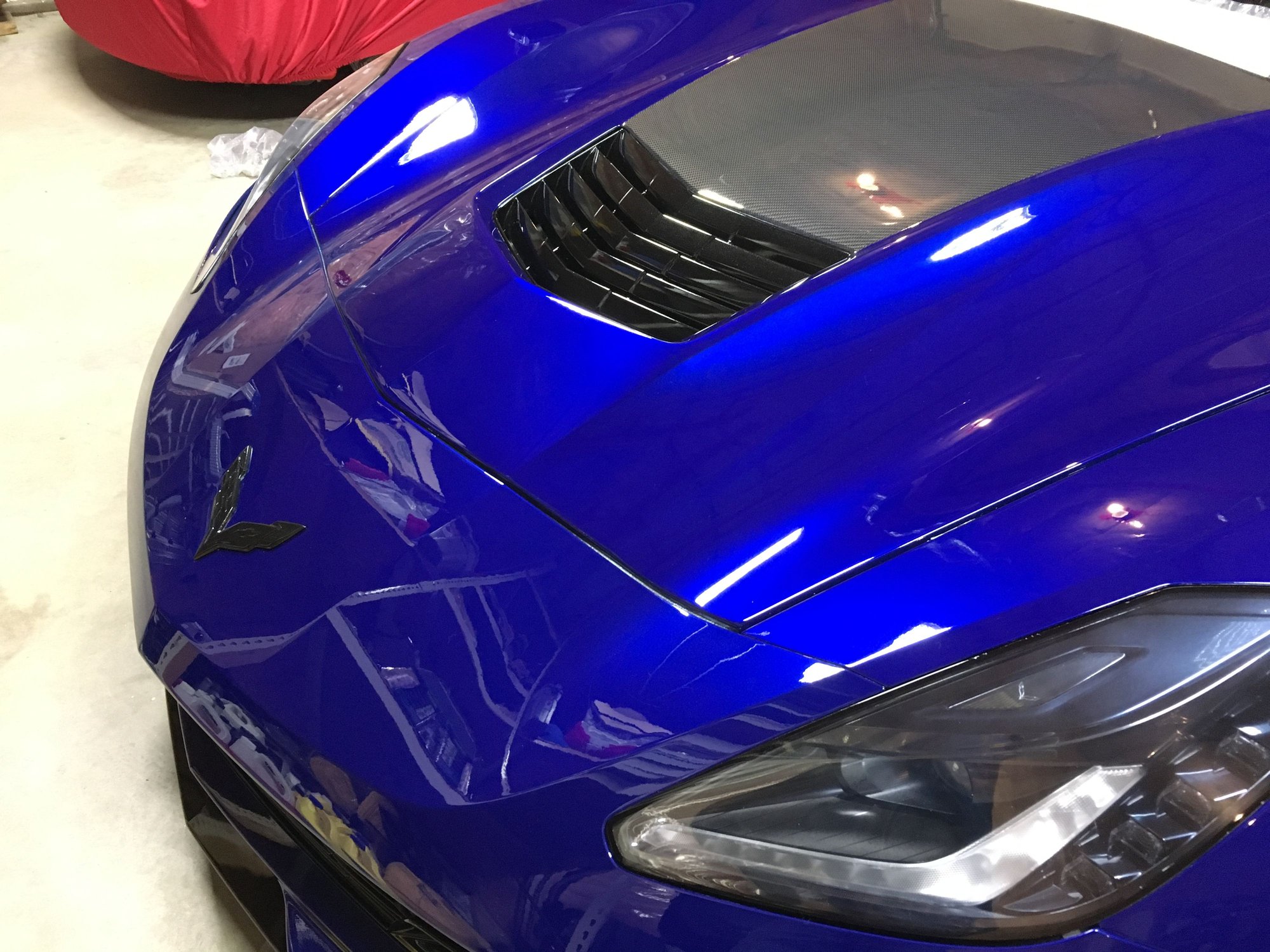

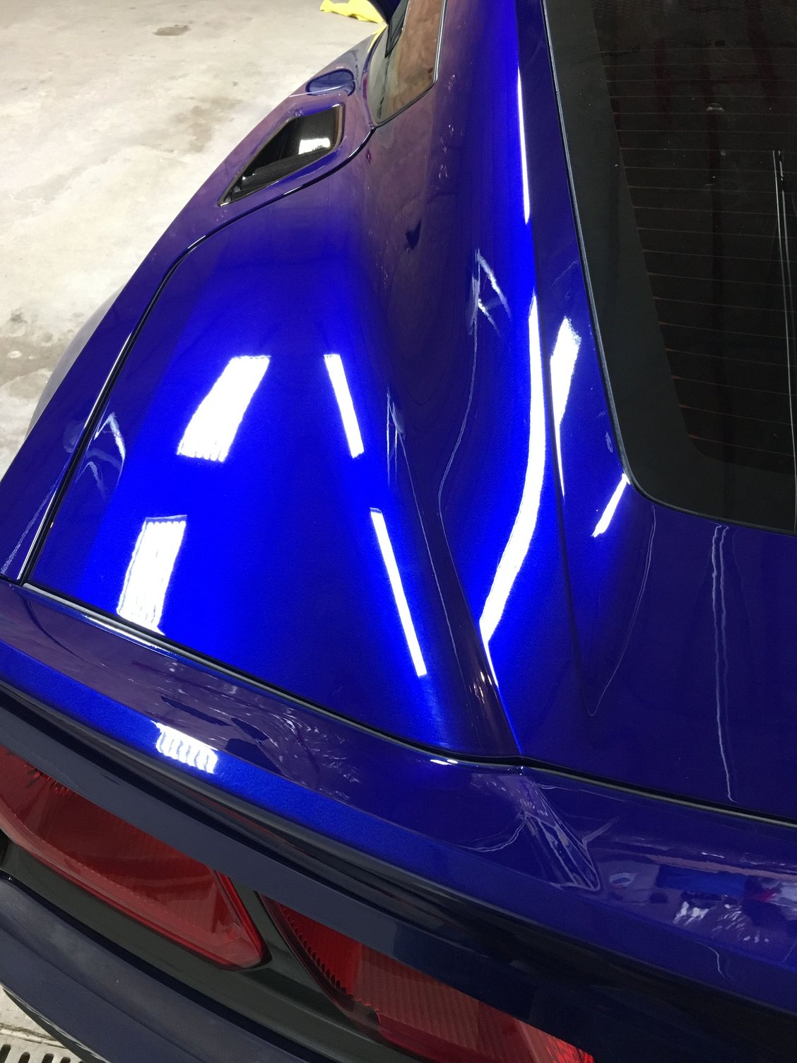

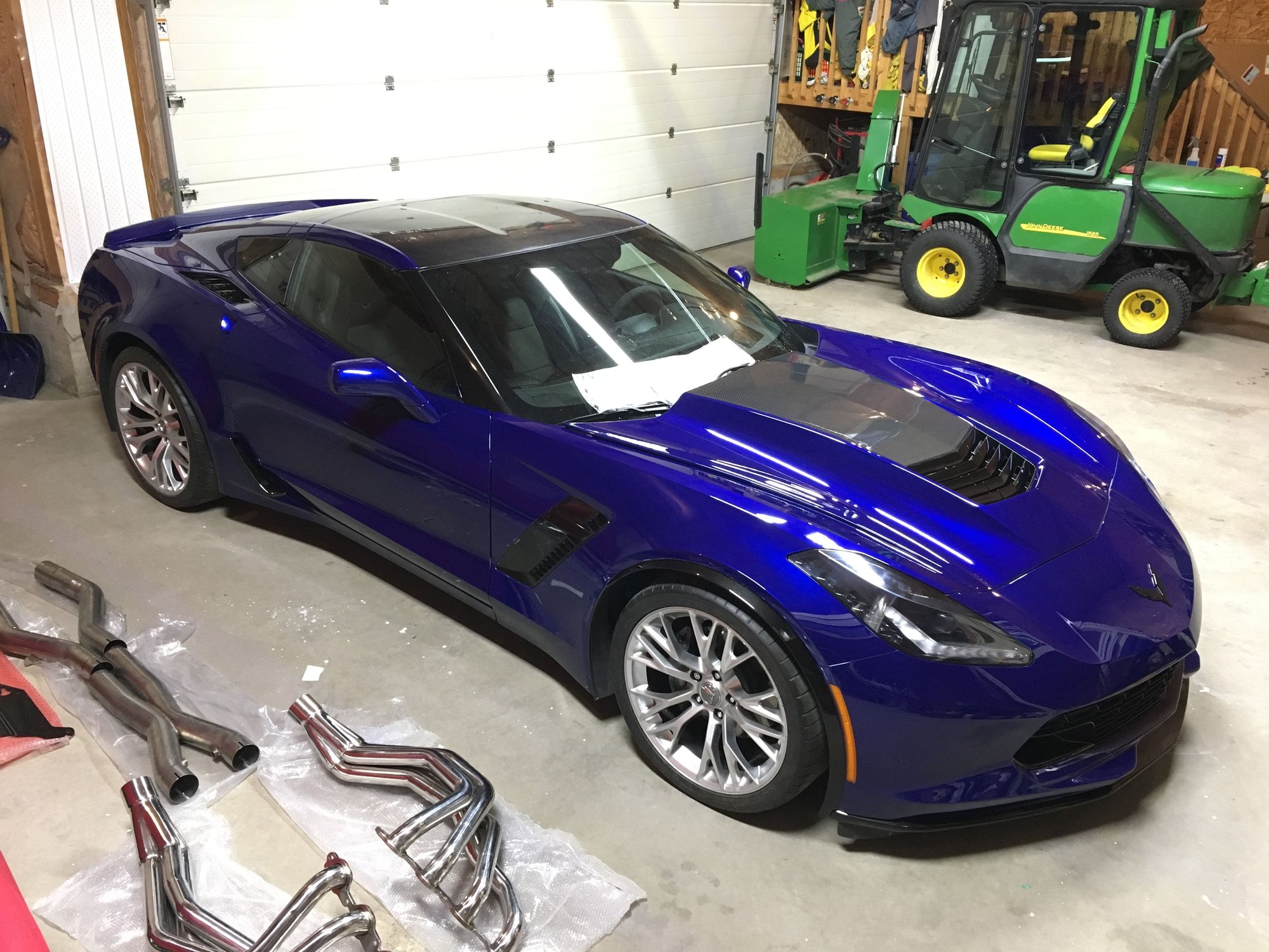

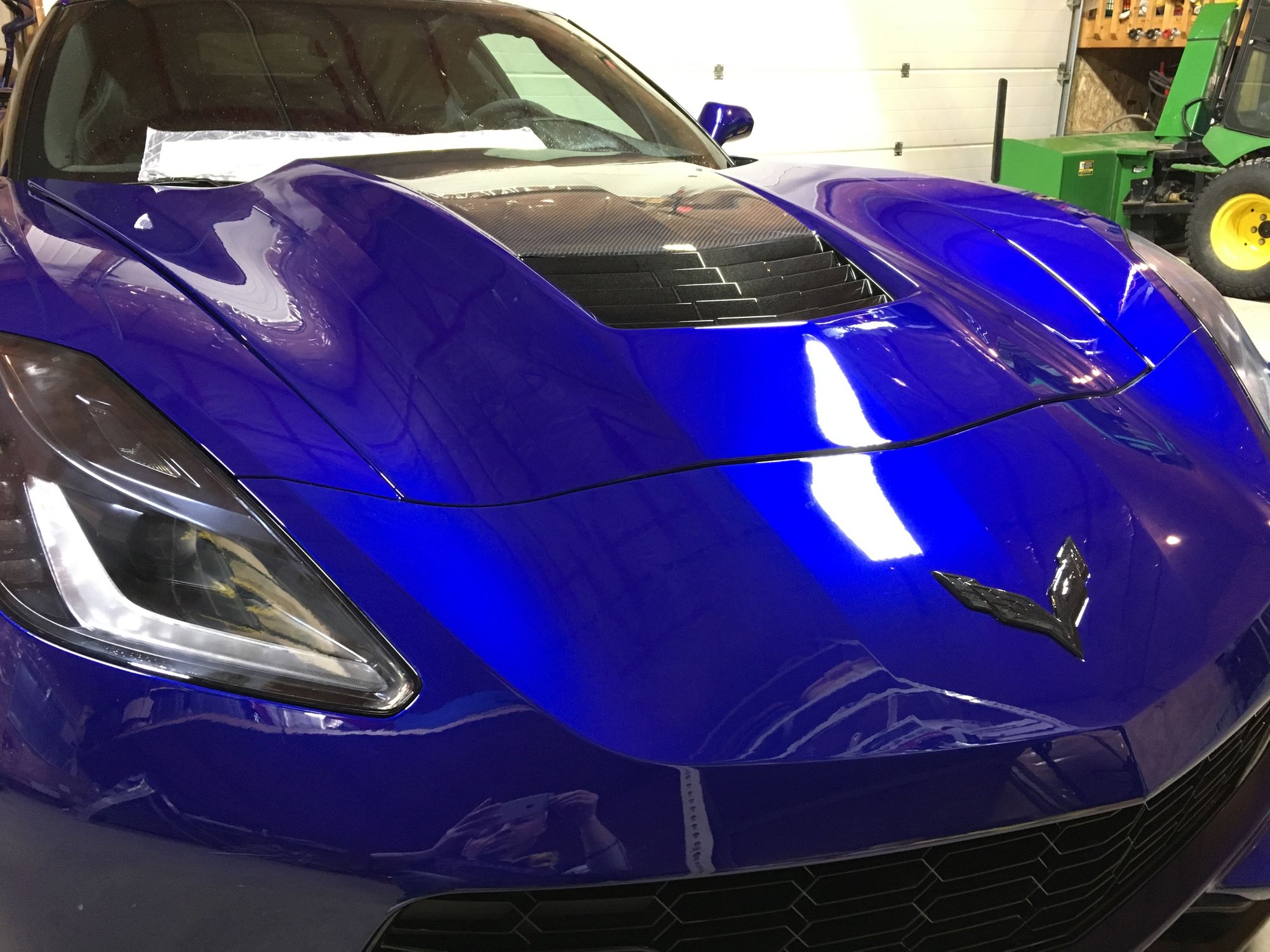

The color choice was beautiful but the clear was very soft. I bought the car with the new paint on it and noticed the car cover I bought was actually killing the clear coat. Here is a pic of where I started right after I rubbed it down with a clay bar.
The whole car was like this. It was in pretty rough shape for new paint. I spent about 13 hours on it first cutting with a heavy duty wool wheel and Maguires Solo. Went back to Maguires Diamond Cut 2.0 and the same coarse wool wheel cutting all the scratches out of the clear. Followed it up with the Diamond Cur on a medium wool wheel, then Maguires swirl remover on a medium foam pad followed by some 3M Polish on an ultra fine foam pad. Then two coats of Klasse All in One. I still need to apply the Klasse Sealer a few times but here is the current state.

Patman the spoiler is from from a Z51. The car was originally a base Stingray with no spolier from GM.
And Larry this was my first attempt at that much cutting. Luckily I have a great friend who let me use his garage and all his polishing supplies. Here is what I used. The wool compounding pads were 9 inches (3M #'s 5711 & 5713) and the polishing pad was 8 inches (3M #5751).
