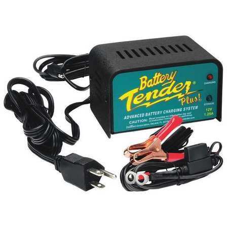

I've been using a Deltran Battery Tender Plus for over ten years (including on my C7) without a single problem. It's readily available for around $50. You can get an adapter cord for plugging into a 12V socket (the one found in the rear hatch) separately for around $7.00.
That's exactly what I use!

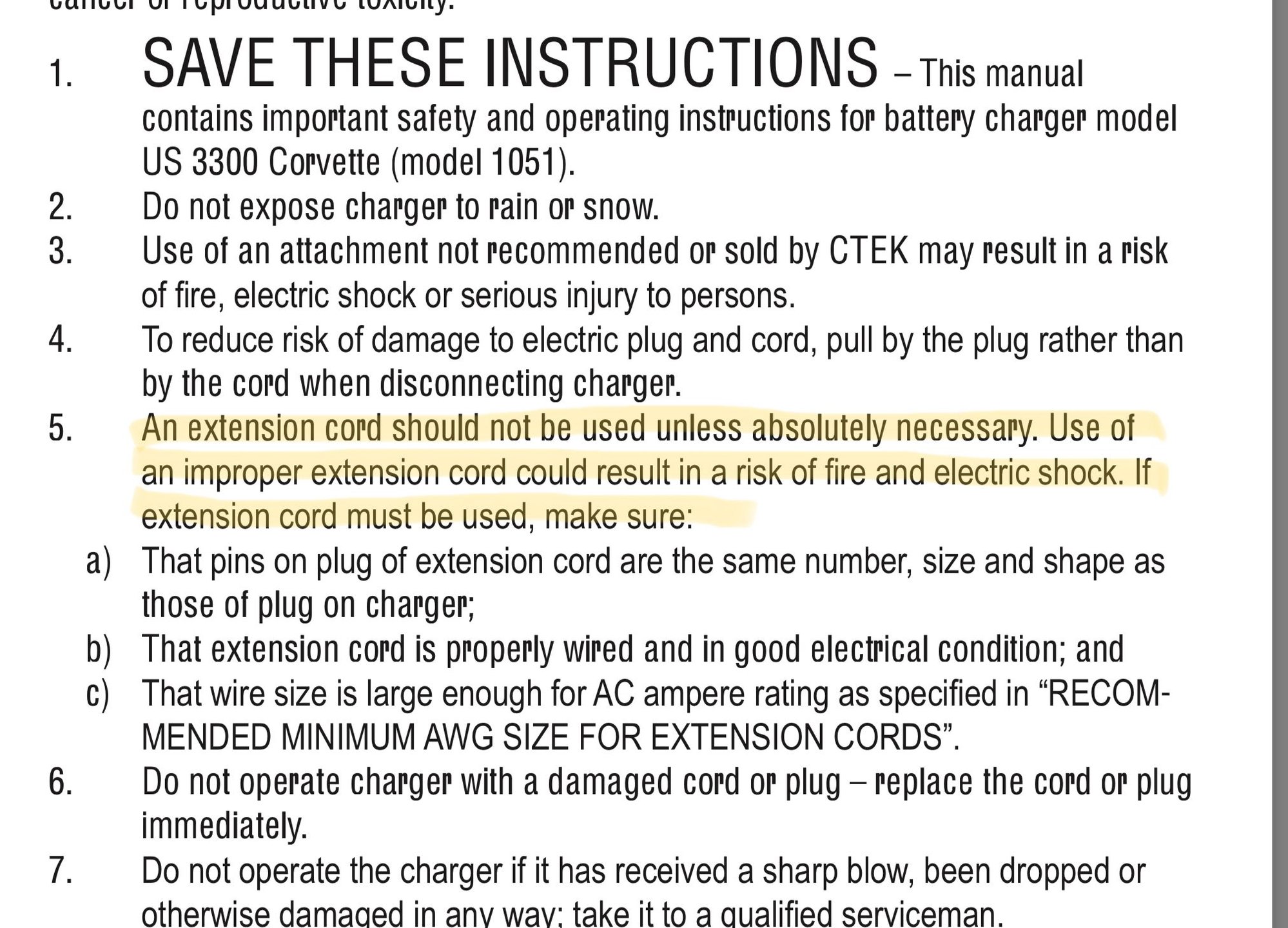

I was reading this link and it says do not use with an extension cord. I pick up my car Thursday so I do not have access to my charger yet. Seems like I will not be able to use the tender then as I need about a 25 ft extension to use. How long is the electric cord for the tender? Maybe I could buy a 10 or 12 gauge extension cord.
You can use an extension cord.. no problem (and it doesn't need to be all that heavy duty as the charger pulls next to nothing under load

Likes: 3,105
There is absolutely no reason not to use an extension cord with your charger. I would make sure that you don't try to close the rear hatch on an extension cord because the cord is too heavy but other than that there is no reason for not using a good quality cord.
huh??? Just read page 2 of the link listed above. See highlighed lines. So your saying it's all right to ignore this safety warning? Why?

From: Toronto
I think they are just covering their *** with that statement in case the extension cord is defective and some how causes a fire. The maintainer / tender draws very little power.
