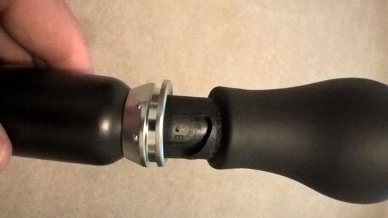

I thought there was also a rubber o-ring that held the boot to the ring. You might want to see if that is still there.
Also, here is what the slot for the ring looks like....
I bought mine before the business was sold. It came with 3 "O" rings of various thicknesses. I only needed the small one. However my pins were so tight in the **** slots I need pliers to get it back on! It won't move.
