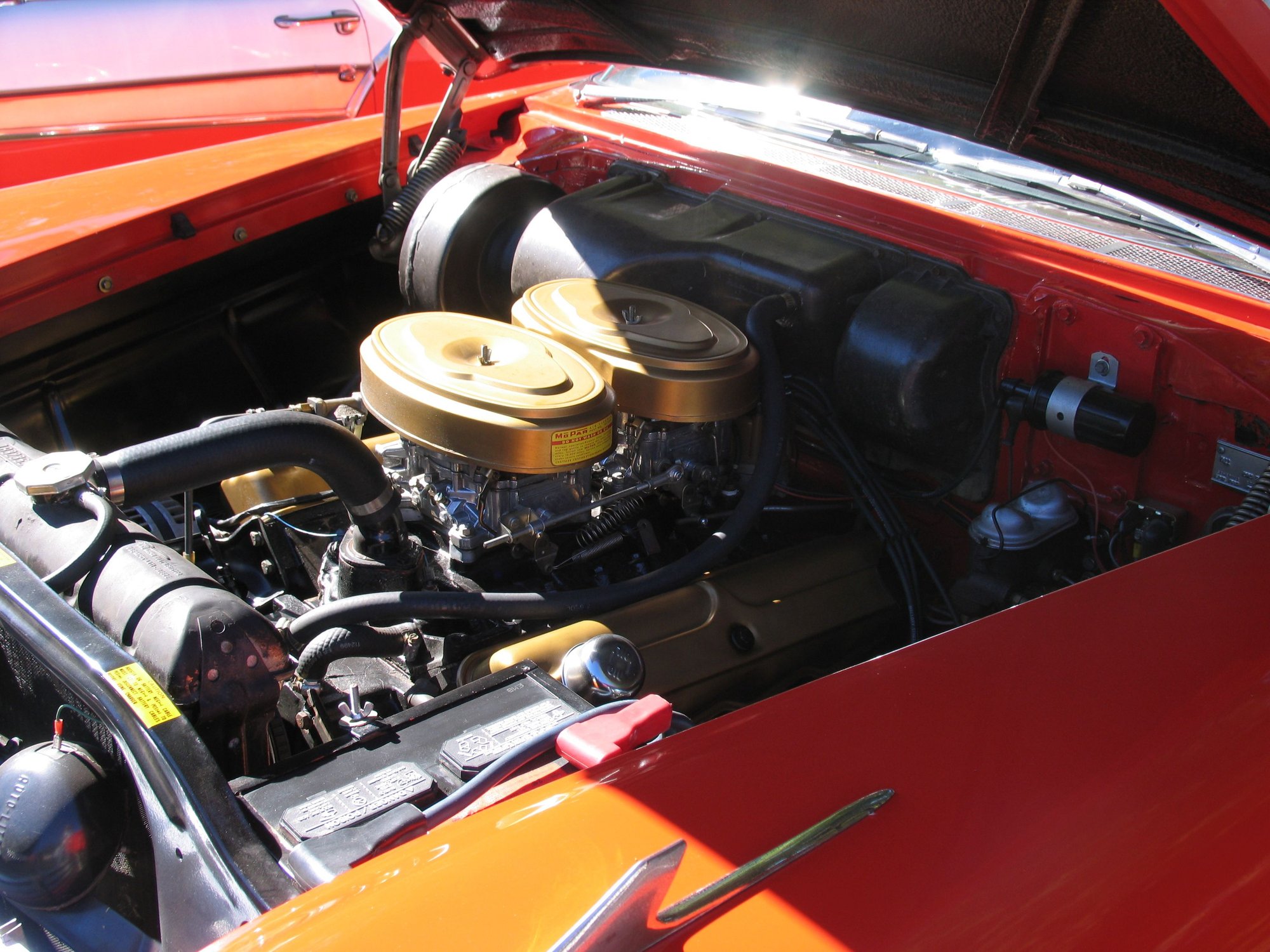

Originally Posted by Walt White Coupe
Mopars always had the most impressive looking intake manifolds!

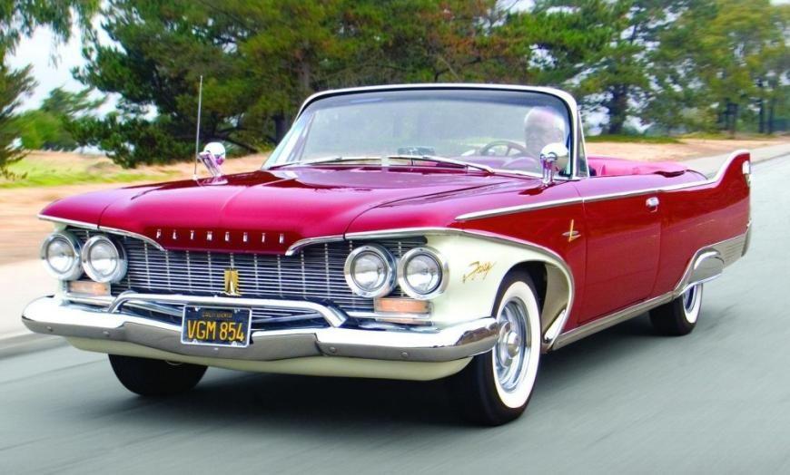

One more.
What is this in?

Originally Posted by L8ter
What is this in?
It was used in many high power Chrysler Products in 1960 and was called "SonoRamic" induction. It created a form of ram induction tuned for power in mid RPM range. It was terrible in winter on cold mornings because there was no way to heat those long tubes and since it ran on both 4 barrel carbs it was known to get around 8 mpg.
The first "unibody" construction by Chrysler.
One more.
Thanks for the good 'ole days pix......luv em.
