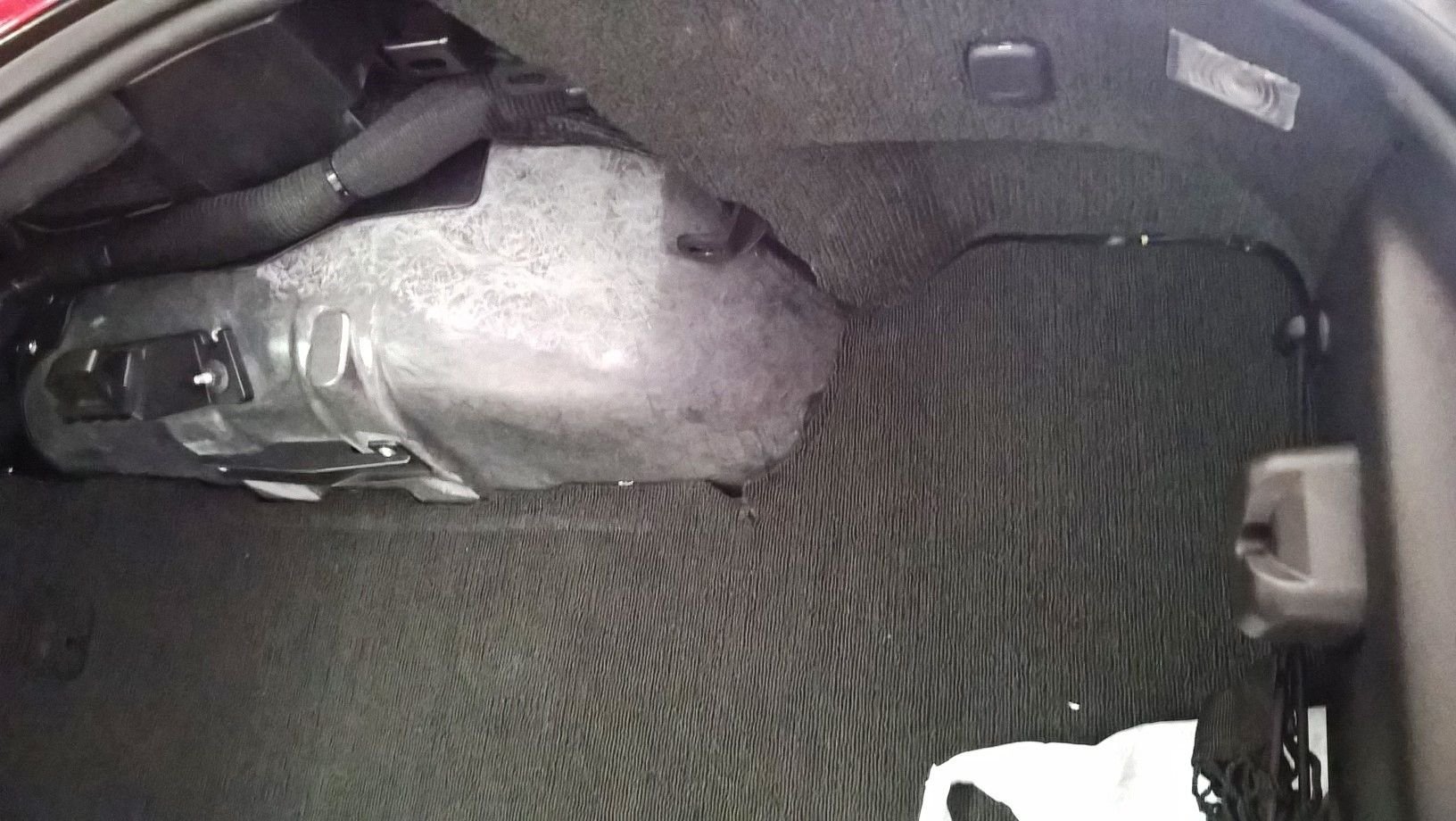

I was surprised when I saw my 2014 only came with a 30 month battery, so I figured anything over 3 years was risking a failure
I just changed mine last week with a AC Delco 48PG (gold series) battery with a 42 month free replacement...
If you work it right, you may never have to buy another battery.
Also, since the carpet is so stiff and easily torn, I suggest you get as much out of the way as possible. I removed the side panel so nothing was holding the carpet down, and removed the positive cable and extra connections so I could completely remove the fuse box instead of trying to just get it to stay off to the side. The battery is hard enough to get out without having things fall in the way...
Here is a photo of where the fasteners are on the side panel.

Does the side panel just pull off? Pull it off from the bottom? Thanks.
The panel is just held on by clips, but you do need to remove the cargo hook, and it helps to remove the small insert around the roof clip.
