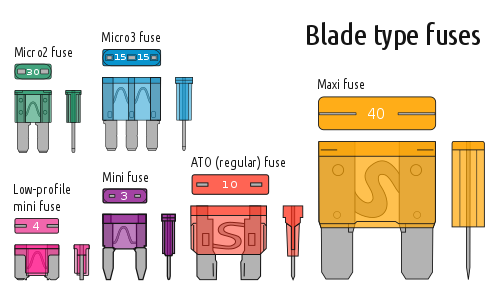

Does anyone know the type of fuse used for #42? I lost mine after pulling it and I've tried micro2 size APT and APR and neither one is an exact fit. Or if anyone knows the GM part number. I ordered some from GM for my 2016 Z06 and they were wrong too! Slightly large with different contact posts. Thanks.
The GM part I ordered was part number 88861352 and it's definitely not correct.

Here are two photos. One standing on end view and the other a flat view.
The NPP fuse is a Micro 2 fuse. 20A Micro size. 2 legs.
Look inside the lid of the fuse box. Number 65 thru 75 are spare fuses
number 69 on my car is a 20A fuse.

Thanks everyone for confirming. GM must have sent me the wrong parts because what I received was supposed to be correct but it clearly doesn't fit. I do have spares in those locations but since I lost the original I wanted to get some additional spare parts. Looks like you can't trust GM to ship the correct parts......
