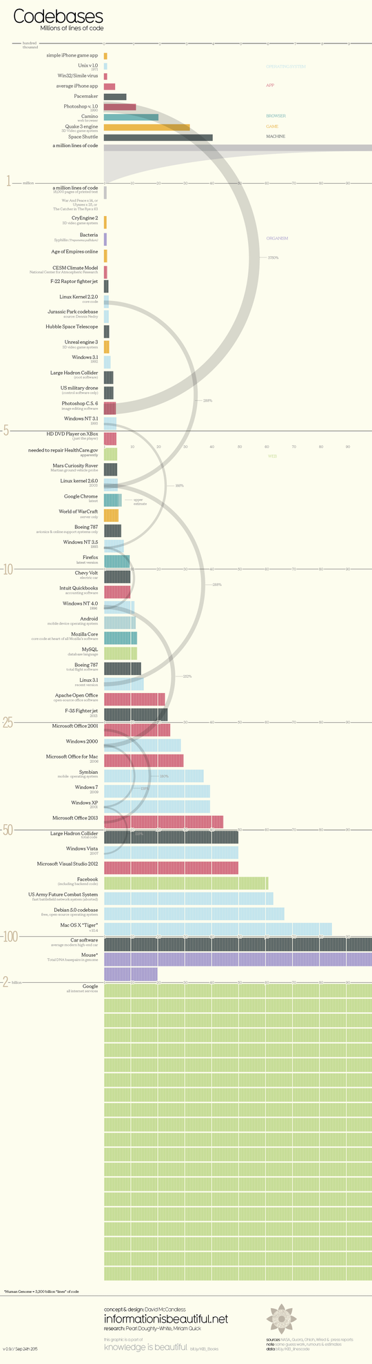

I'd chalk it up to a "glitch". There is an amazing amount of processors/code in a car like the C7. Far more lines of code than are in Windows.
