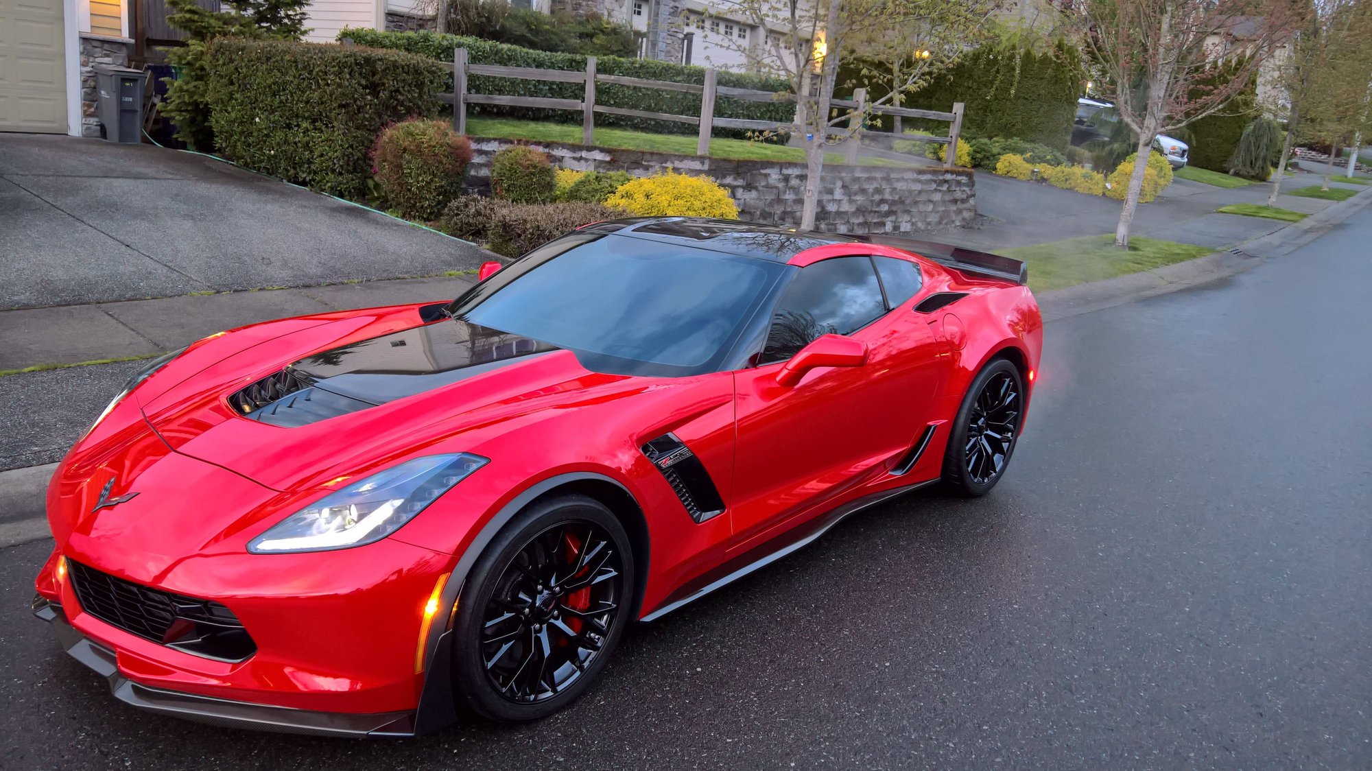

I had Cquartz Finest applied after paint correction.Name:  photo4294967086.jpg
