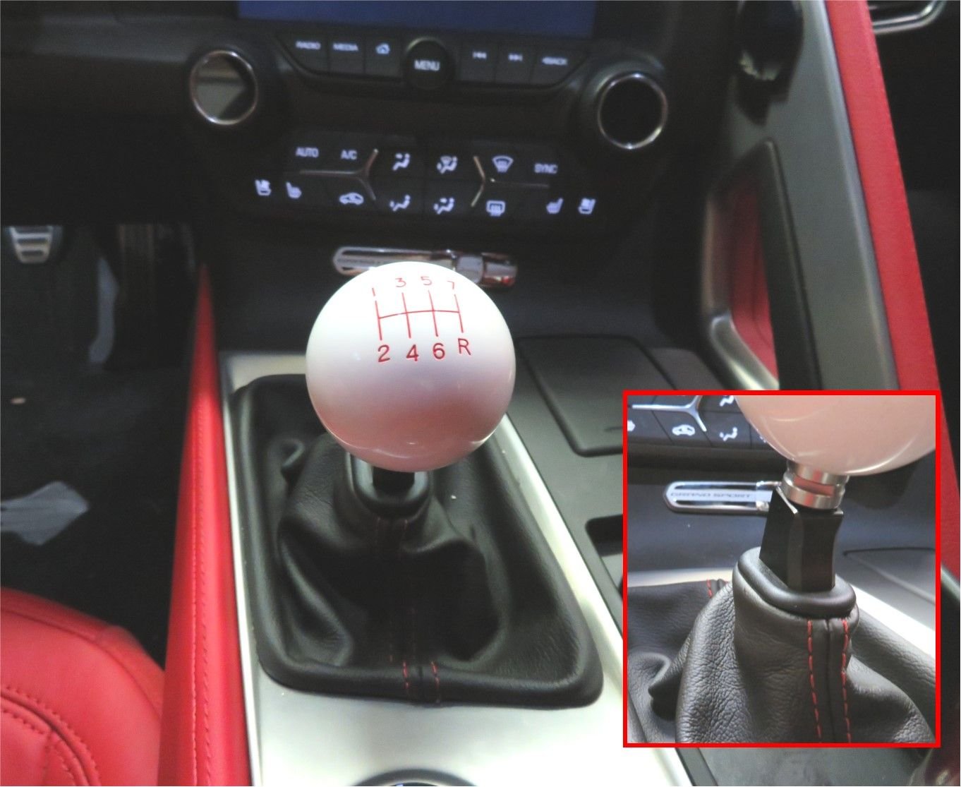

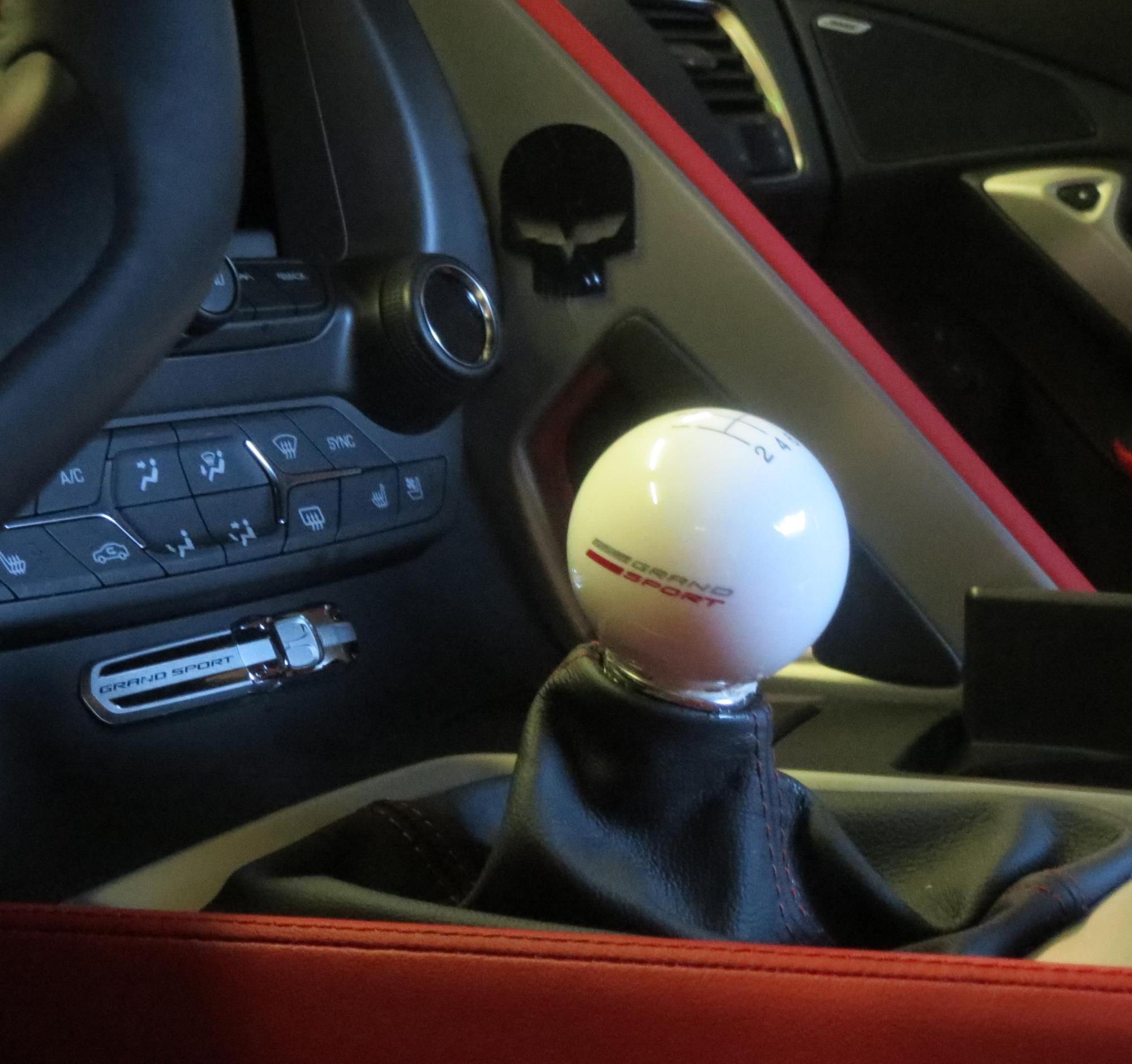

Thought installing this Cue Ball size Grand Sport Shift **** would be easy. After all installed one on my prior 2014 C7 an only issue was removing the chrome ring!
To start, it looked like this ring would turn easy compared to needing pliers for the 2014! However what turned out to be easy was the leather boot slipping off from the chrome ring! Fortunately rather than taking the top off the console and trying to fasten in back mechanically I recalled a poster saying in a thread where this had happened that he would just use Gorilla glue! My adhesive of first choice is 5 minute epoxy. Applied in the chrome ring groove carefully with a toothpick and put the leather back- worked great!
The next step was to remove the screw from the OEM ****! Even applying some heat to the screw to overcome the Locktite GM probably used, it would not budge! Bought a new Torx bit and some "sure grip paste" and achieved enough force to shear the head off the screw! Drilled it out, installed the longer screw that came with the new **** and reached unharmed threads and all was fine!
Took much longer than the 15 minutes expected!
This is a PDF of the install on my 2014 as well as the Grand Sport: http://netwelding.com/Shift_Knob.pdf
Cue Ball size shift **** works great, reduces stroke ~12% since it sits lower on shaft.

What I thought would be an easy mod since, A) I had done it before on my 2014 and dealt with the difficultly of removal of the chrome ring that has been in many posts B) in 3 1/2 years have seen issues posted with the leather boot coming off; never thought removing the screw would be an issue.
There are comments in some instructions of driving the car for several hours to get the shift handle warm. Thought using a soldering iron with the flat tip would be better. Looking back, should have, 1) bought a new #15 Torx bit to start (that small size does wear) and 2) heated the screw longer before trying to remove it. That may have worked but if GM used Red Loctite on that small screw, perhaps not.
I also recall having to use a 1/2 inch breaker bar to remove the side drain plug the first time I changed oil in my 2014. It clearly had Loctite on the threads when I got it out. This whole shift ****, boot design could be better IMO.
