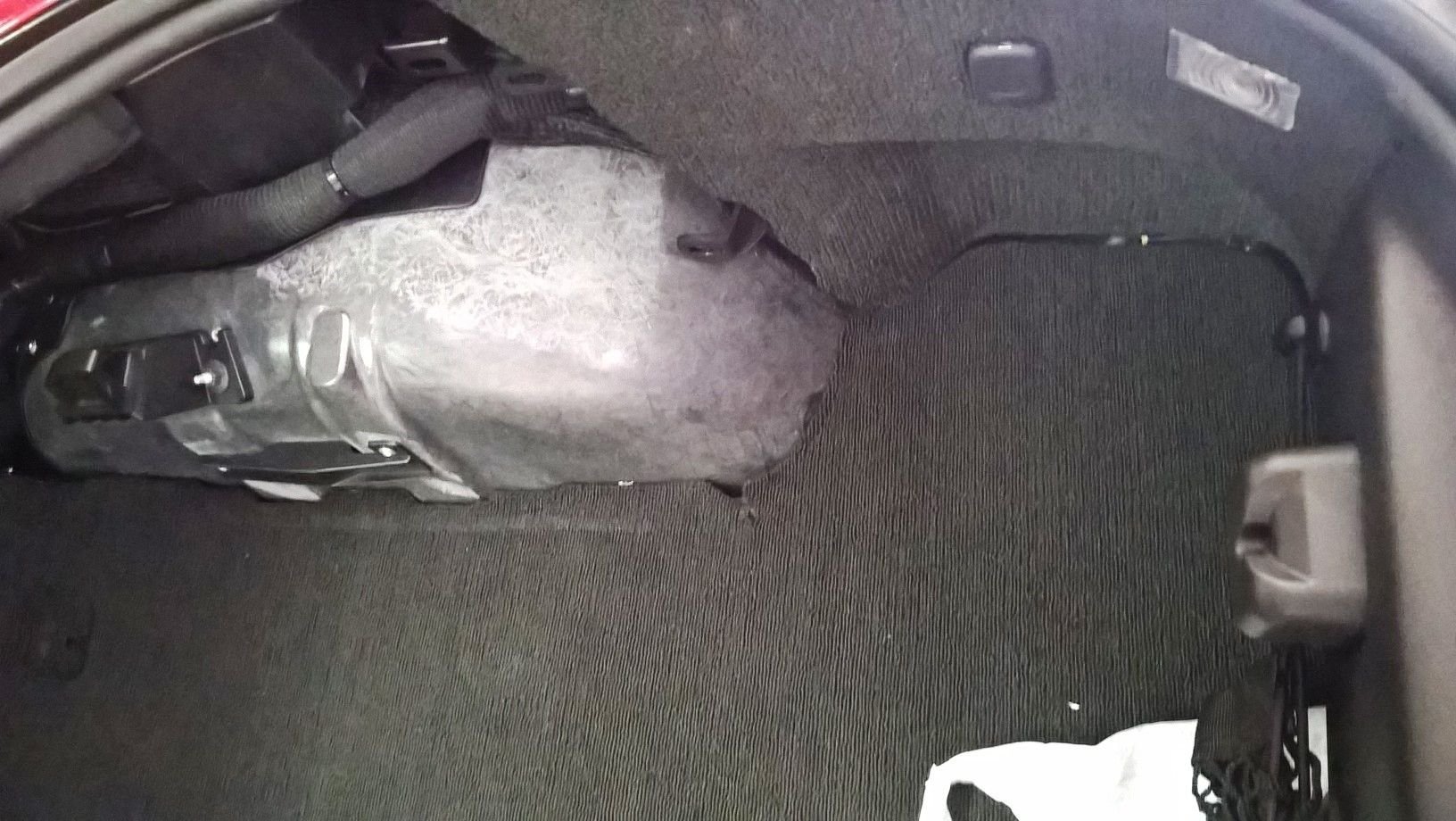

If you carefully lift the passenger side rear carpet you will see the battery under the Styrofoam cover.

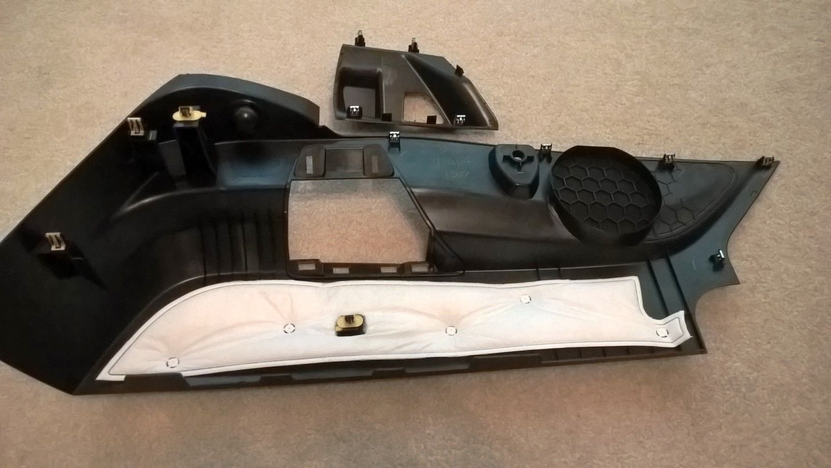

When I changed my battery I had to remove the right side trim panel to keep from tearing the carpet and scratching up the rear panel.
The carpet is so stiff, the edges actually scratch the panels if not protected.
