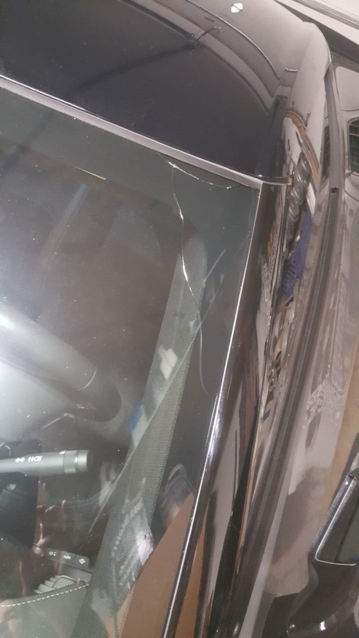

I had a bad start to my morning yesterday, I was walking by my car in my garage which had sat all week and as I walked by the driver side noticed a crack in the upper left-hand corner of the windshield. It is also a HUD car. It appears to be a stress crack, only the inside pain is cracked and there does not appear to be any kind of an impact. Called the dealer yesterday, they said to bring it by for them to inspect it to see if the warranty will cover it. I just hate to have my new car worked on and taken apart, kind of takes away the newness.

tell me about it, had it done 3 times. It gives you a miserable feeling knowing what has to be done to get the old out and the new in. Fortunately for me everything turned out just fine. Make sure your new glass does not have an distortion issues. Good luck!
