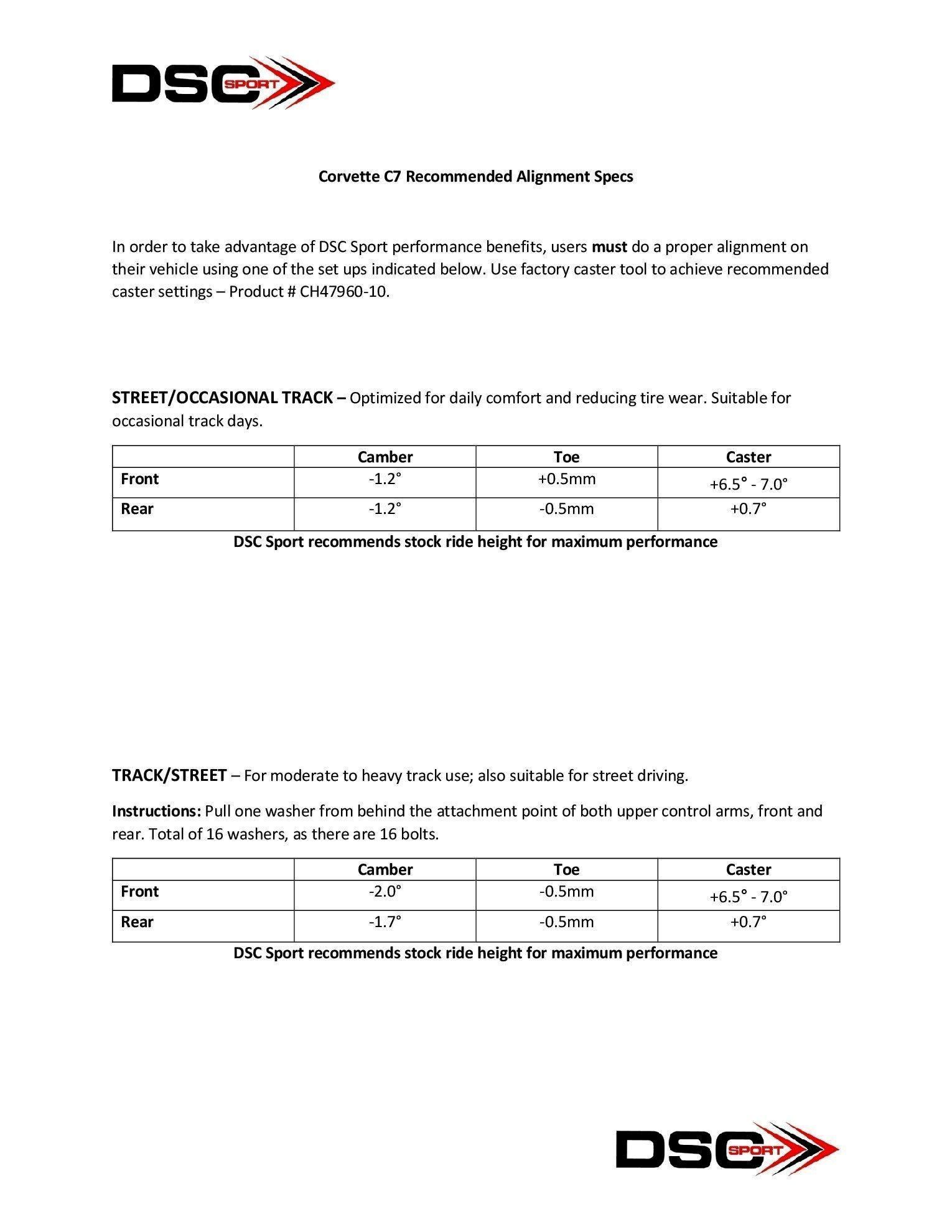

I've seen some posts mention a degree of variability on how cars come out of the factory.
I know I saw a thread with different alignment settings a few weeks ago.
One setting was "street/occasional track" another was Track, etc. I'm interested in the former specs.
I just got a new GS and want to bring the specs to my shop, check out the factory settings and adjust if necessary.
I've done the search thing...Can anyone point me to it?

Here are the specs you requested. I had mine set up to "street/occasional" specs at the DSC shop, and it's an excellent set-up. The car both tracks and handles better than whatever random setting it had at BG.

You didn't say what kind of driving you intend to do; all street/Hwy or a little track mixed in. If you are like me and do nothing but street/Hwy, you have got to dump most of the Camber otherwise the inside front tires will wear faster than the rest.
To get a nice flat wear pattern for street driving, go with this setup. I have been using it for way over a 100K miles now and my tires wear even side to side.
The top half is before, the bottom is what you want to use for street. Keep the Camber at -.5 degrees average or less.

Thanks Foosh and Hisvet. Your posts are just what I was looking to find again.
I do spirited street driving and plan to get to the track here - Roebling Road - after the 1,500 mile break in period AND after going to Spring Mountain.
I am excited to step up from my 2016 base ( Z51 sway bars only ) to the Grand Sport.
I just have 175 miles on it but have been experimenting with settings - and offering to drive by buddie's homes at 05:30 to wake them up with the Track exhaust setting.

I'm not having any abnormal tire wear at the DSC street/occasional specs above, and if you value handling on the twisties, negative camber definitely makes the car better. The rear caster setting is also critical.

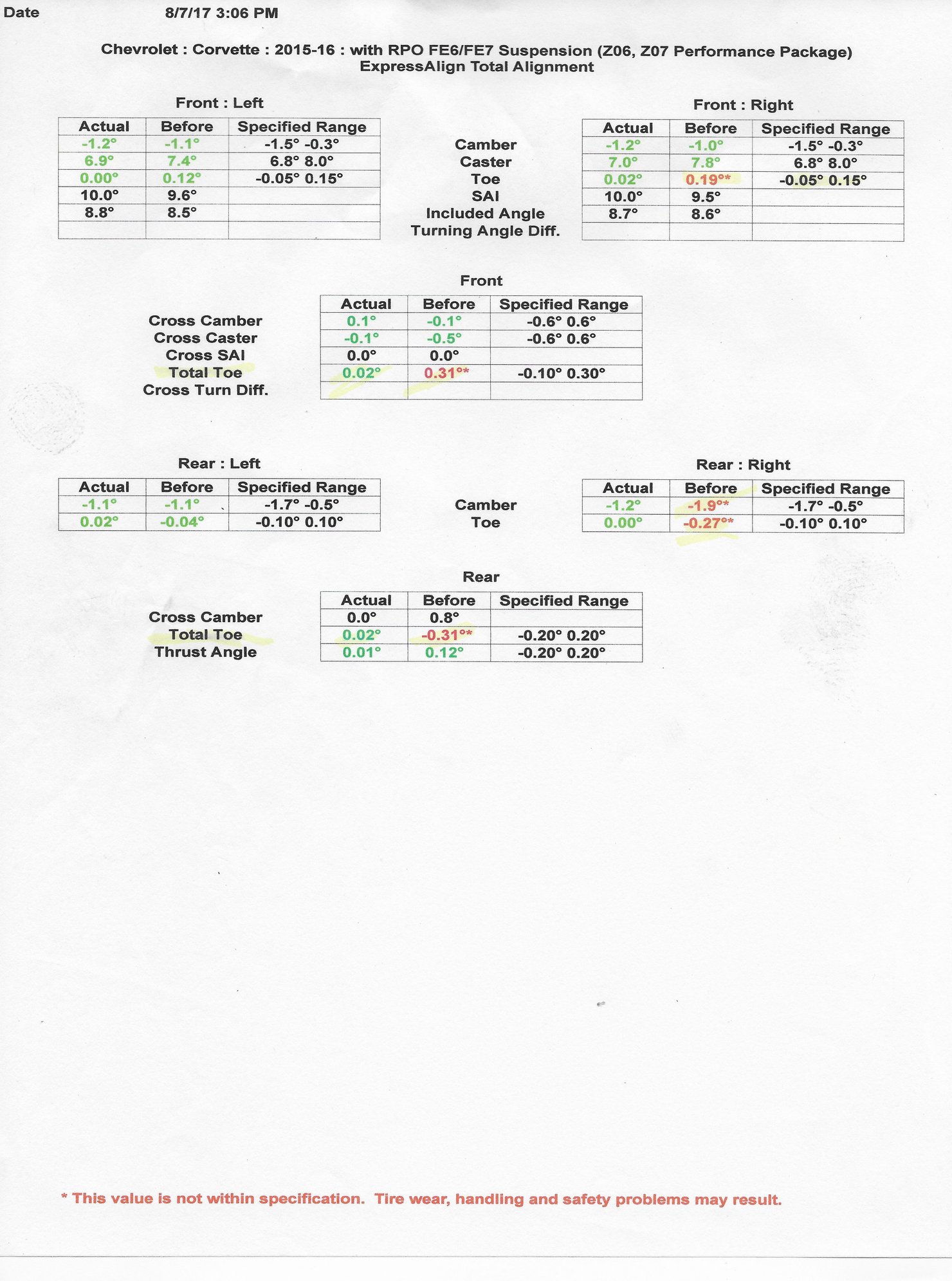

Hey Foosh, etal
Just want to let you know that I found one of the real good alignment guys in Savannah and got my GS in today. I only have 950 miles on it and haven't hit any potholes.
My *** couldn't tell if there was anything wrong and I wasn't pulling.
But,
Turns out the right rear was off quite a bit both Camber and Toe.
Right front was minimally out of range for Toe.
"Total Toe" front and rear was out of range.
Here's a pic of the printout.
I think we are close enough now to the recs from DSC.
What do you think?
Thanks for your posts and help.
Cheers,
Mike
Old Aug 7, 2017 | 05:04 PM
Bill Dearborn's Avatar
Bill Dearborn
Joined: Oct 1999
Posts: 41,013
Likes: 9,775
Looking at your before numbers they are close to the numbers on my 15Z. However, it looks like the right rear may have slipped Vs being that way from the factory. If the lower control arm cams weren't tightened sufficiently on that side the LCA could have easily slipped outward and caused the tire to toe out.
Bill

Old Aug 7, 2017 | 11:12 PM
Foosh's Avatar
Foosh
Posts: 25,583
Likes: 16,940
Tax, yes it looks good, but I don't see a number for rear caster. Did your guy have the tool?
Are these numbers good for 17 GS? Thanks

Likes: 16,940
Yes, they are good for Stingray, GS, and Z06, which are all built on the same chassis w/ the same suspension geometry.
However, you might want to go the DSC website, where they've posted an updated spec, based upon additional testing. But, they are more minor tweaks that won't make a huge difference from those posted above.
Mine were done at the DSC shop using the above specs, and the car is on rails. My factory alignment must have been horrible given the difference.
