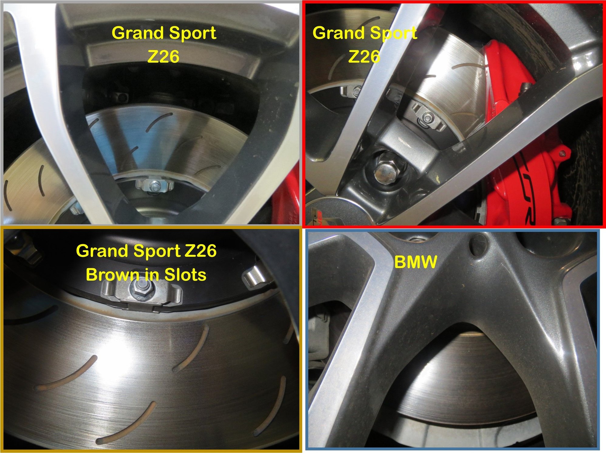

Originally Posted by wrecker3
First you can not cut or turn slotted rotors. Second i put on Powerstop Z26 ceramic pads last year and yes they are low dust and no noise but they turned the rotors brown. I have been in contact with Powerstop and they said it is not their problem !!!! I am going to get Carbotech pads
Had a thought! Did you bed the pads as Powerstop recommended? That puts a thin layer of pad material on the rotors. If you don't, the pad material will adhere to the surface BUT not uniformly.
In fact one report I read said you must occasionally use performance brakes aggressively or pad material will build up in spots and cause pulsing etc. No problem for me I use them aggressively about every trip-for fun!
Took some pics of my Grand Sport Rotors. Note, one shows a brown color in the slots but the rotors are shinny. I also put a pic of the wife's BMW SUV rotors. FWIW.

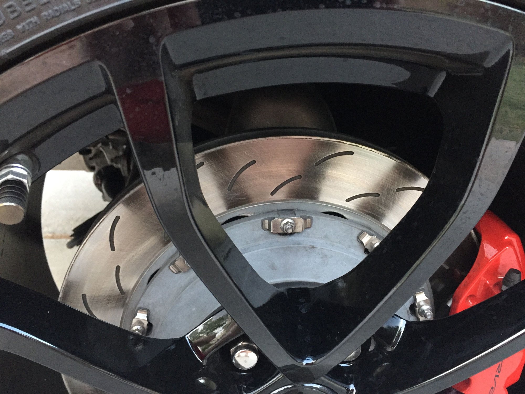

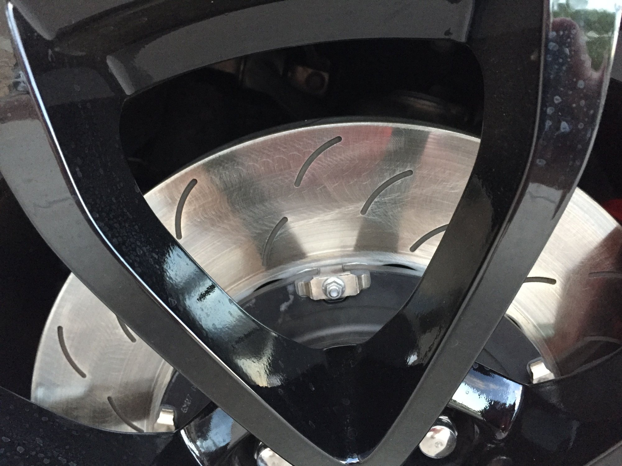

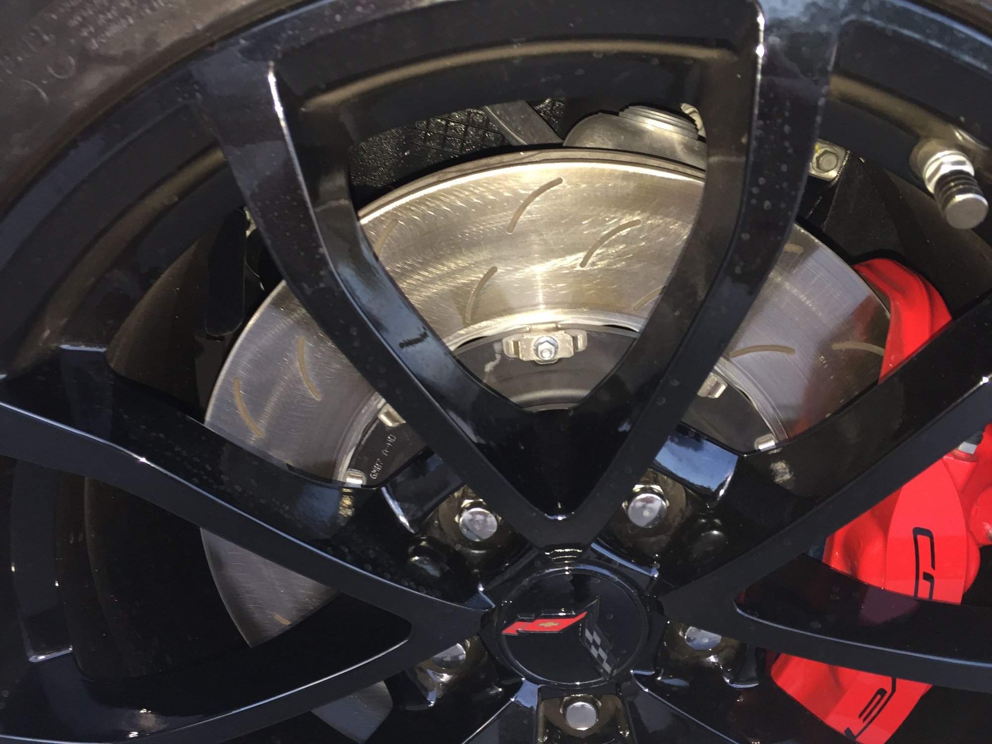

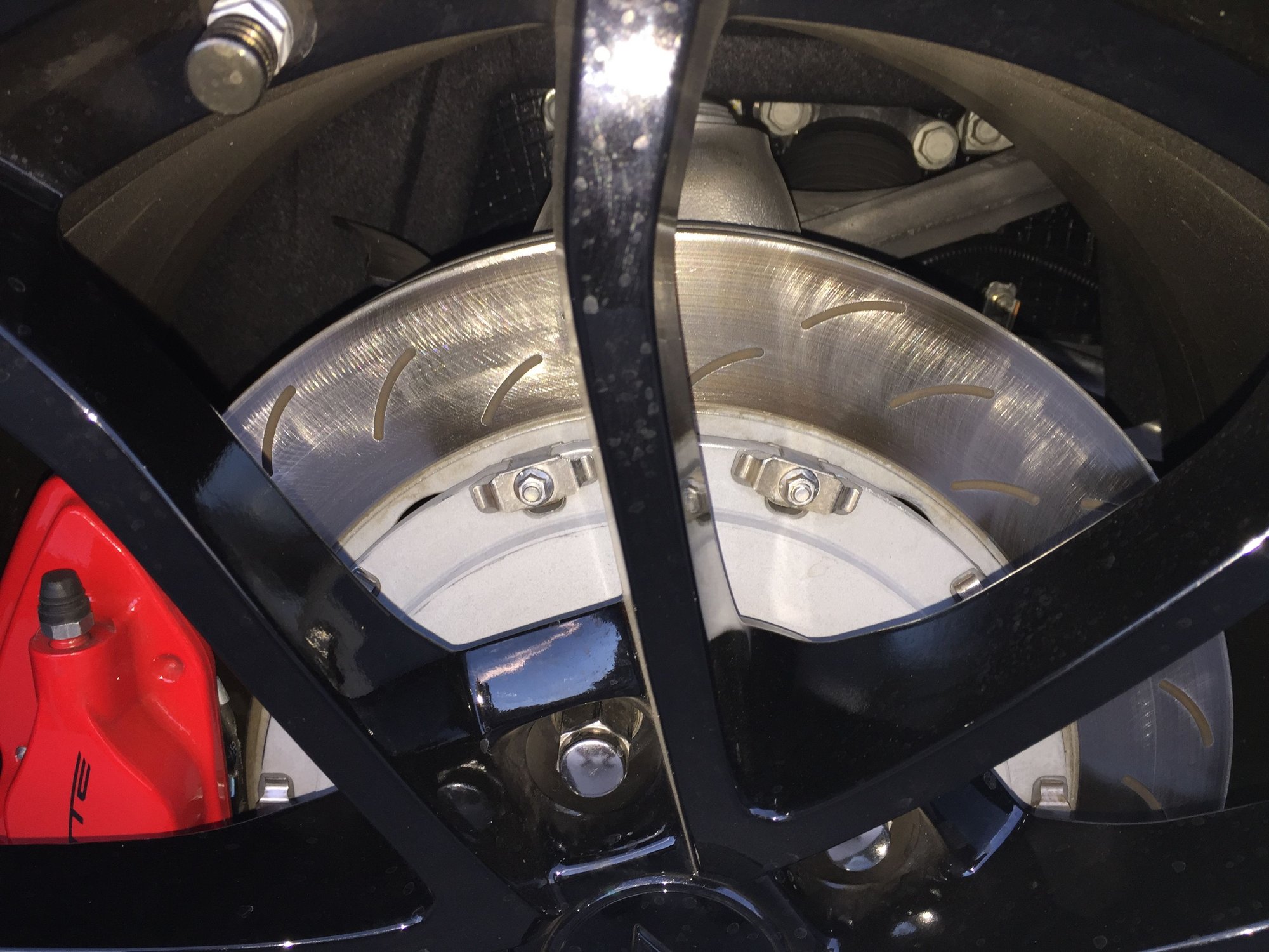

So I had the Powerstop pads installed today, along with the 4 wheel alignment.
I requested that the rotors not be cut but simply cleaned and roughed up sufficiently to seat the pads. They did as I asked and I immediately took it out on the road to perform the bedding process as most of you have suggested. It's easy to get it up to 60 and brake hard down to 25 in Phoenix since everyone drives at least 60 on the surface streets here. I'm pretty sure I did the process correctly.
When I got home I looked at the rotors and this is what they looked like. Can someone tell me if this is normal (as a result of the rouging up process) or should they look smoother? And will they smooth out over time with more braking and wear? Keep in mind, this is after I bedded them.

Had to load them individually for some reason. Ignore the water spots on the wheels. The dealer "courtesy" wash isn't very detailed. Also, while I only put about 20 miles on it so far, there is much less dust but there is some dust. And I know the tech test drove the car adequately after the install because he drove it 10 miles. I plan to have a discussion with the dealer tomorrow about that and the lousy courtesy wash.

Looks like they used some kind of air tool too clean the rotors we just used 400 sandpaper. Our rotors dont look like that ours has a very even finish.
