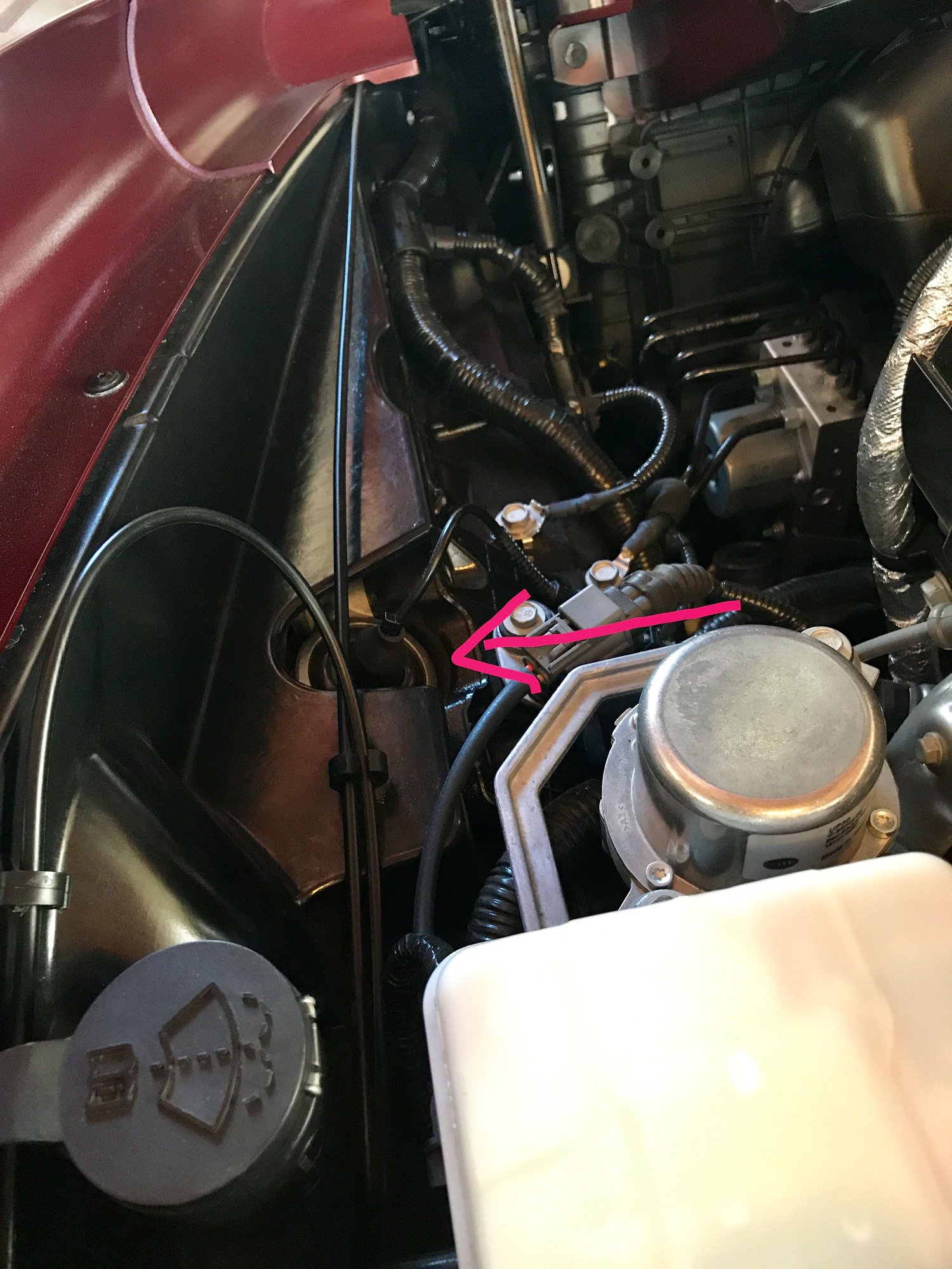

If you can get under the hood, magnetic ride cars have this wire that runs into the engine bay from the top of the shocks.

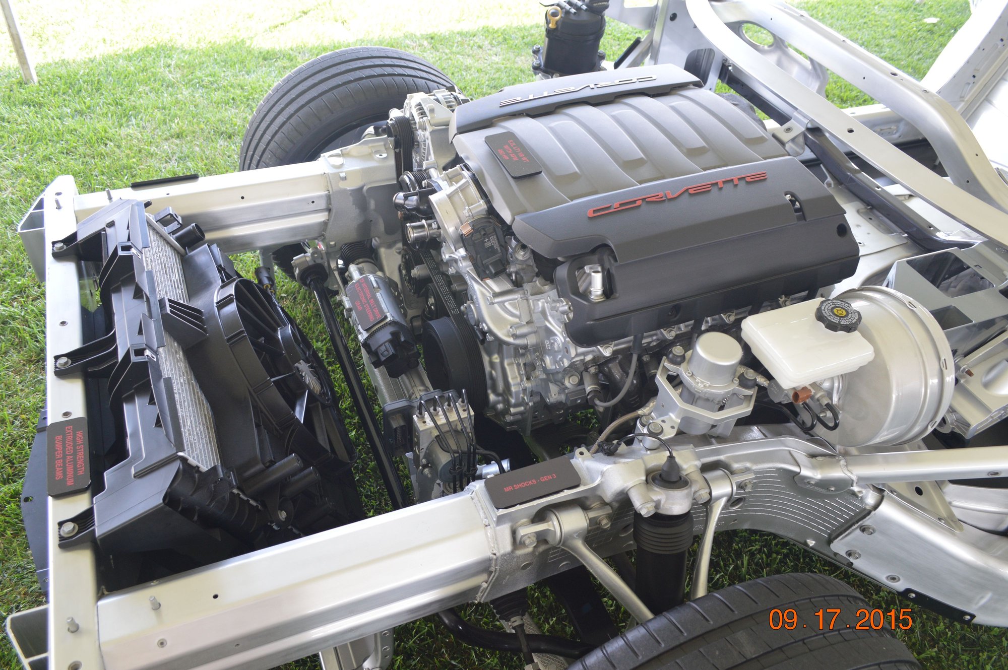

Standard shocks yellow, mag ride FE4 shocks black with cable coming out of the top.
FE4 shock shown
Not sure where I got white shocks from haha. I'm currently at the "search the country for a new car" with the possibility of my '07 being totaled.
Looking for 2/3LT, Z51, mag ride, and active exhaust in manual. Sometimes they don't have good descriptions. Trim is easy thanks to climate controls, Z51 is probable with slotted rotors, but it seems it's next to impossible to visually ID FE4 from stock pics.
