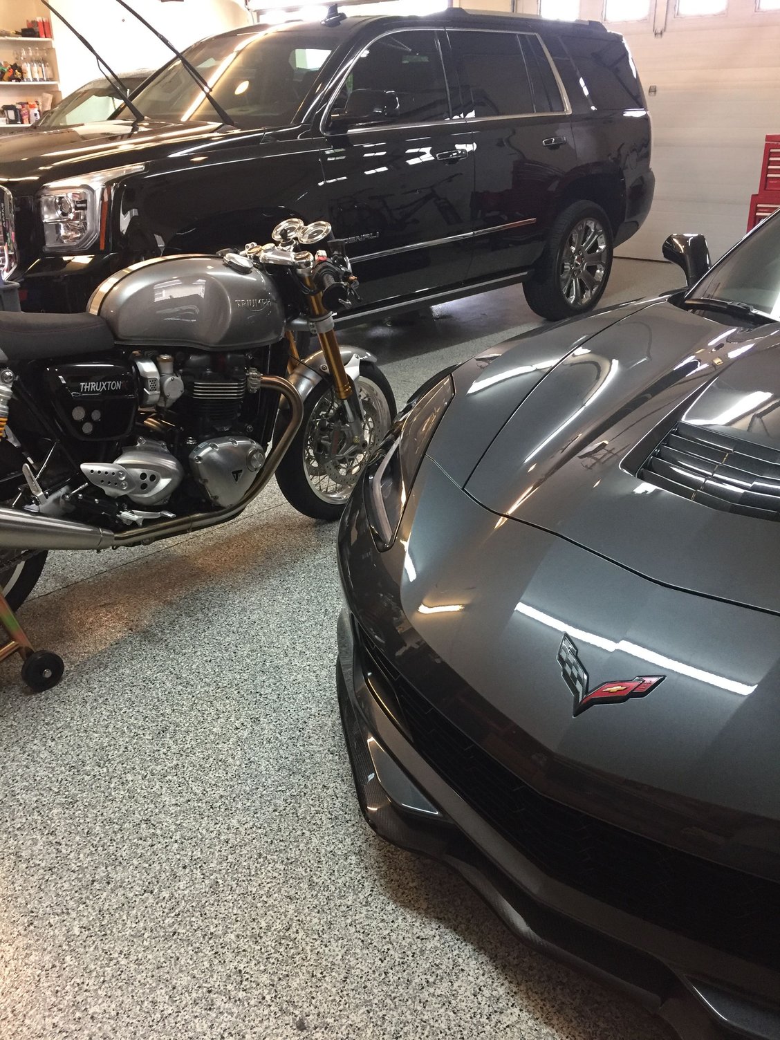

Like anything paint related the prep is the most important step!
I went with the wolfgang ubber ceramic and am very happy with it, even had enough left from the kit to do my 16 Yukon Denali.
The ceramic is easier than waxing and the bugs and junk come off really easy.
$500 is a good deal btw
Took me 5 hours to finish my grand sport.
1. Wash
2. Deionize the contaminants out iron x works
3. Wash with clay bar mitt huge time saver if your car is fairly new needing little correction.
4. Wax any scratches swirl marks out I used zaino
5. Clean with the Wolfgang prep spray and wipe down
6. Ceramic coat
I use a foam canon and two bucket method on every vehicle I own.
Ceramic coated grand sport, Yukon and thruxton😀
