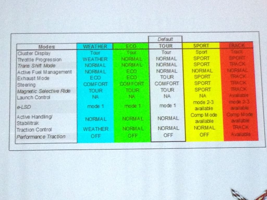

What does change is the fly-by-wire throttle response, steering stiffness (not ratio just amount of assist,) traction control settings, and if you have NPP the rpm the exhaust valves open.
When below 45 F I always used weather setting in my 2014 Z51 and will in my new Grand Sport. With the reduced tire traction it puts the "nannies" in sooner.
There is a table in the Owner's Manual that defines what changes with each setting.

No changes take place suspension-wise w/o MSRC. It does change the displays, throttle mapping, steering, and NPP flap position (if equipped).
