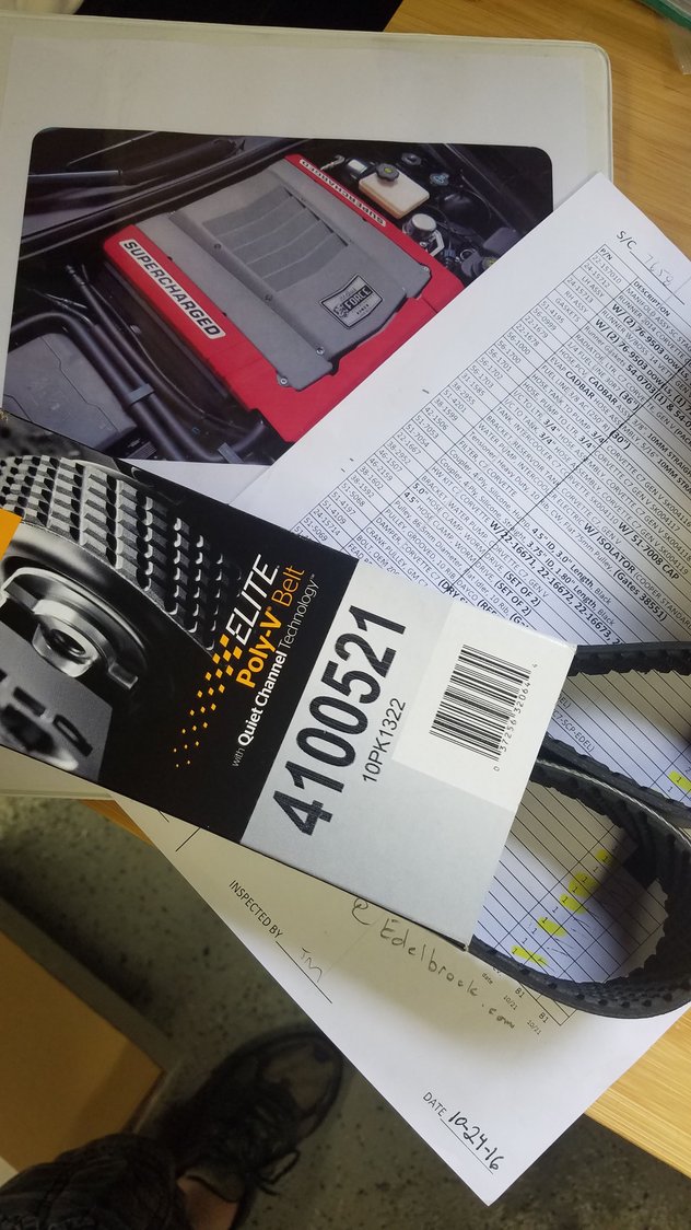

The belt that came with my Edelbrock is a Continental Elite Poly-V. The numbers on the package are 4100521 and 10PK1322.
