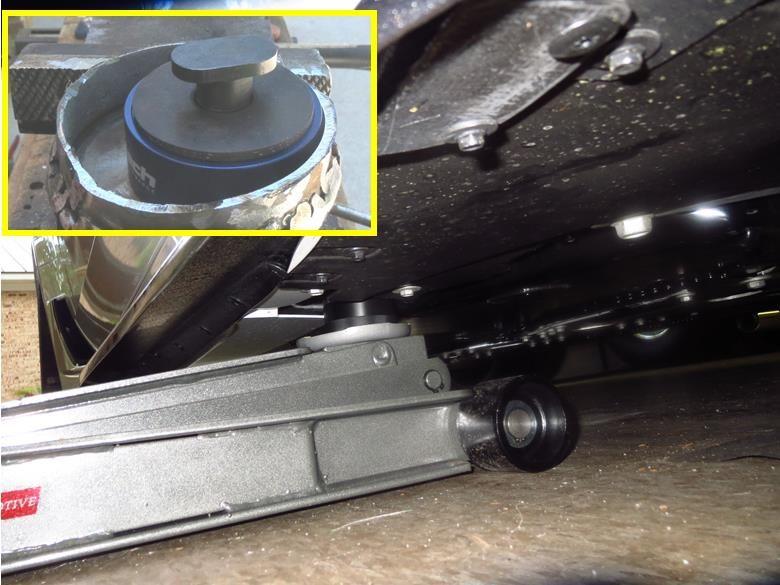

Interesting info. I had two low profile HF hydraulic jacks and one had a limited lift height and only a 10 inch long jack arm (pivot to saddle.) On my concrete driveway it was not moving into the car when I had to lift high, near it's maximum. In fact had it slip off the jack pad so bought the HF long reach jack.
However to get a very low minimum height specification the jack saddle is so shallow that it does not capture the jack pad. At 95 pounds this heavy jack, although the long arm does not have to move in as far as the small short arm jack, was not moving into the car at all, even on my tiled garage floor!
Being concerned about the saddle possibly slipping off the jack pad, I welded a 1/2 inch high rim around the saddle so it captured a 1 inch high jack pad! Assuming you don't want to do that, I would suggest buying a lighter weight jack with a jack arm of around 15 inches.
I welded a 1/2 inch rim around the circumference of the saddle to capture a 1 inch high jack pad! Works great.

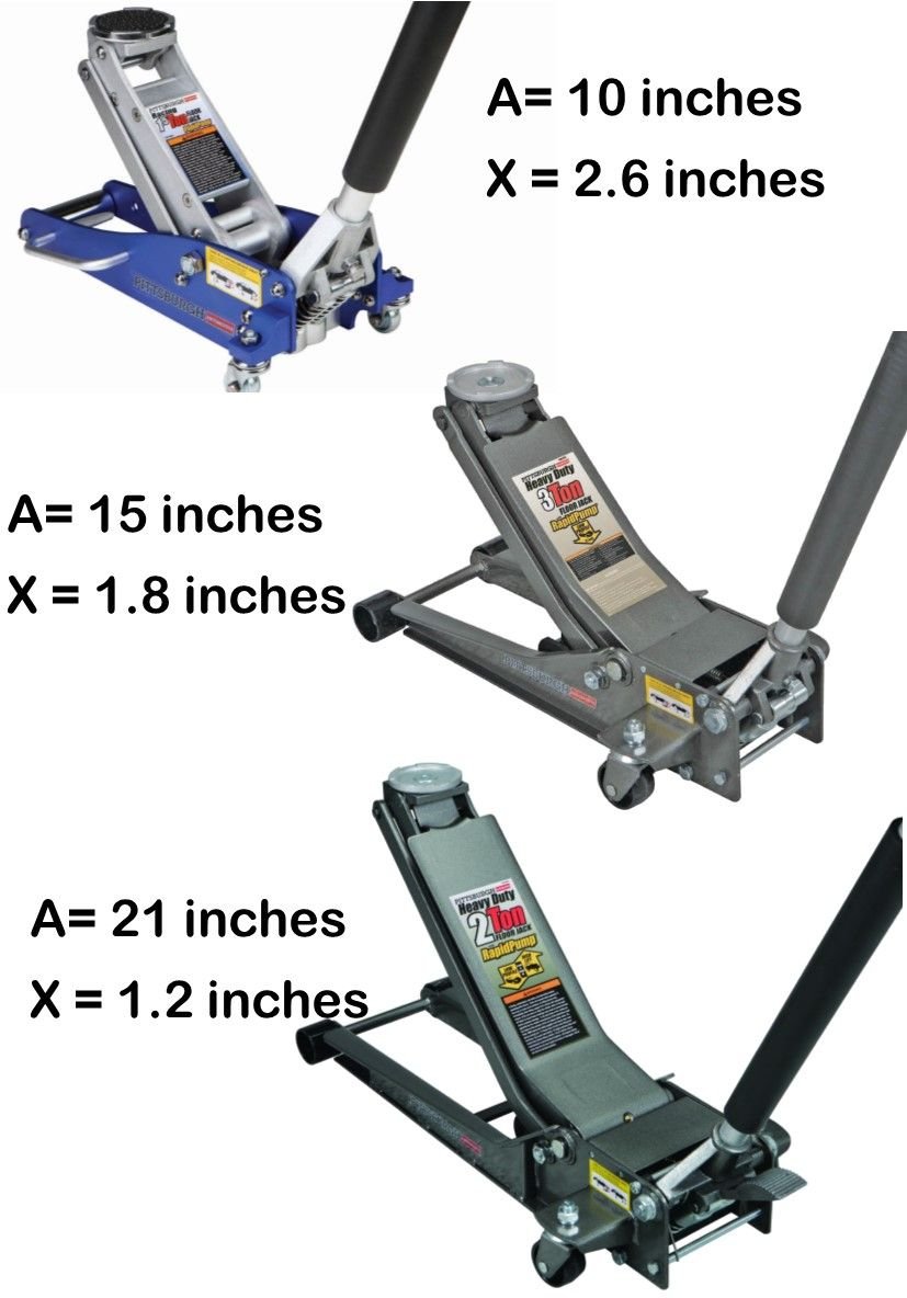

Note, "A" is the length of the jack arm from pivot to saddle. "X" is how far the jack must move into the car to keep the jack saddle centered under the jack pad; all for a fixed lift height I selected to make the calculations. I picked X as the max height obtainable with my short arm jack. The long arm jack looked to be the best choice until I found it's 95 pound weight made it difficult to move into the car! Note the higher you lift, the more the jack MUST move into the car to keep the jack saddle centered under the jack pad.

Jerry's notes on the saddle movement issue is something I watch for but will do so more closely in the future, as I never did any calculations. I always spot check it as it's going up and use jack stands for safety insurance as a rule, not an exception.
