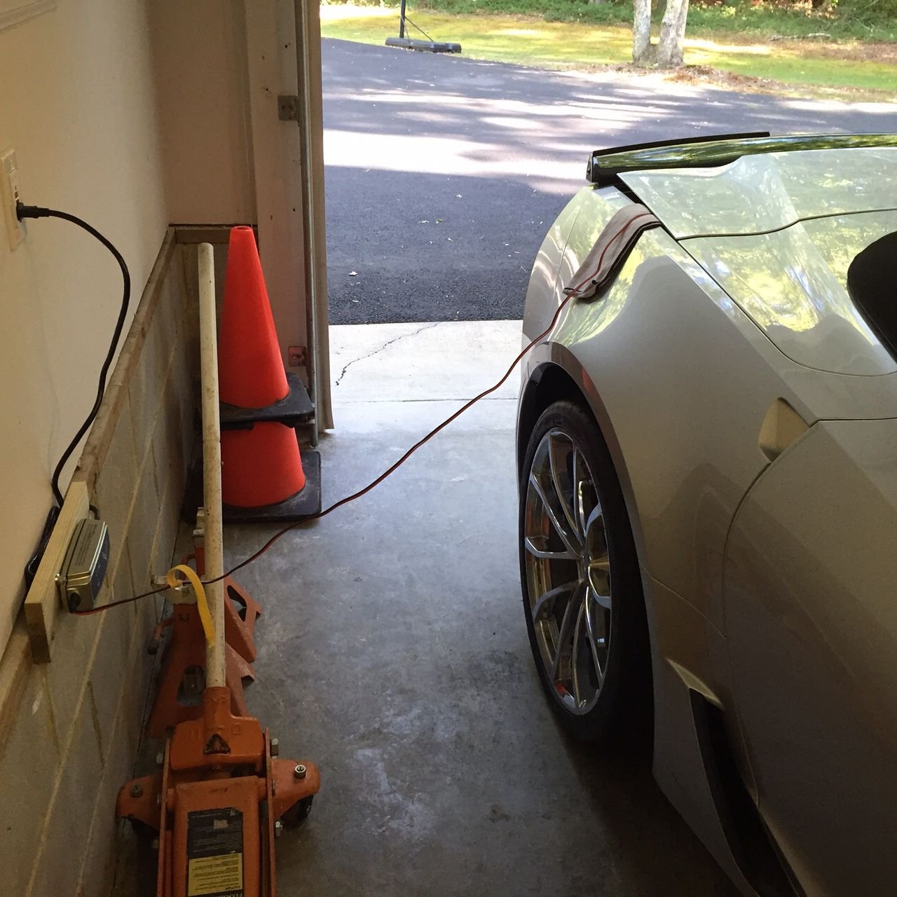

Since most of us park head-in into garage, & most electrical outlets are at inside wall nearer to the hood, wouldn't it better to have the always-on acc plug at the front of the car, & along with extra long power cord on the charger, there won't be a need for another extension cord & having power cord draped up the back paint & over & into the trunk / lid.

I installed an LED drop light with about 40' of retractable cord when I built the house... plugged into Garage Door Opener receptacle in the ceiling. It has a power plug on it and I plug the tender into that, charging from the trunk outlet with the thin cable going through closed trunk.....careful to not scratch paint, of course.....LK

Using a long extension cord is not an issue. Battery maintainers operate at a very low amperage.
The simple answer on why it's the trunk port that's always hot is that it's directly above the battery and very easy to direct wire, which it is. One of the consequences of wiring the console 12v port always hot is that owners have a tendency to leave devices plugged in there, which can and did run a lot of batteries down quickly.
It used to be common on older vehicles, but manufacturers don't usually do that anymore. That, no doubt, saves them a lot of money on roadside assistance service calls, and probably reduces customer ill-will even though dead batteries usually are the fault of the customer.
