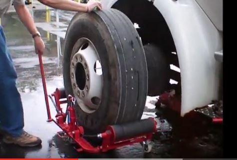

There have been posts about wheel hub and stud extenders, but just wanted to mention again that the tire dollies used to lift cars by the tires to move the car also work well to position the wheel for installation. They can be used to lift the tire/wheel and also allow the tire to be rolled to line up the studs.
The advantage of the commercial model is that the dolly can be adjusted to where the tire is much closer to the ground.

The first commercial item is a true car dolly though, right? The kind that lifts the car by the tire and when using 4 you can push the whole car around.

That is correct. You would need 4 to lift a car, but you can buy them individually. Forgot to mention that they come in different widths, so be sure to get on that will handle a 12" wide tire if you plan to use it for the Corvette.

Someone pointed out that even the 12" wide model will not work on Z06 tires since 335's are over 13 inches.
There are other brands that make a wider model. Look up GoJak. They make one for 20 inch wide tires.
They start to get expensive when you go up in width and weight capacity.

Be careful about buying from HF. Might work alright just for tires, but I read that the wheels don't have bearings, and when used as intended to move car, they would not roll.

Hmmmm They do make one (see first photo), unless you are talking about an adapter that works on a floor jack.
There are commercial jacks that are intended to lift and remove wheels and tires, especially like the dual wheels on 18 wheelers. The one Rich made still requires a jack with a removable cradle.

Looks like it would work well, plus it looks like it would not be limited in the width of the tire it can handle since it is open ended. It may be limited in the size of the tires it can handle since the space between rollers is fixed, which makes how far off the ground the tire sets non-adjustable.
Personally, I would prefer one without the tall handle to get in the way. Also I like having four wheels so you don't have to lift up on it to roll it. I like the tire dolly because you can vary the width between the rollers to get the tire the height you want it.

I wanted to add that the GoJak model for 20 inch tires shown above is the only one I have seen that has dual rollers with bearings which would make it much easier to roll the tire than other models.
