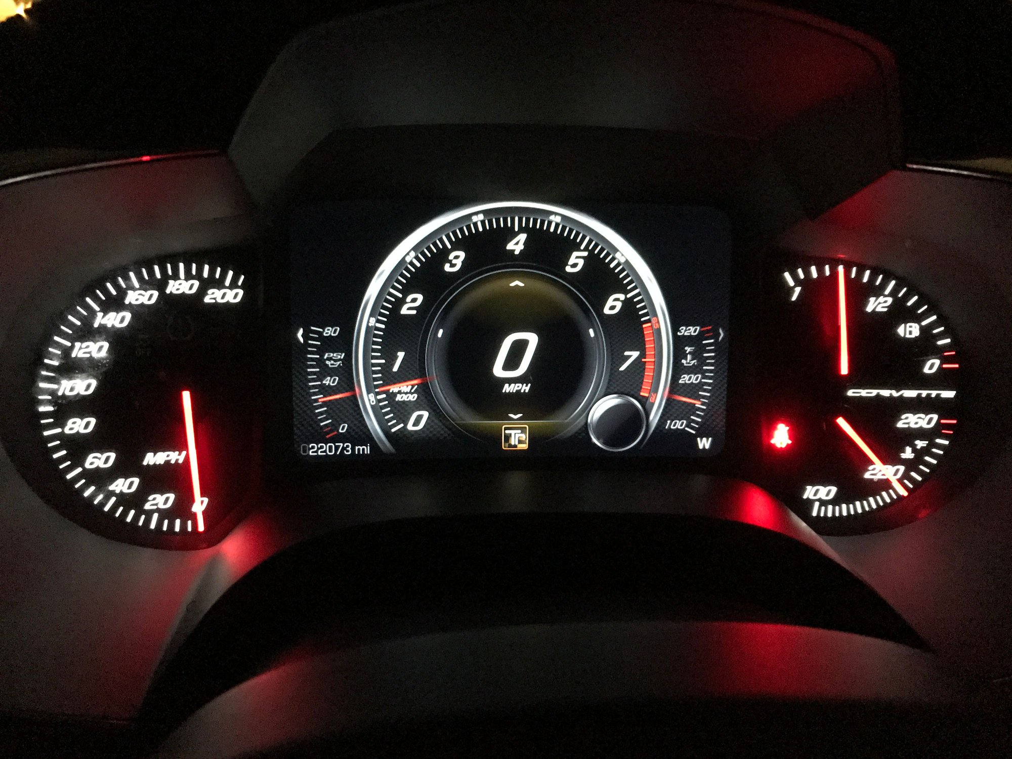

Old Sep 4, 2017 | 11:36 AM
LOUCFUR's Avatar
LOUCFUR
Joined: Nov 2013
Posts: 65
Old Sep 4, 2017 | 11:43 AM
AmmoVet's Avatar
AmmoVet
Joined: Dec 2004
Posts: 3,244
Likes: 562
From: Margaritaville Daytona
Something's wrong, that is not the normal TRACK dash you have displayed!
Old Sep 4, 2017 | 12:07 PM
Foosh's Avatar
Foosh
Posts: 25,583
Likes: 16,942
I think he has the DIC locked in Sport display mode. Hit the left arrow on the right side of the wheel, scroll down to settings, and link the display back to drive mode, so that you have the Track display when you select Track.
The other thing that's weird about that display is I don't see a DSC warning light.

I now have a '17 Z06 but I remember when I bought my '14 Z51 in October 2013 that PTM did not work. There was a software update that fixed the problem. I wonder if this update has never been done on your '14?
Old Sep 4, 2017 | 12:12 PM
Foosh's Avatar
Foosh
Posts: 25,583
Likes: 16,942
Z51,
Interesting, and first time I've heard that. I also have a '14, but it was one of the last built in 7/14, so it would have had the update you're referring to. That also might explain why he has no DSC warning light.
However, first things first, I'd like to view the normal Track display to see if [PTM] "Wet" shows up in the center display after pressing the button twice.
