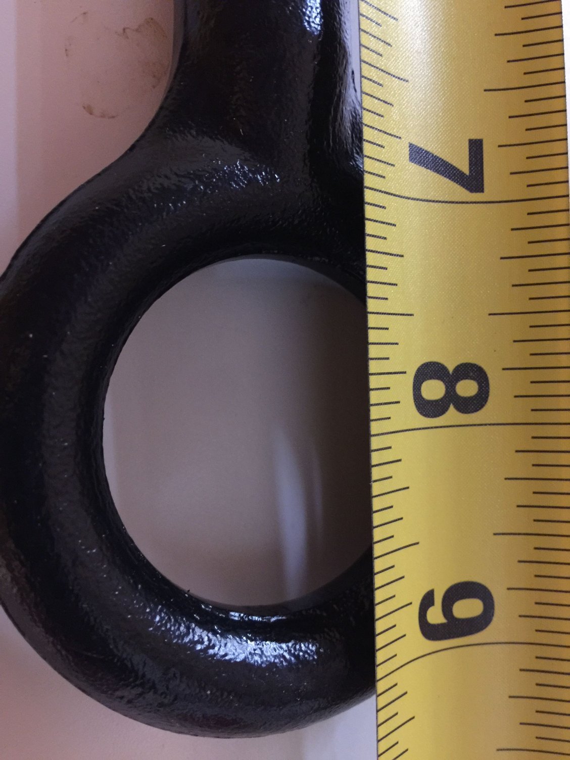

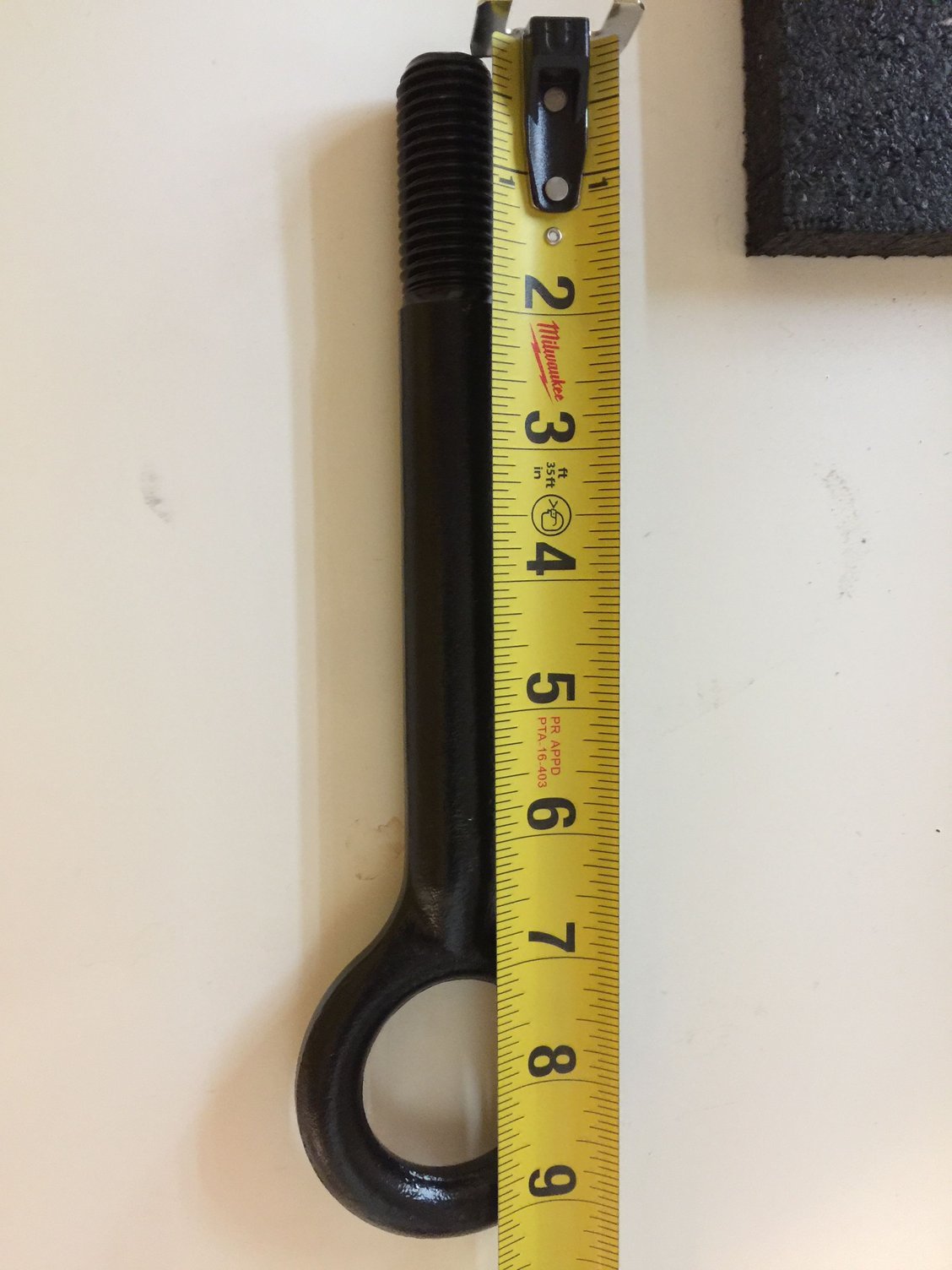

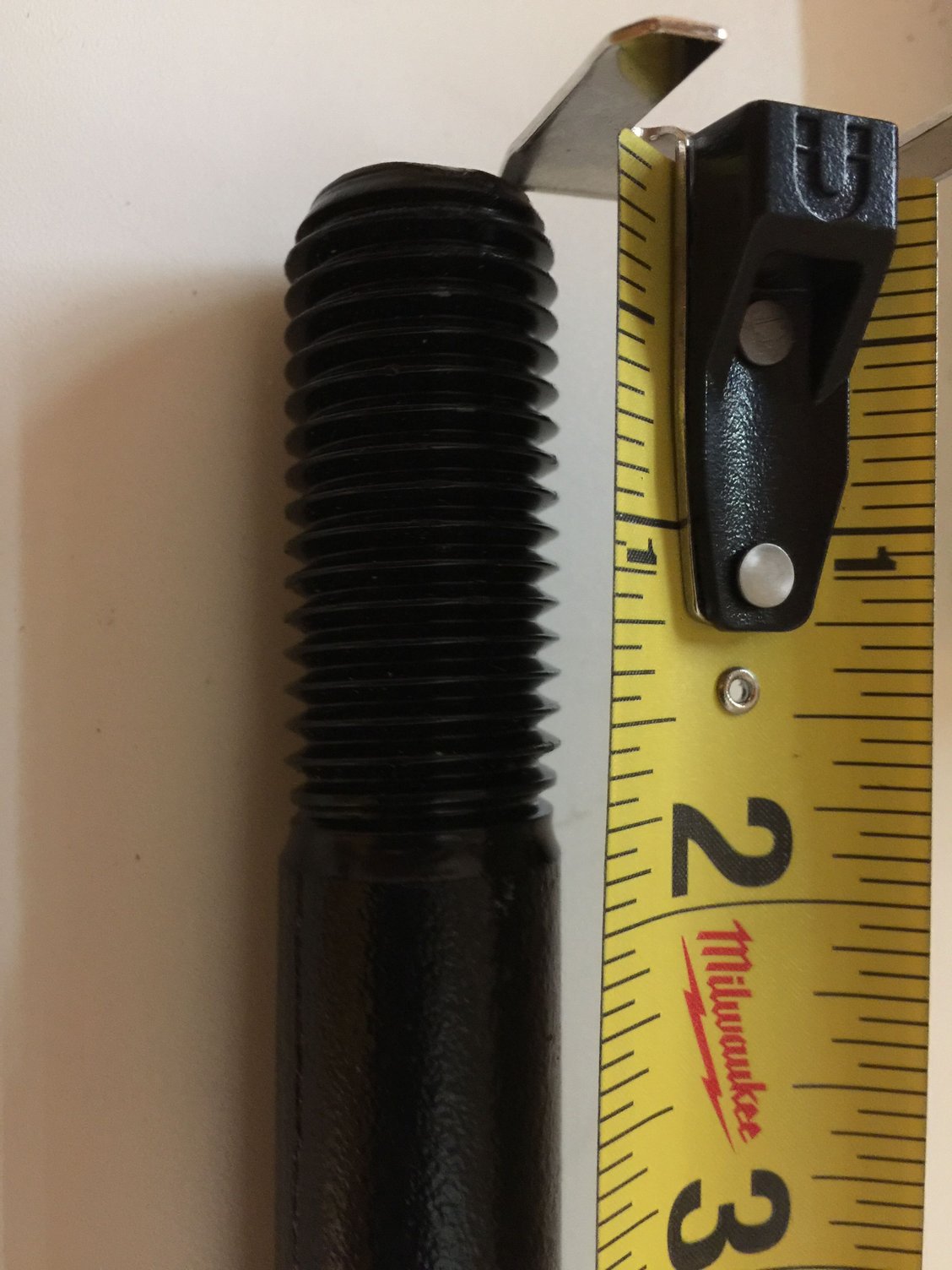

The GM tow hooks are the same length for front and back. Let me go dig one up and post a pic...

They don't work well for getting towed as they are not centered on the car so many tow truck operators will not use them. While the winch on the truck is usually centered, hooking to the tow hook will pull the car off-center and drag it at an angle onto the flatbed. I have seen two C7s that needed to be placed on a flatbed and each time the operator refused to use the tow hooks. You might be better served with a set of hooks that you can secure in the holes for your front jacking pucks and a good strap to connect them so the tow truck can pull you straight and level onto the bed. While the operator of the truck should have this stuff already, might be better to be safe than sorry.
As I have mentioned, I purchased a tow hook just because I hate having an open slot where a tool should be but I don't expect it to be of any use if I need an actual tow truck to bring it back home for me. I do not see a location for you; however, if you are out here in SoCal and close to me, I can meet you someplace and give you the one in the photo. When you order them you get two and for folks like us that are not tracking their cars, we really only need one for the tray anyway.
