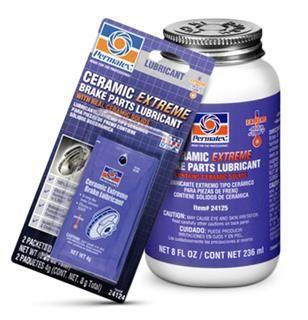

I have never had the problem but for the 3 sets of pads I have installed on C7s, one set on my 2014 Z51 and 2 on my Grand Sport, the last Carbotech 1521s, I have used a high temp ceramic brake Lub material on the backs of all pads. On the 2014 I used the GM recommended lub on the sides where they say it should be applied. In the last two installs on my Grand Sport used it both on the sides and back. Have not heard a sound. The 2014 I had for ~3 years and never a peep! I would use this high temp brake lub. It's good to 2800F! Axle grease is not! C7 rotors don't float but the issue is the same!

Thanks, I appreciate the research on your part. When I replaced my pads I cleaned everything very thoroughly and applied Permatex to the back and sides of the new pads. So far the pads operate and sound just fine. Thanks again!
