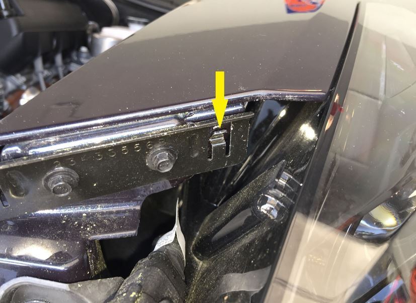

The clips I was referring to are the plastic ones on the facia top, under the hoodline. They have openings to stick a pry tool or screw driver in. But yes, in order to pull the facia, unbolt everything first, then start on the hoodline by the headlights and gently pull up. (You obviously need some force but I say gently because I know a guy who spidered his paint by using his superhuman strength). If it feels too hard to pull up, stop and look. You probably missed a bolt.

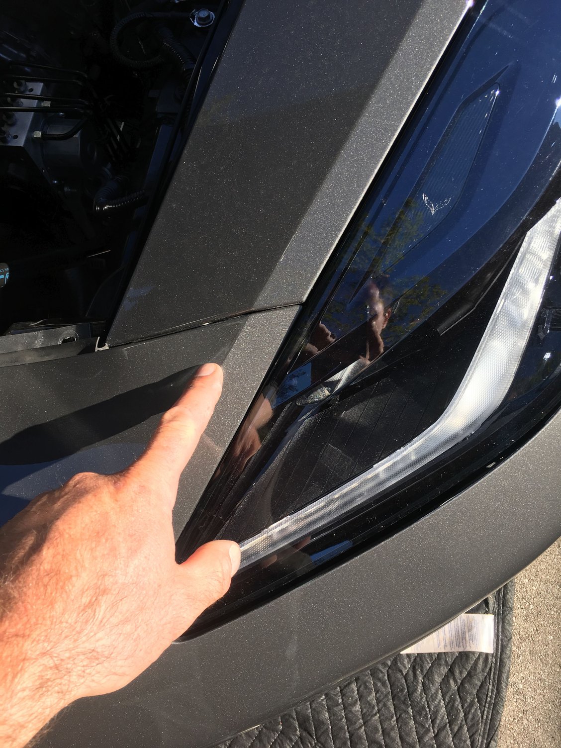

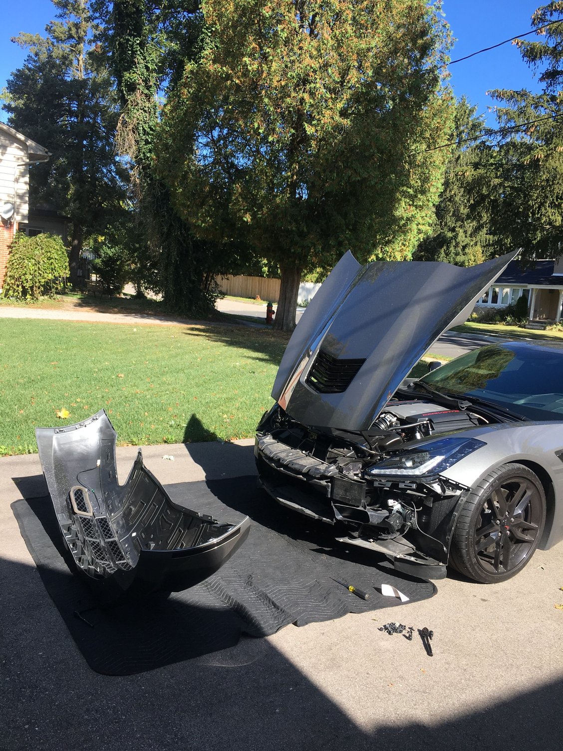

Guys,
Everything else is nice and loose and came off very easy. I'm having issues with this section on BOTH sides. Pull straight up?

Yes, straight up. Here are a couple pics to help you visualize

Got it!
Thanks man

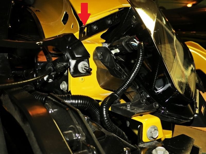

Here are photos of the actual clips...
