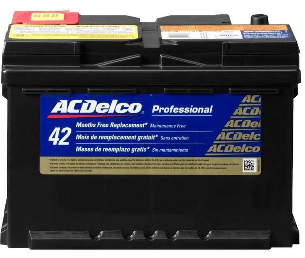

The Chevy parts dept says the ACDelco gold series battery is a 42 month battery (not 72) and is free replacement for 42 months
The first AC Delco Professional grade battery I bought for my C5 was 84 month with 50 month free replacement, and they have been changing the warranties over the years.
I thought the last one I bought for my Stingray was only a 40 month free replacement, but looks like you are right that they are now 42 month...says in on the battery...with no pro-rated replacement period.
Thanks for pointing that out..
Delco still has the warranty information on the 7 year batteries on their website, but I guess they are no longer available..

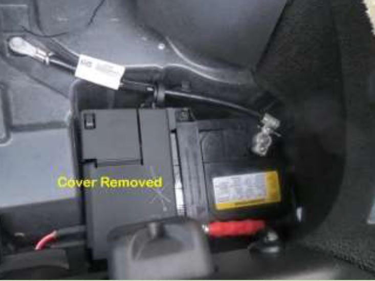

No need to replace the battery if it isn't broken or stops holding a charge. If you are really worried, have it checked every few months at an auto store. They should check it for free.
In a C7, not so easy to access to perform a check! If you haven't accessed the battery yourself, suggest you do as the odds of an "auto store" doing it (if they will) and ripping the carpet are high! If you have an AAA person jump your car they surly will!
I have found to make it easier I remove the bottom clips from the passenger plastic wheel well cover. (Can do with my fingers or could use a plastic trim tool, etc.) That is not covered in the Owner's Manual. TEXHAWKO goes further and removes all the fasteners and the cover (not as easy and requires tools!)
The carpet that is under the plastic wheel well cover is not bound. If you don't at least remove the bottom clips and pull the plastic housing away, good chance of ripping that carpet corner as you pull it out! Several posts were a dealer caused the rip!
After replacing my battery with a higher quality AGM, I brought my OEM Delco back to Sears to get the $5 core exchange fee. I told the service manager the issues with removing the battery in case they get in a C7. He said, "We do not change batteries where they are not readily accessible, we recommended they go to the dealer!"
I can understand their concern, as with our Porsche Cayenne the battery was under the driver's seat. It could only be accessed with complete seat removal! Lots of wires and connectors and a special large Torx bit required!

I sometimes wonder if this was designed this way to insure the dealer got the job. There should be no way to rip the carpet when exchanging the battery.
Imagine how pleased you would be if you took it to the dealer, and they ripped the carpet anyway.
I have even thought about going ahead and cutting the carpet so that the corner can just be removed if access to the battery is needed. At least it would be straight, and much easier to deal with..
Could tape the cutout on the back, or may just use velcro to hold it in place.
It is already held in place by the rear and side trim pieces, so it would not take much.
Photo courtesy of JerryU
