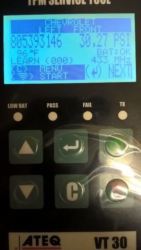

You might try manual re-learning of the sensors before you take it to have sensors replaced.
My hand held triggering device also displays what the sensor is transmitting so you can easily see if the sensor is working...
