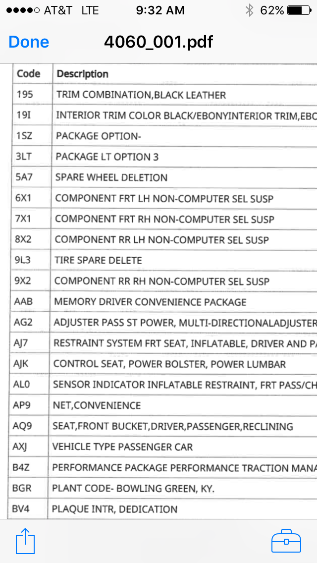

Do these build codes mean that the car does NOT have the MRC suspension??
the 6x1, 7x1, 8x2 and 9x2

Look for FE4 (mag ride). Other FE (suspension) codes are not. All of your codes are on a label near the battery.
This applies to base / Z51 only. GS and Z06 have mag ride standard.

Not sure what these mean 6x1, 7x1, 8x2 and 9x2.
But the BZ4 is Performance Track Management (PTM )and comes with FE4 = MSRC w/ Z51.
FE4 Magnetic Selective Ride Control
Includes (B4Z) Performance Traction Management.
http://eogld.cloud.gm.com/NASApp/dom...page=6&butID=3
if you look look at the list I posted a SS of; on the Left is a alpha numeric code. That is where it shows a description next to the code

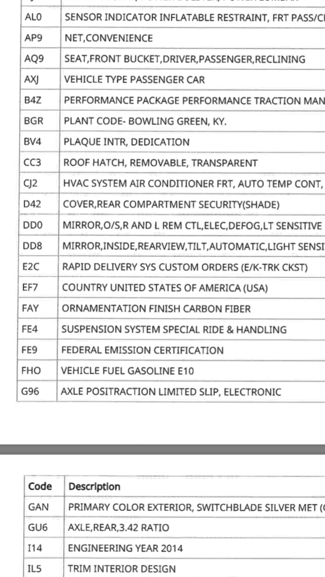

I think this is the MSRC....
Old Oct 9, 2017 | 11:57 AM
Foosh's Avatar
Foosh
Posts: 25,583
Likes: 16,942
Yes, it does have MSRC and Performance Traction Management (PTM). FE4 is the Z51 and GS version of MSRC. FE2 is the base car version of MSRC without PTM. FE6/7 is the Z06 version. FE1 is no MSRC.
