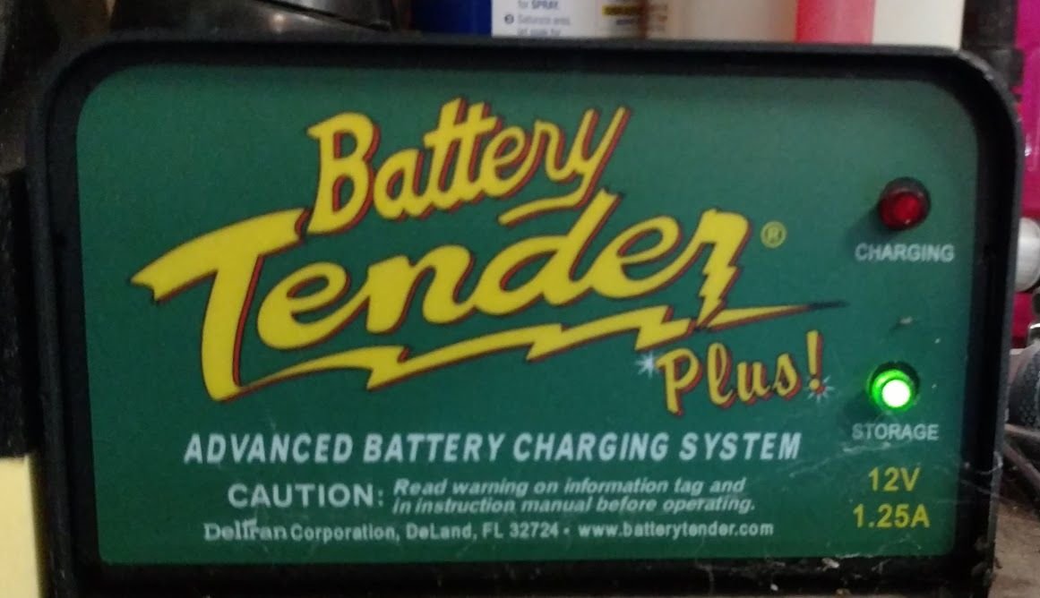

Get a Deltran Battery Tender !!! I have been using them since 1989 and have never had a problem
