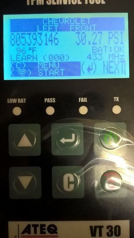

The car display does just show the color coding for tire temperatures but the sensors do transmit actual temperatures. If the software allowed it, the temp. could be displayed on the dash.
Here is my hand tire pressure sensor reading tool display.
Here is what FROZEN looks like..
