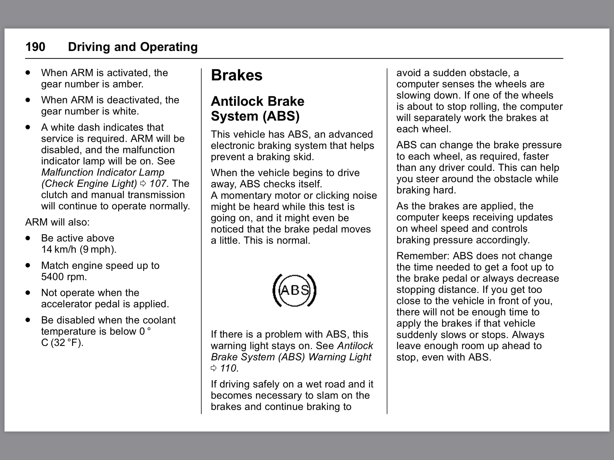

OP, pay particular attention to the next-to-last bullet in the owner's manual description. If your foot is even resting on the throttle, you may be putting enough pressure on it for it to not function properly. Lift your foot completely when using ARM-aided downshifts.

Yeah, it should be that simple, but in an attempt to understand why people so many people were saying it didn't work well, I experimented w/ leaving my foot resting on the throttle. It does not work nearly as well or as consistently when you do that. It's 100% w/ foot fully lifted.
I think many people leave their foot resting on the throttle, and are subconsciously/inadvertently inputting a little throttle during downshifts. If so they are right, it isn't working by engineering design per the manual. I noticed that when I first took delivery I was programmed to manually rev-match, and by habit, kept my foot on the throttle. I had to break that habit, and when I did I couldn't believe how good ARM was.
ARM really isn't needed in a 7-6, 6-5, 5-4 downshift. It's 4-3, and 3-2 where rev-matching (either ARM or manual) is most useful to avoid chassis upset. Those are the larger gears with more mass and inertia.
Foosh,
So you keep your foot momentarily off the throttle until the rev match kicks in, then put your foot back on to accelerate into the upshift or downshift? Can't even remember what I do with my 4 speeds because it is second nature. Does downshifting regularly coming to a stop cause any wear on the trans or is it better to coast in neutral?

Yes, you just completely lift foot off throttle momentarily while downshifting and smoothly release the clutch, then back on throttle as necessary.
