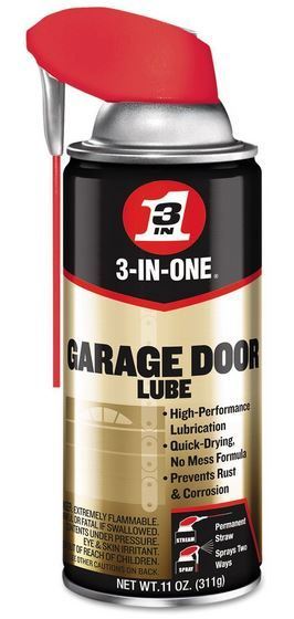

Try the white lube spray, like they sell for lubricating garage door hinges.. Dries so it does not attract dirt.

Had same problem. WD40 didn't do it. The garage door lube did the trick. Thanks!!

Thanks I have to go to Lowe's today and will buy some.
