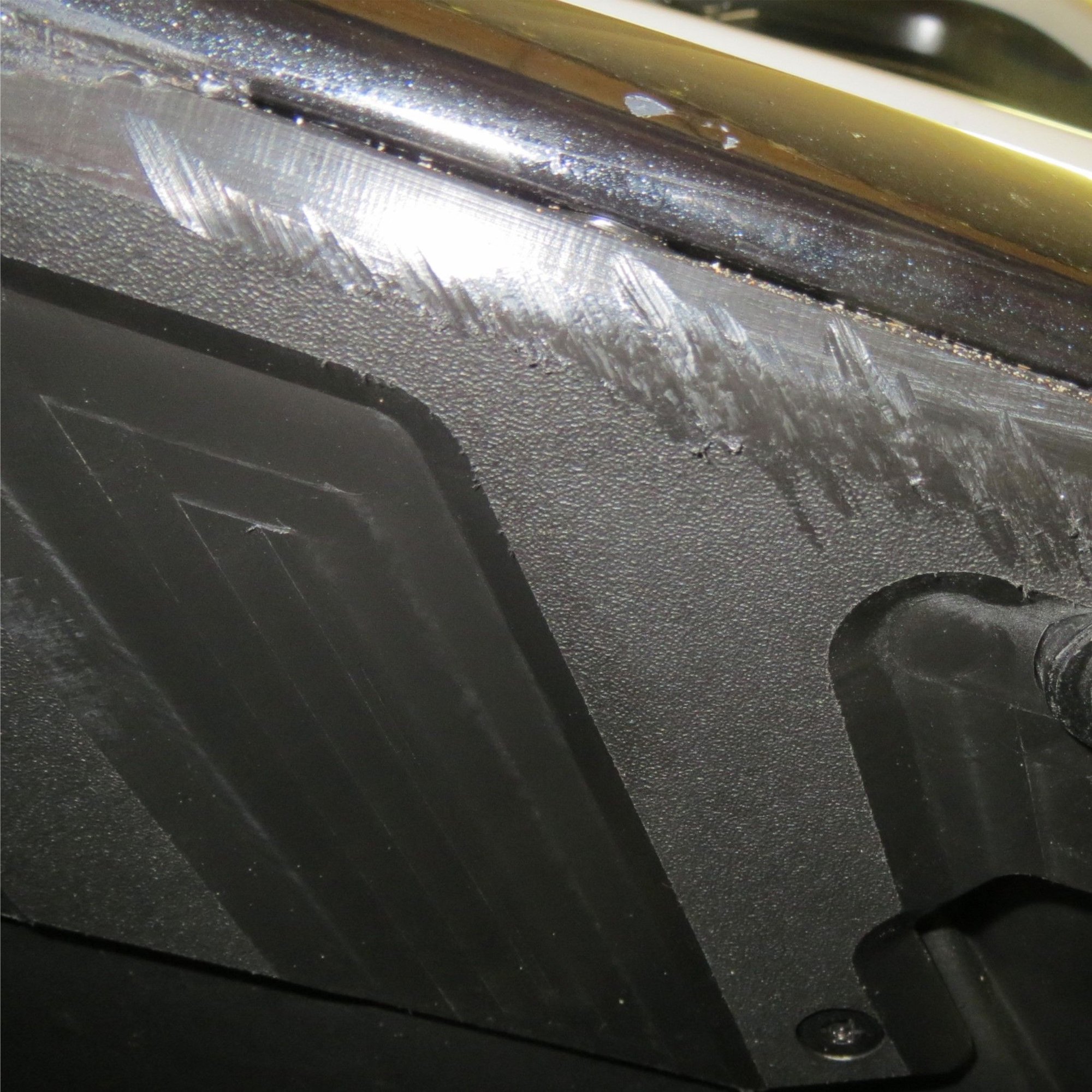

Hmm, must not go in and out some of the driveways I do! Not only do I scrape my side air dams, in my C6 scraped and dented the "skid pads" (GM calls them radiator supports but they stick down much further than needed for that function and provide the additional function as well) several times and did the same in my 2014 C7. Fortunately on my C7 had installed plastic FANG "skid pad" protectors so no damage. They are are about 1 to 1 1/2 inches higher than the air dams and made from aluminum tubing! That aluminum on payment sound makes the rubber air dam scarping sound like music!
Below is a pic of my scraped "splitter protector." I fortunately added it several weeks before I had to exit a steep driveway in town!
That is all with factory settings!
Pic of bottom of the splitter "protector" I added to my Stage 2 aero splitter on my Grand Sport. Fortunately no damage to my carbon fiber splitter.
