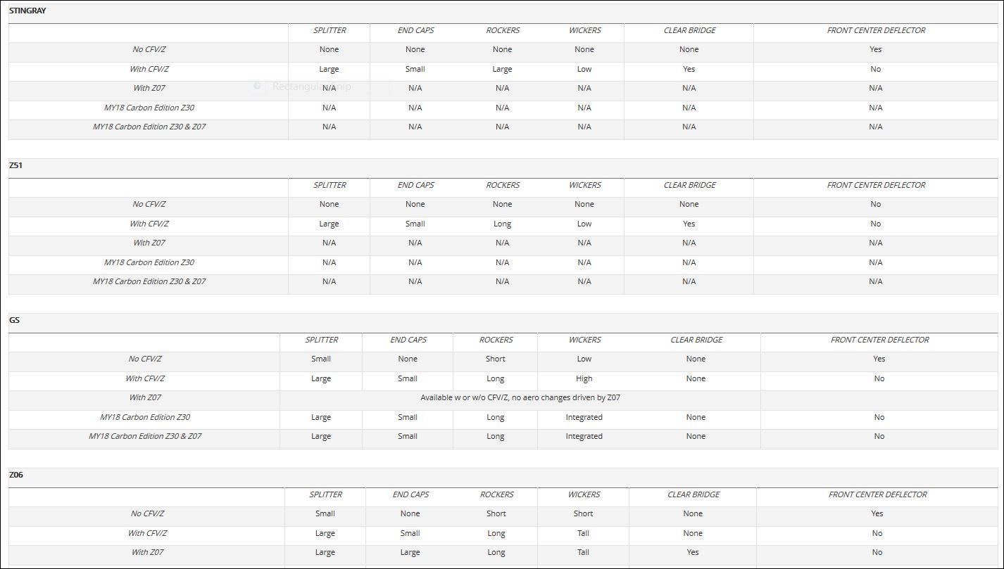

When working with aero consider this info. Front center deflector delete with the larger (CFV) splitters. If its just the smaller "poverty splitter" the center deflector remains. Graphic is from GM #16-NA-330 TSB. Good luck and let us know the outcome.

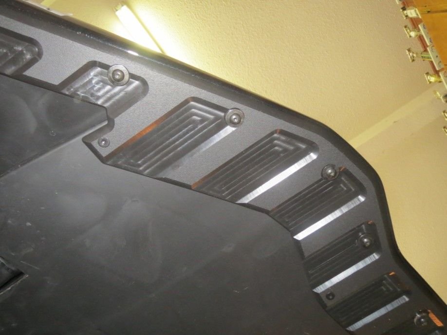

So I invested in a Scrape Armor protector. About a month after the install I got caught in a situation where I had to leave a steep driveway. Had pulled in on an angle and believe I only scrapped the side air dams. However could not back out into traffic! Glad I had added the "protector!"
Below are pics installed and after scrapping. No damage to the splitter! This is a PDF of the simple install. http://netwelding.com/Splitter_Protectors.pdf
Pricey, but worth it IMO!
"Splitter Protector" As Installed
Scraped, but No Damage to Splitter

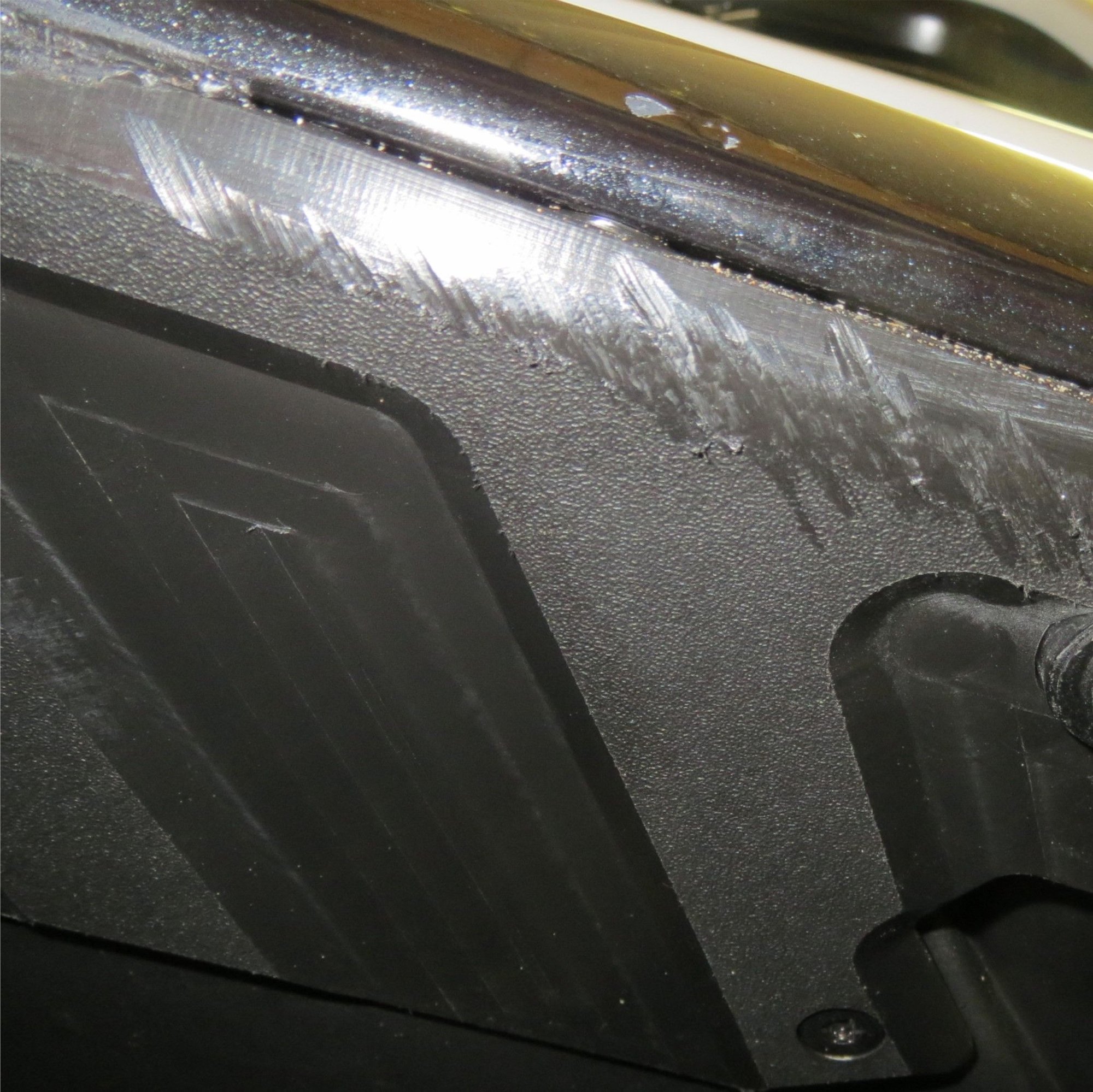

This is the splitter that came on my car, beautiful looking one, but get scratched everywhere. I don't have any idea which type is mine. Probably once that gets damaged I would replace it for the Weapon X or the RPI which seem that are higher from the ground up, or maybe no splitter at all.

From pic no Stage 2 Winglets on Splitter and no Stage 2 Spoiler Extensions. But looks like full length Side Skirts that could be Stage 2. Possibly aftermarket Splitter and Side Skirts?
IMO, only safe Splitter is NONE! Next is Poverty Splitter standard on Grand Sport and some others. Mainly because it's cheap to replace!
Although with my Stage 2 Carbon Fiber Splitter to some degree I can control where my car goes and avoid steep driveways I have less control of the many 18 wheeler tire treads on the Interstate! Hit one of those and it will destroy whatever!
