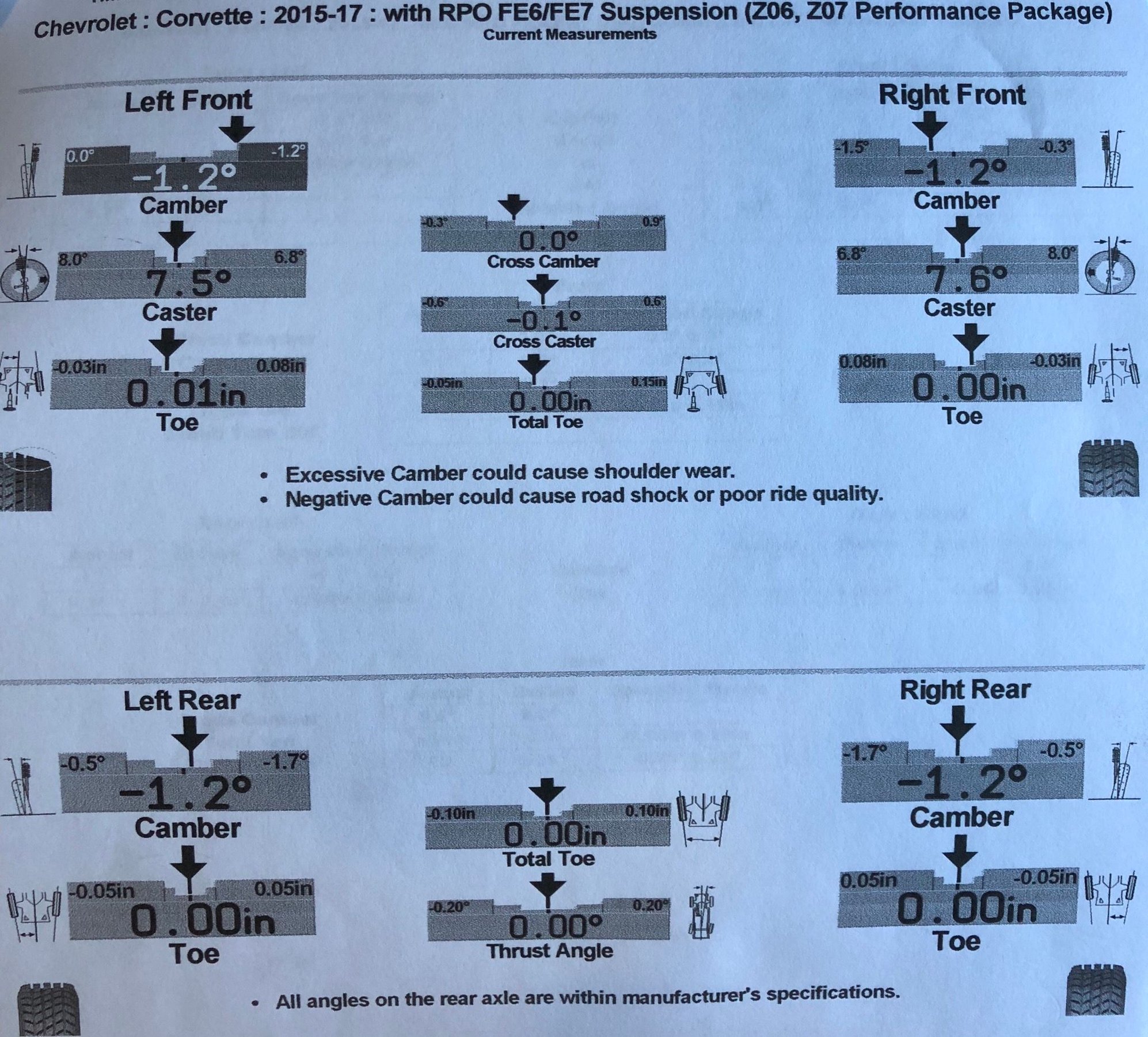

I just got my 2017 GS (NON-Z07, stock with new non-runflat Conti DWs all around) aligned at a local shop that I trust. I told them that I was getting the alignment to help with inside front tire wear.
My settings are attached for those interested. We shall see what kind of tread life I get this time — I wasn’t impressed with the stock alignment chewing through the $2k/set PSS run-flats at 12,500 miles, and the ride is much nicer now with the Contis.

I had my 17 GS re aligned and told them to use the street non aggressive specs. Also wanted a before and after printout of the alignment. You get one free alignment up to I believe 7K miles. I think this is what they told me so don't let them charge U. Good luck with it.
