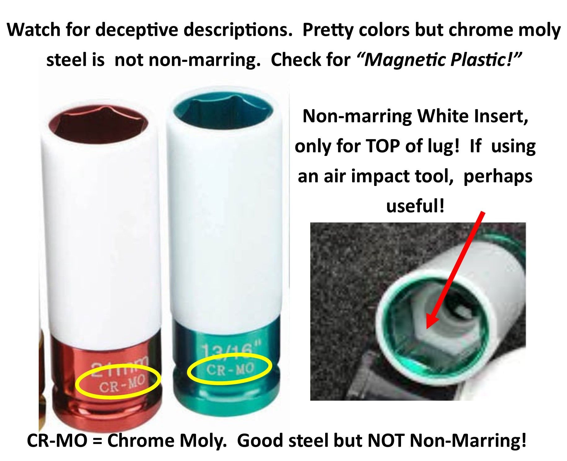

Yep, most are just that. Marketing and sometimes the descriptions are deceptive. It appears some do it purposely, IMO.
This is what I have used since my C6. It has a hard plastic 6 point socket inside and has lasted since 2007.
Never needed protection on the outside as I use a 1/2 inch breaker bar to remove them and torque wrench to install. If I did, would just wrap with electrical tape.
Plastic Lined Lug Wrench. Bought years ago, last I saw was on a Porsche accessory website.

Yes, I use impact tools to take them off as I am not going to use a hand tool. I suspect the caps will start to break loose within the next year.
Bill
FWIW, should have mentioned, the plastic lined lug nut socket I showed in post #44, which I have used for 10 years, IS NOT for use with impact wrenches.
Most of the ones that are sold by Harbor Freight and others can be and the outer plastic does help protect the wheel BUT Does Nothing for the sides on the lug nut, some do have an insert that only helps the top! Have checked with a magnet and the pretty colors are steel!

Yes, it's on the outside and there is some within the socket where the top of the nut might touch the inside of the socket. The sides that come in contact with the points of the lug are metal.
I believe there are two things that cause this issue to happen .. impact guns and 12 point sockets. Stay away from both and I think you're good with GM lugs. At least I have been so far with removing my wheels 5 or 6 times a year (HPDEs to switch pads).
p.s.- Although I bought this socket just for my C7 so I wouldn't ding my black wheels (breaker bar to remove and torque to tighten), I have used it several times for wheels on other cars with my impact with no issues.
