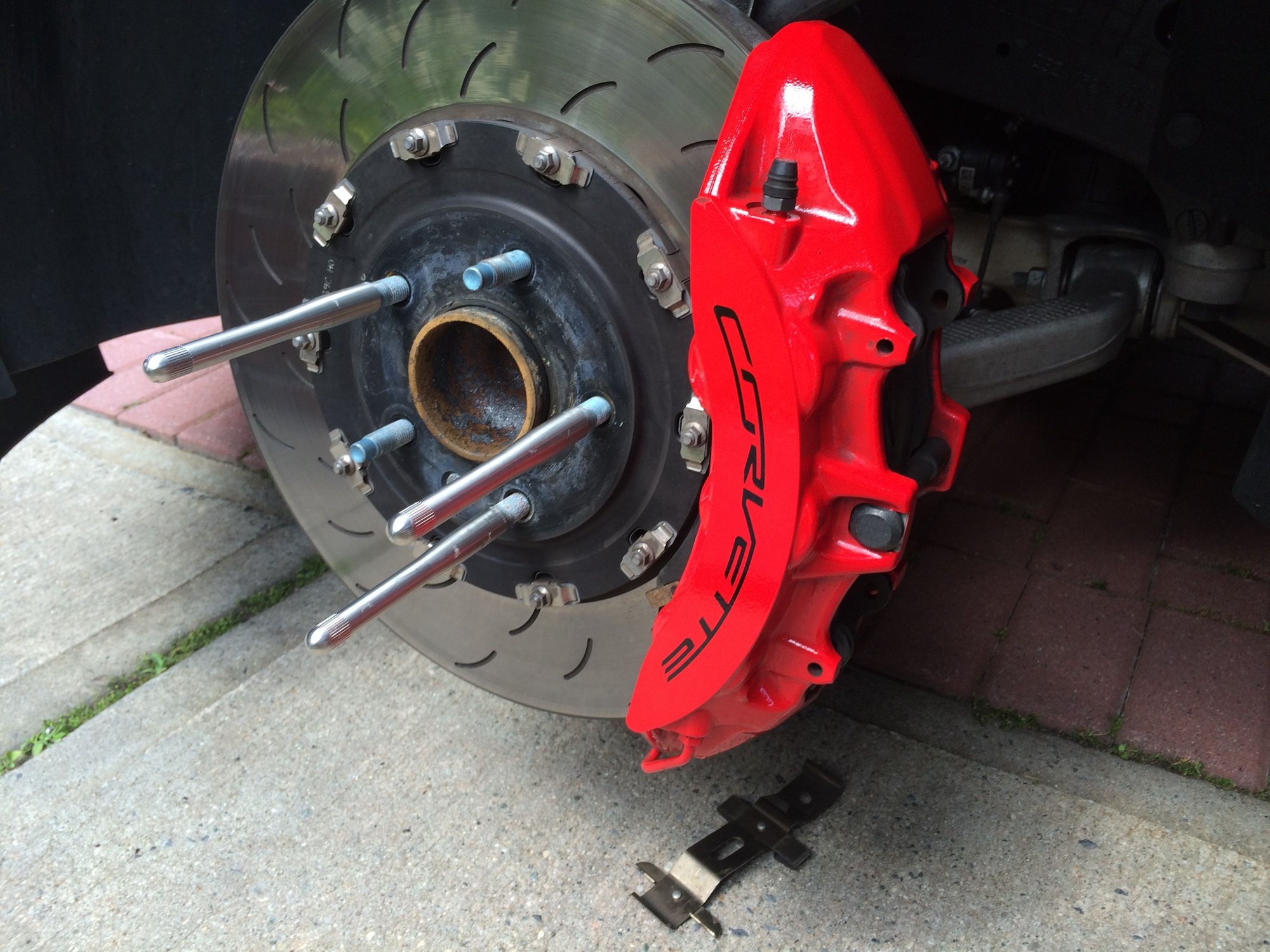

The only minor annoyance of swapping the pads was that there is not much clearance between the back of the rear caliper and the plastic brake cooling duct, which limits how much of a small hammer swing you can make, even with a short punch, to get the retainer pins to seat fully back into the caliper.
And my discs are also slightly brown/bronze tinted from the Power Stop Z26 pads. I observed the same thing when I put Akebono low dust pads on my other car.
And a tip to make it easier when installing the wheels back on : put a plastic garbage bag on the ground beneath each wheel well....that makes it easy to slide the tire into position when re-installing the heavy wheel.
I noticed the same thing. One pin on the right rear caliper didn't want to seat quite all the way in, but has not moved in 3k miles and nine months. Will try again next time I have the wheel off using a shorter punch and smaller hammer.
